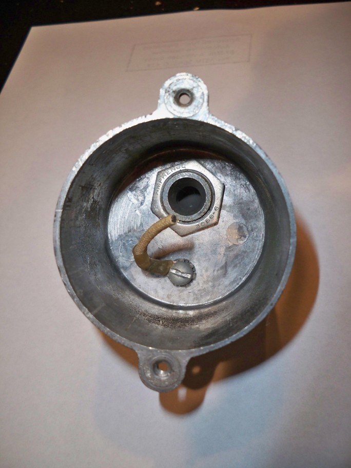

        Putting on the Slicks with shielded leads made a huge difference, though the Ercoupe cups did not shield the plugs as much as I had hoped. My P-leads do have a shield, but I would like to find a source for that shielding.
        Using ANL and squelching a bit usually removes the popping from the ignition. Something else I am going to use is a can that attaches to the back of the mag switch that is also grounded. The leads ground to the can, the switch is grounded to the can and the can is grounded. I picked one up off of Ebay a while back.

              Ralph,
              I thought I had a picture of that mag switch shield on my computer when I posted the comment above, but could not find it. Yes, I can take a picture and post it later. And the Ercoupe cups from Fresno were $47.50 each, if my memory serves me correctly.

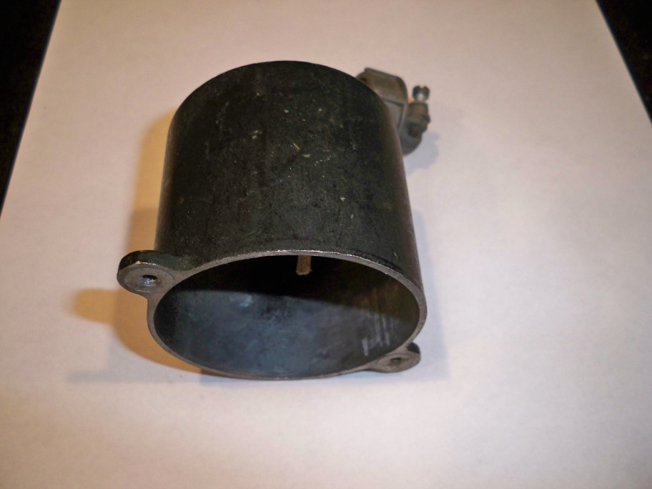

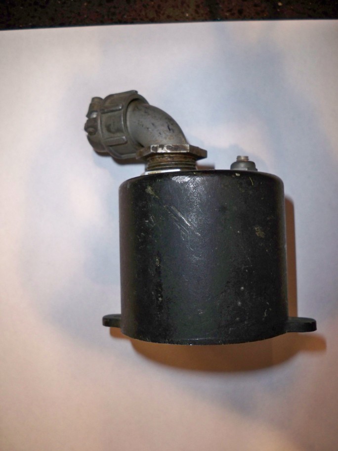

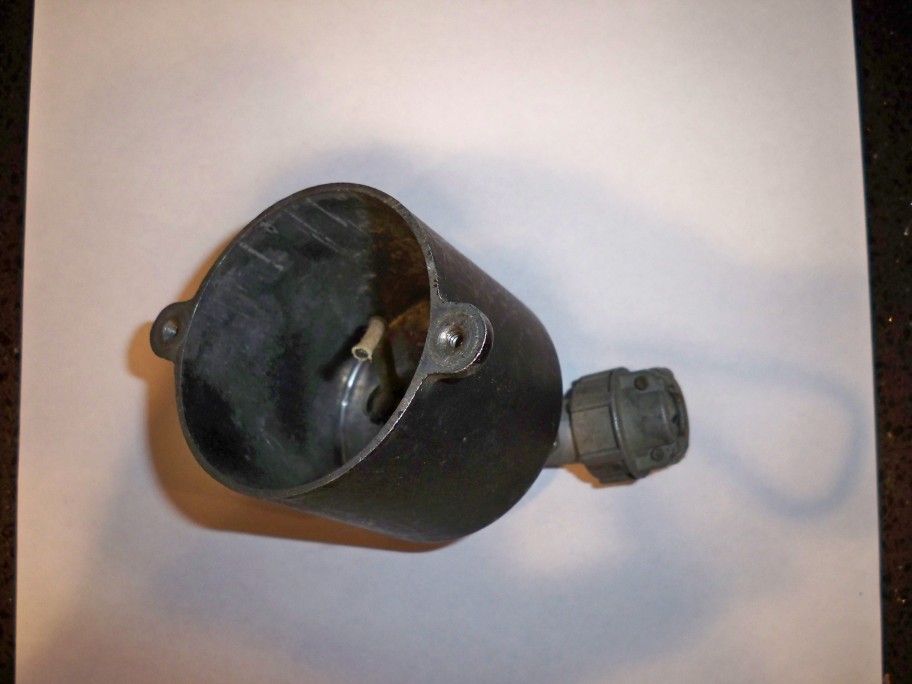

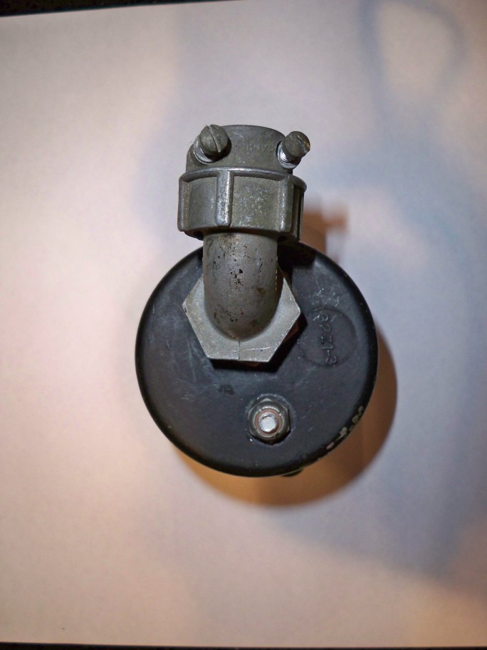

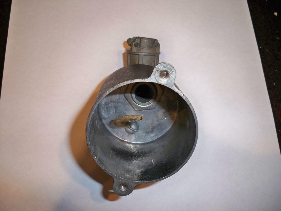

                  Re: Need Ercoupe cans
                  Ralph,
                  Here are some photos I just took of the mag switch shield. My understanding is they were used on the military ships, but I have nothing to back that up. A cast number in the unit is: 32Z1-3
                    Marty:
                    It looks like the one that was on ebay a few months ago......it does not look to be to difficult to make. have you posted them on the forum's gallery?.
                    Thank you for the pictures...they will help.
