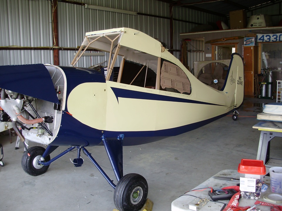

What are the rules for a "strap on" that is not a permanent install? We joke about the "Certified Velcro" allowing us to attach things with Velcro that do not require approval (yea, I know, you can't mount this with Velcro). Can this be clamped on without approval and used in some way? I have a mounting post on the belly of my plane (from the factory) for a Ward Aero that allows me to pull the generator by removing two bolts and unplugging the connector. The Ward weighs a TON and the prop has been known to throw blades. A Ward never produced 20 amps, much less 40 unless it was in the terminal dive after the wings were pulled off. The Ammeter for it only reads to 15 amps!
In my case I wonder if I could use a smaller, lighter, more reliable generator in place of the Ward without jumping through too many hoops. Engineering and safety wise, it's a no brainer. What say the legal A&P, IA and FAA folks? Is there a way to do this? We aren't going to get killed doing it, are we going to loose out tickets or get our planes declared non-airworthy?
