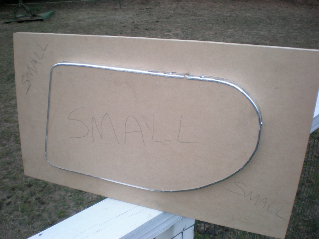

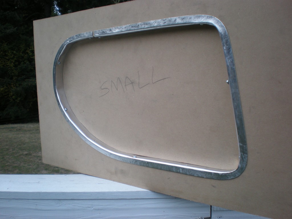

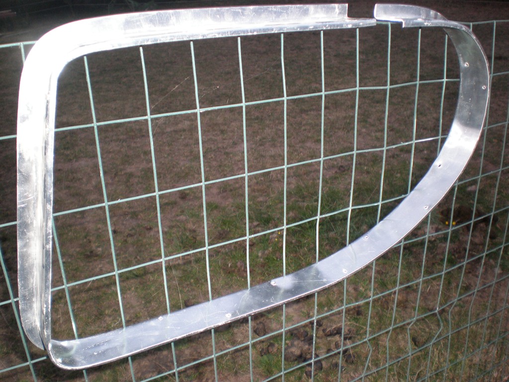

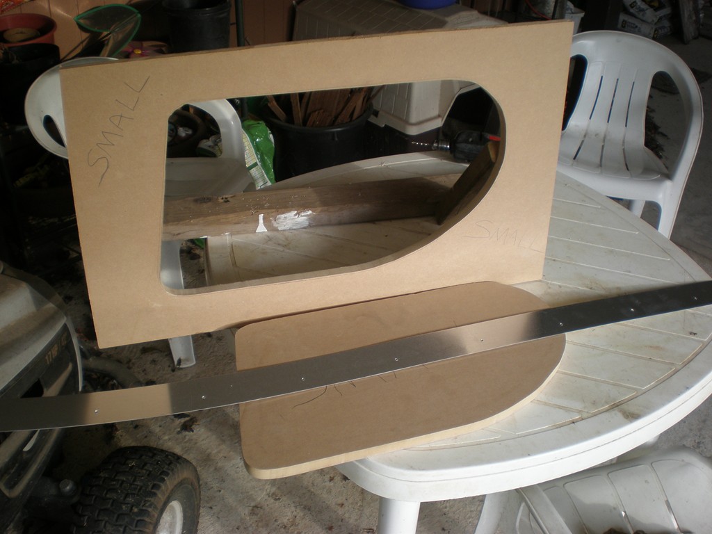

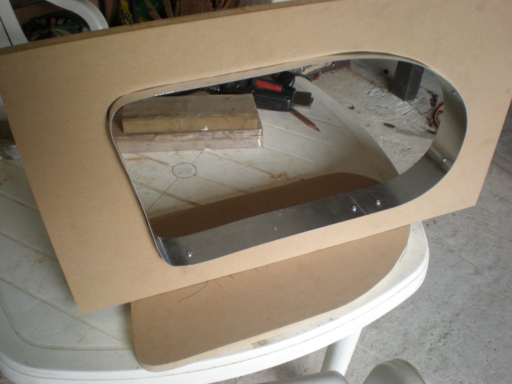

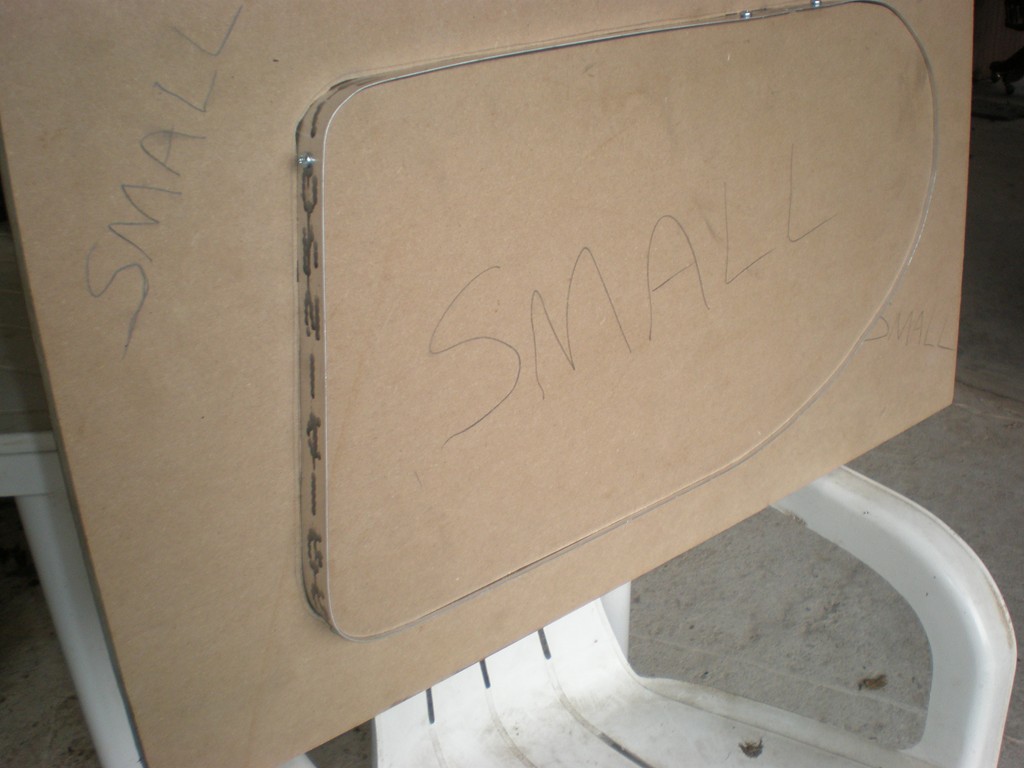

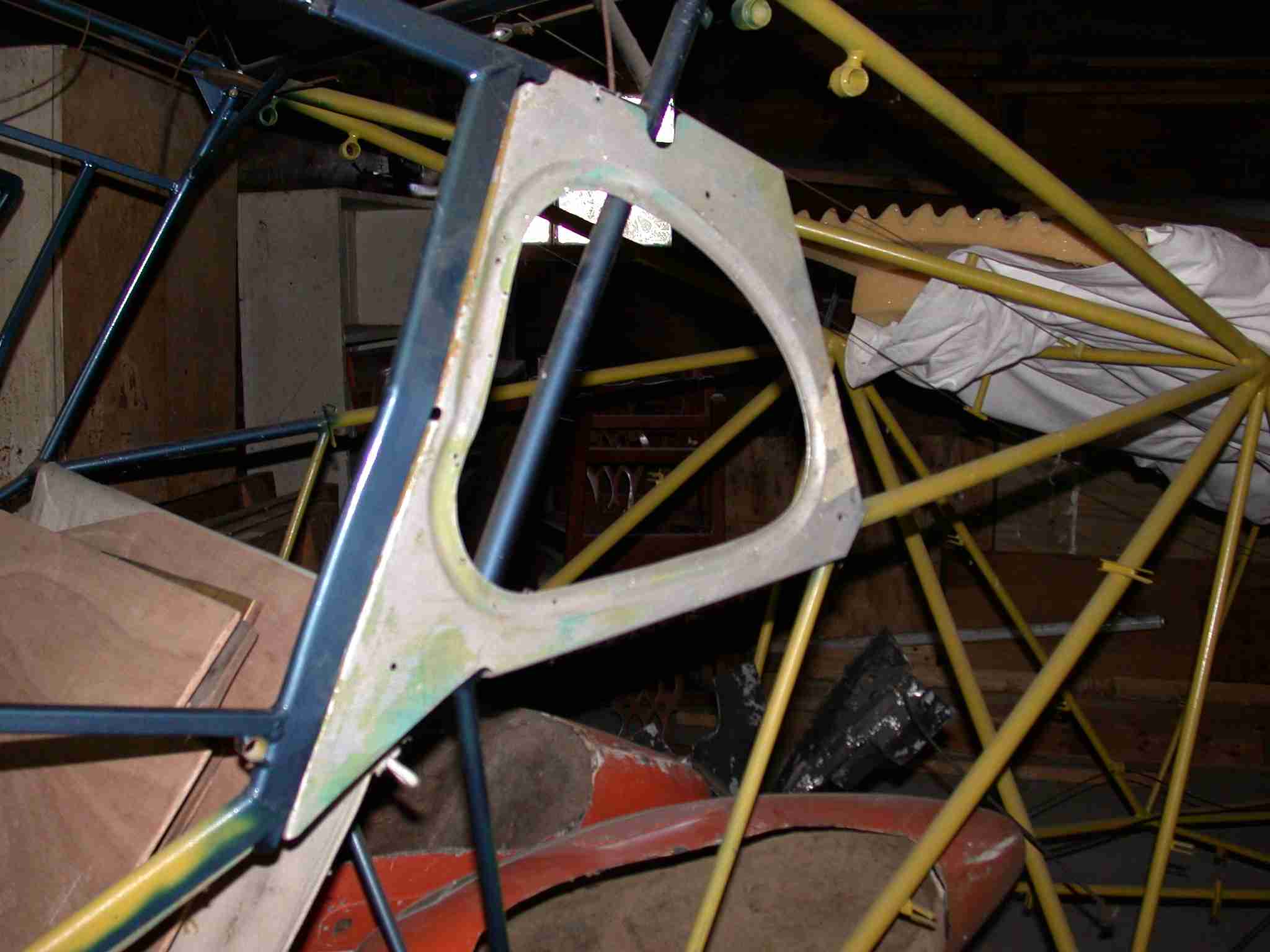

I ended up making an owner produced part for my windows. I used MDH to create a male and a female buck. I used dead soft aluminum and had it heat treated afterward. I have some pictures, if anyone is interested.Richard Pearson

I am not sure how many pictures the webmaster will let me post. There are a total of seven photos. So if I don't get all of them posted with this message, I will post another message.
From viewing the seven pictures, you can pretty much figure out what I was doing. If you have any question, I will be glad to give more detail.Attached Files- Taylorcraft Window1.JPG (146.4 KB, 208 views)

Thanks Richard:
We were out your way just for two days to see the new grandkid. I actually considered calling, but figured I'd better focus on the family stuff...you know how it is. And that rain thing, it's gotta be like Jimmy Buffet says...changes in latitude = changes in attitude. I'm all depressed cause it's raining while everyone around me is cheerful: "What a beautiful day. It's raining!" I dunno.
Let me see if I understand the window. You made a female jig in the shape of the window, then bent a strip of aluminum (type?) around the inside of the form and rivited it (to a doubler?) so it would hold that shape. Then you made another, male, jig. And...are you making a second part or doing more forming on the original? Lost me there.Bob Gustafson
