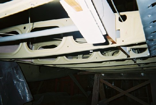

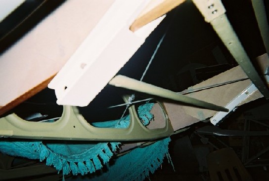

          These are not the best pics but they give you an idea of what what the shear plate looks like. It has to be added to both front and rear strut fittings.The shear plates are of .090 thick 4130 steel. You must also check the wing attach fittings to ensure they are also .090 thick,most are but some are not.

              Here's the strut fitting plates before (showing spacers used to maintain alignment during welding)...
              ...and after...
