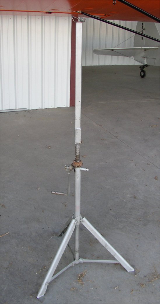

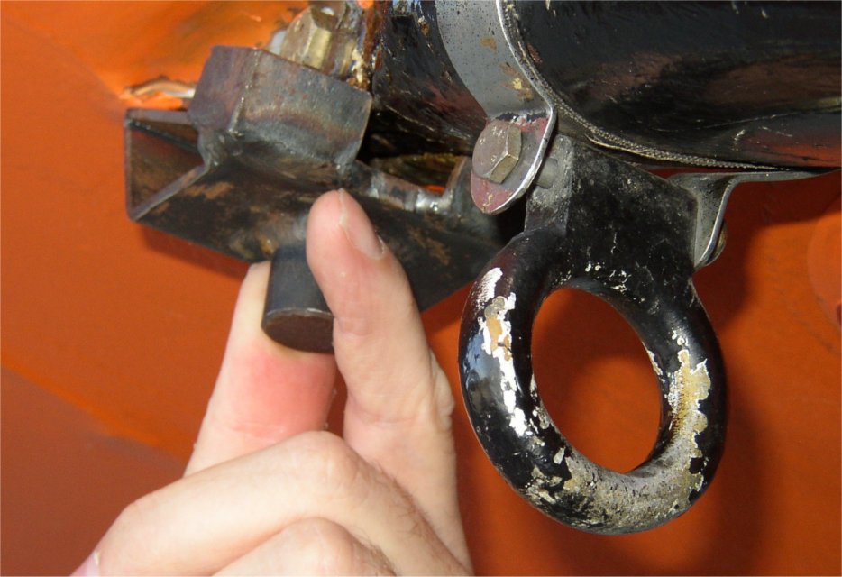

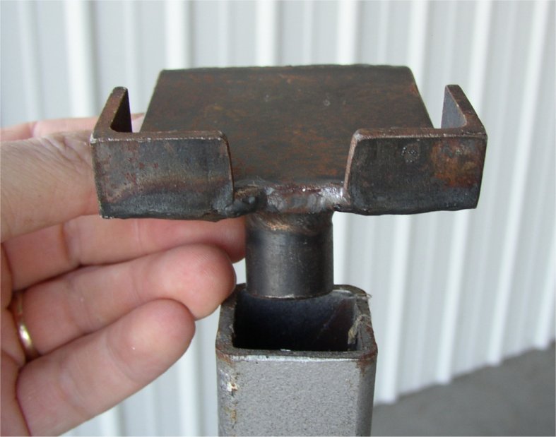

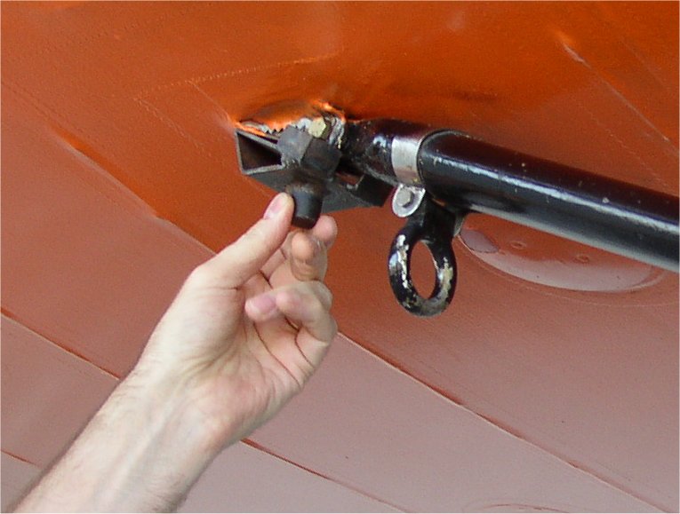

          Wing Jack Pictures
          For those who expressed an interest, here are the pictures of the "ho-made" wing jack.
          - Carl -
