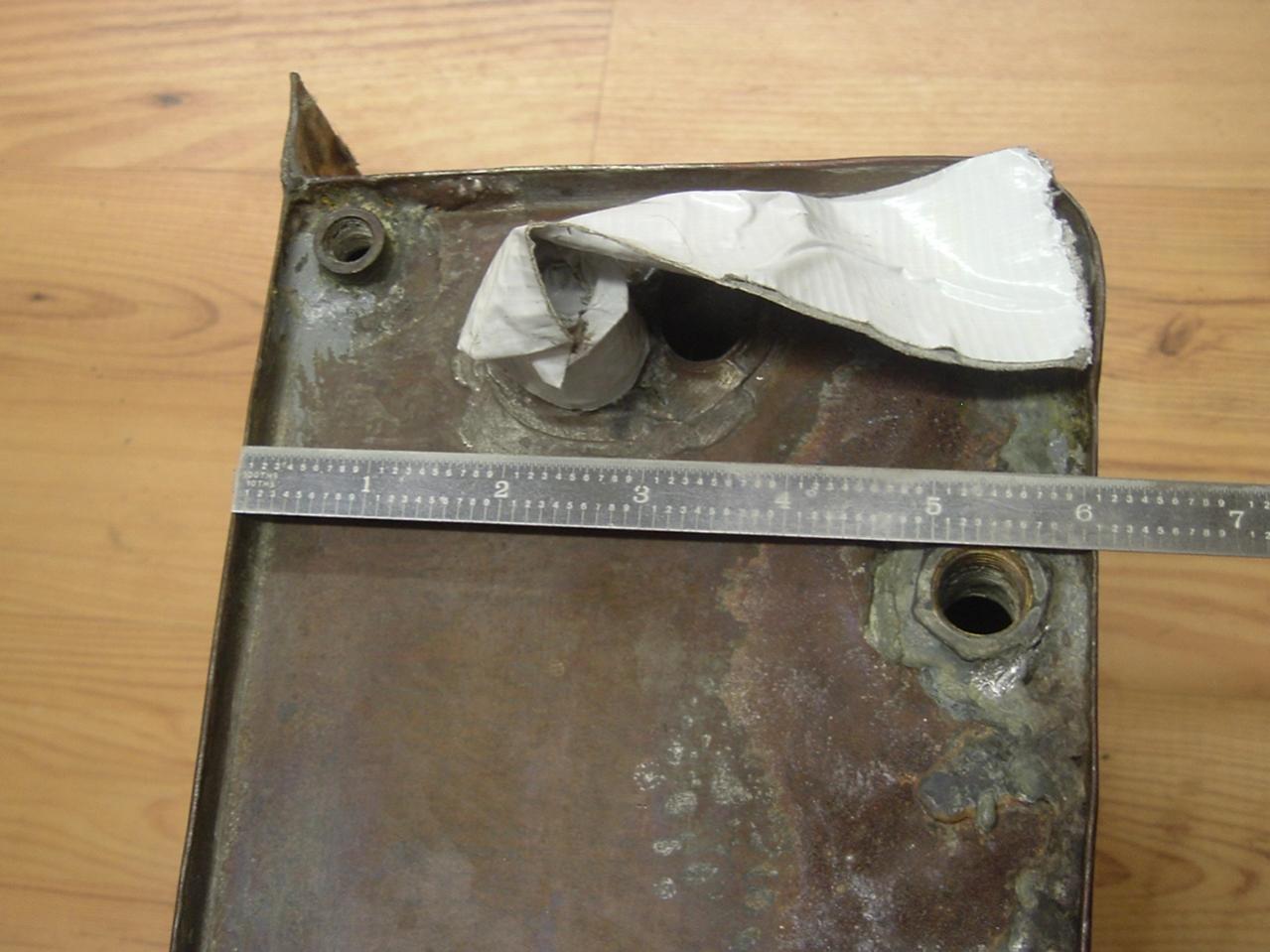

    Terry, do they include the L-2M tank. It's the same as the tank used in all the other model "D"s with the pass thru for the spoiler rod. Dick

      Not at this time, but it will be a simple revision. Its just a single tube pass-through. I have an L-2M tank here to get that measurement from.
      For those wondering what we are talking about... Here's a photo of an L-2M tank that Dick is talking about with extra tube (with white tape on it) for spoiler control pass-thru.

        Terry when you do that keep in mind that the location is different between the left and the right tank. Dick
