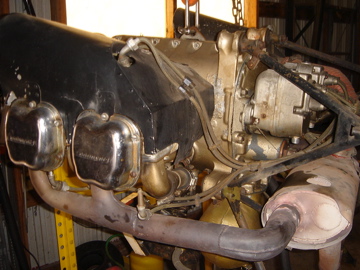

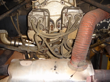

    I'd like to pick the brains of all the L-2 guru's...I'm winding down to the end of rebuilding my L-2A and it all comes down to my last and final hurdle. The "exhaust", mainly the muffler. there is a small hole that I'm not comfortable with; and could probably have a temp fix to get me by. The heat shroud also has (for some reason or another), a portion of it cut out. See attached picture. Wag Aero and Aerospace Welding have been my only current option. It appears a custom built muffler is the only option available. I'm not happy with this because of the cost ($1000+). I'm hoping next year to step up to a Cont. 85hp which will require its own unique exhaust system. To the point - do any of you out there have an L-2 muffler for sale? Any input, as always would be greatly appreciated.
    Thanks. Jim Malone

    Jim,
    Give Sonny Poarch an e-mail at [email protected]. A completely new stainless exhaust is $850, but he should be able to give you some advice. One other thing, a friend of mine has an 85 on his, but it looks like a stock exhaust to me??? I'm not that familiar with the exhaust as mine has a BC-12D exhaust on it. I plan on getting a system from Sonny to rectify that.

      Re: L-2 Rebuild Continued.....Exhaust question
      Jim,you can use the same exhaust on the 85 as you have on the 65. The only modifaction needed is on the heat muff carb heat side. Dick
        Unless you install a -12 like we have and the stock exhaust no longer works. I should have a muffler but I dob't I have a shroud.
              We used the system on a C-85-12 without the starter and generator and just had to modify the shroud. Dick

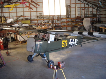

                Kent,
                I'm over here in Springfield, IL. There are three other L-2's in my area, making it two M's and 2 B's total. I will send you a couple of pictures of mine and direct you to a website of one of the others.
                  We did as well the first time but was far from ideal. The approval we used specify's an ercoupe muffler and works a whole lot better.
                    Jim,
                    My L-2M is using a modified Cessna muffler and shield. I have the 337, if you think it would help.
                    Muffler p/n 0450400-28; shield p/n 0450400-6
