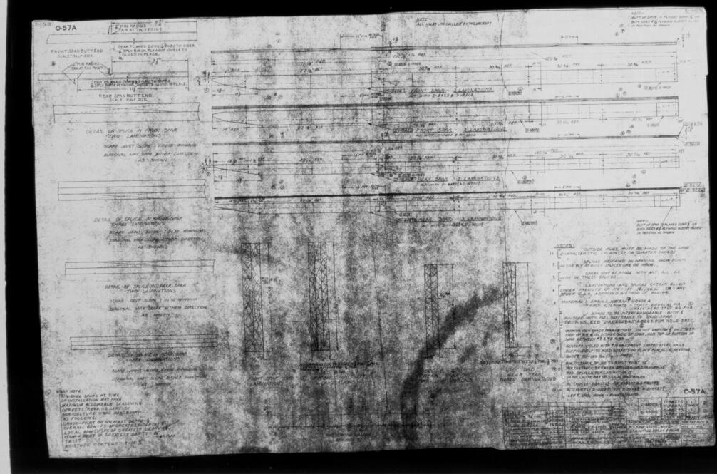

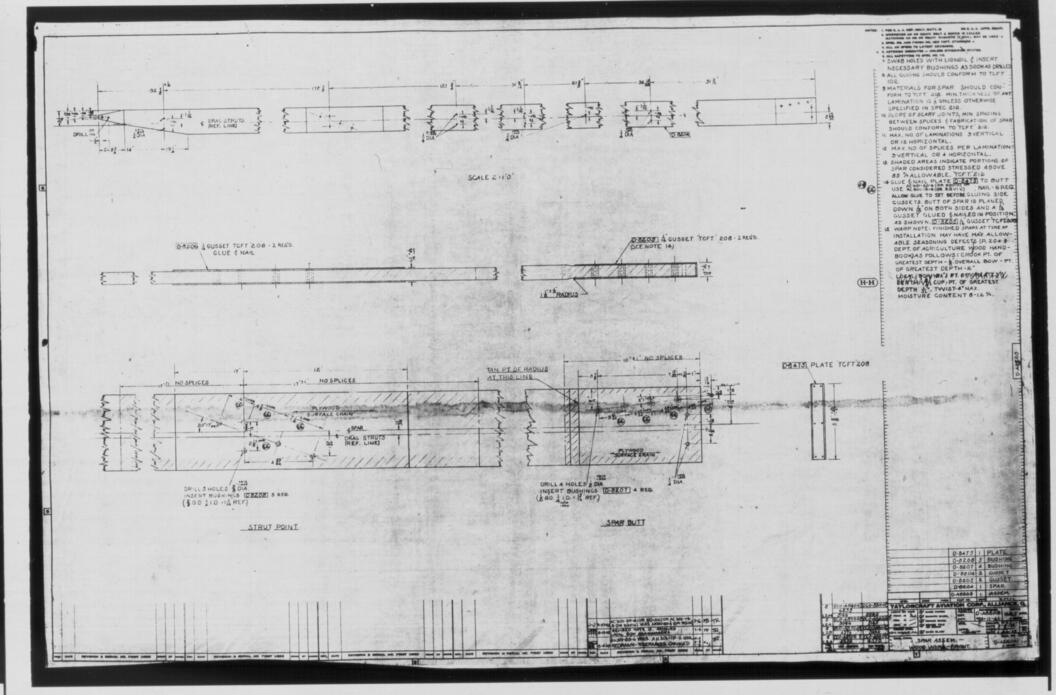

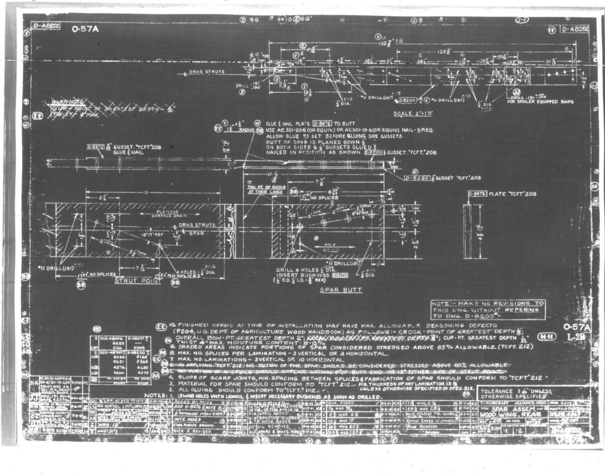

      I think these are the front and back drawings,
        Really hard to read 80 year old drawings. I did not see the dimension I was looking for. Do you see it anywhere on these drawings?
          Try these. Thickness is 15/16" +1/32/-0".

            So it looks like the wood spar thickness is 15/16 and the rib spacing needs to be 31/32 which will allow 1/32 clearance for the rib to fit over the spar.
