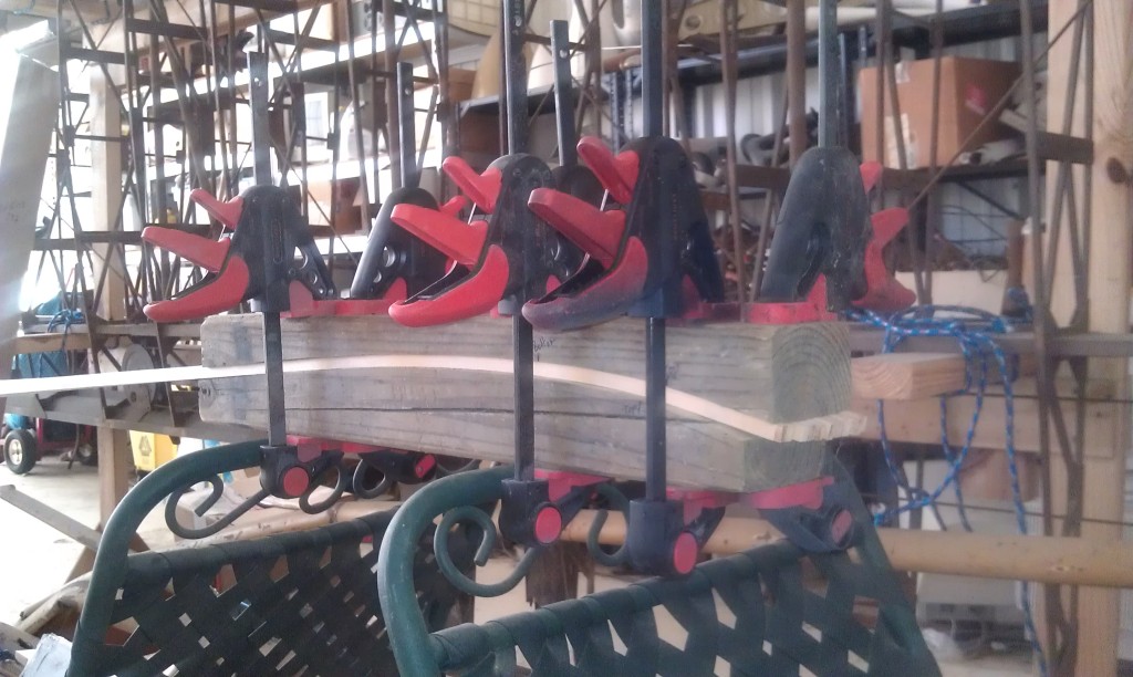

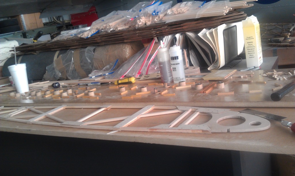

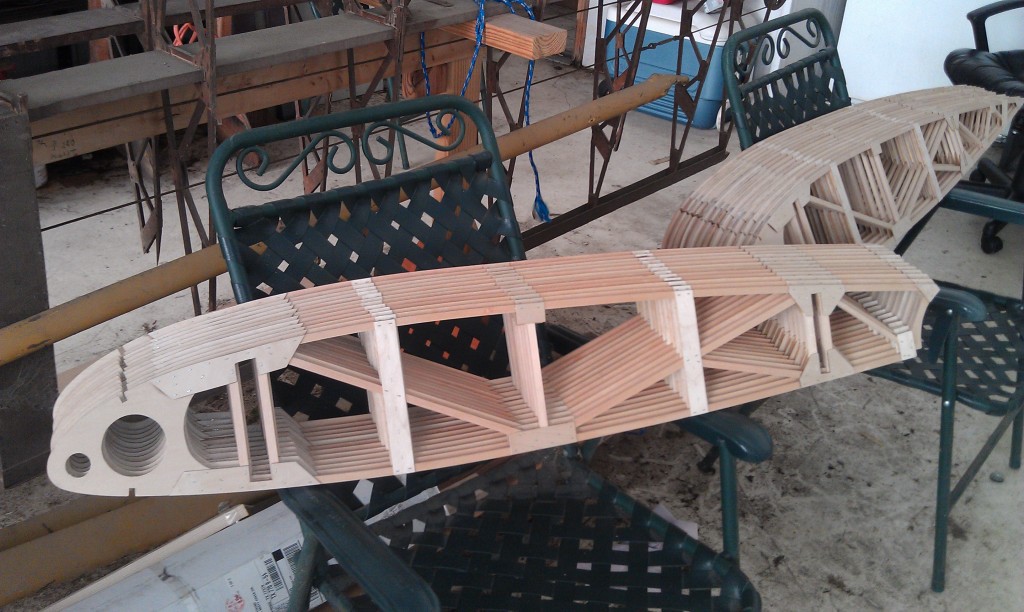

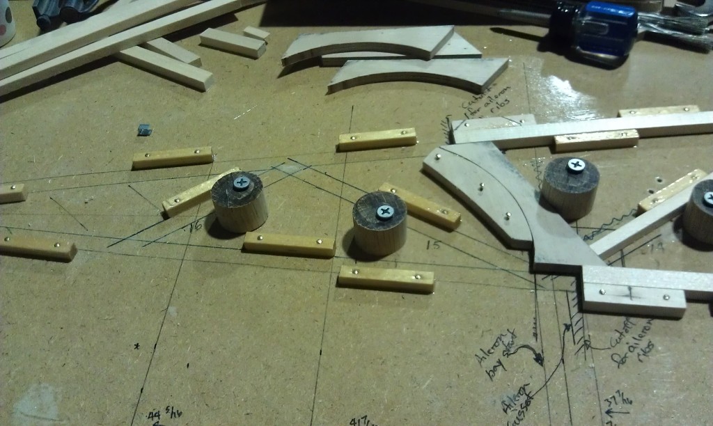

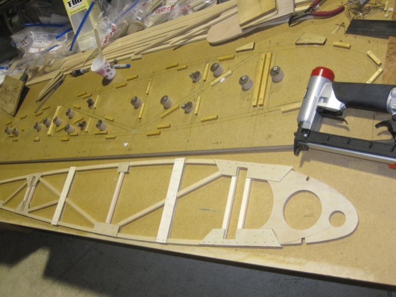

        I thought I had an old post showing my rib construction but it might have gotten lost in the server crash. Here are some pics of the set of ribs I built. I used a router to duplicate the plywood pieces. It worked much better than I thought it would and I only flung one piece across the hangar;-) I can provide more details when you get to that stage.
        I used the same jig for the all the full length and aileron bay ribs. I had a separate one for the tip ribs.
