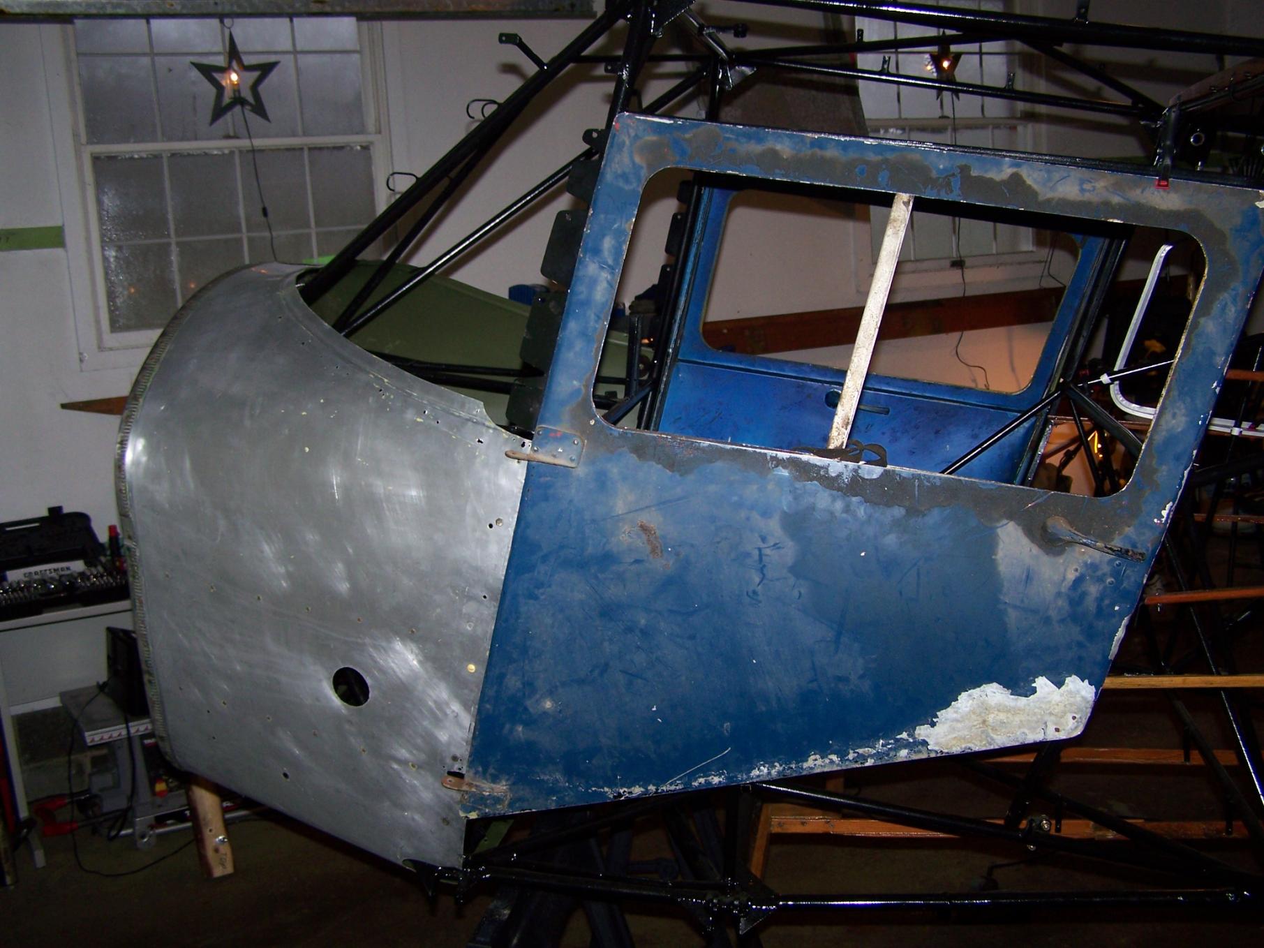

    How did the (door) windows come from the factory in 1946? Mine had a fixed window on the passenger side and a two piece sliding affair on the pilot side. Others that I've seen had a version that swings out from hinges at the top. I'm assuming the pilot side opens so as to communicate to the person propping the plane, but a fixed version with a vent sounds simpler and leak free....I'm restoring the doors so I can pretty much do what ever is correct. Is there a source for these windows or is it just lexan?

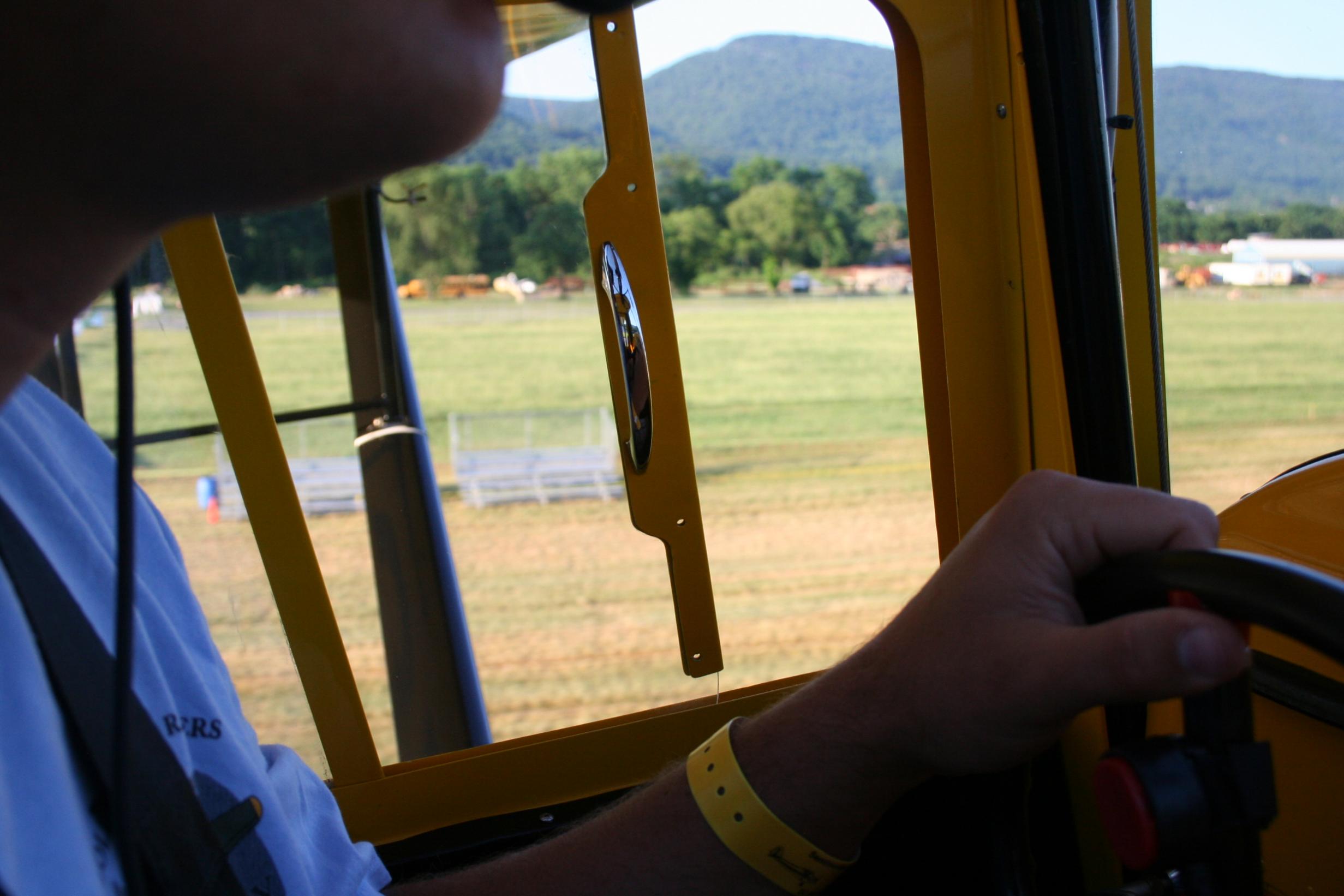

      Bc12ds had sliding windows. Wag aero makes a kit for these windows but we had alot of trouble with them cracking. We fabricated our own from lexan and no issues so far. The original inside window frame has a piece to hold in the rear window and the front window has a metal trim piece for the handle and another piece on the back side of it. Ours are held in by felt and work really well. Like Jim said are very nice in the summer
