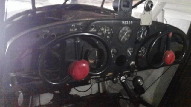

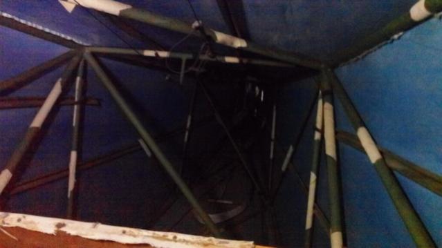

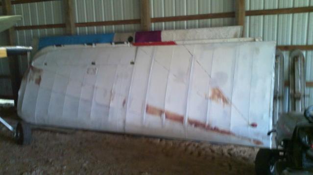

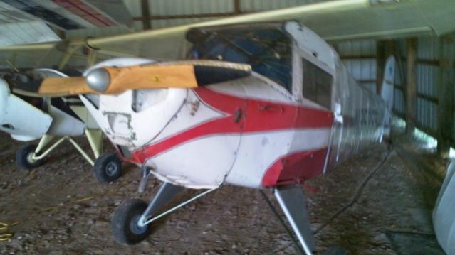

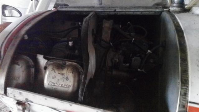

    I got all of the title work cleaned up and completed the purchase of N95359. It has been in Vermont for 40 years, but not flown much in the past several years. It was in annual in 2011, but I elected to have the wings and tail feathers removed and had it trucked to Michigan. We may end up recovering before reassembling and putting back in annual.
    I'm fairly new at this but have the help of a good AP/IA, experienced with tube and fabric. I'm going to Oshkosh and look forward to the VAA dinner and T-craft forum. I also plan to participate in the fabric workshops, as I'll be looking at Stits, Ceconite and talking to the Stewart folks.
    I've attached a couple of photo's.....as mentioned I'm investigating recovering systems and looking at updateing the hacked up panel.
    And comments and/or well wishes would be appreciated!

            Sounds like a return to original for a nice VFR trip back in time. I would try to return to an original panel as much as possible. What i love about my plane is when the door closes I am back in 1941 with the exception of a hand held radio on the pilots A pillar and a tucked away intercom to plug the headsets in to. Got to find one of those early 1940s hats and a pipe for the hat shelf.
              Re: New BC12D
              Dan,
              There is a guy over in Indiana who makes new instrument panels. I just installed mine this last Spring, very nice. Use the search function for Wenglarz and you will find other stuff he makes.
