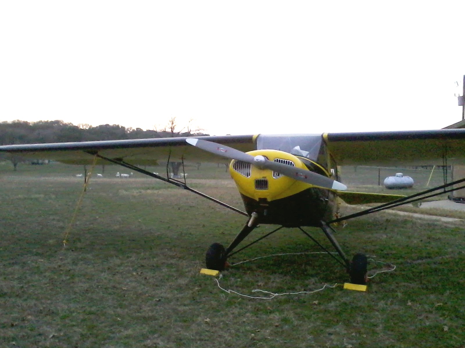

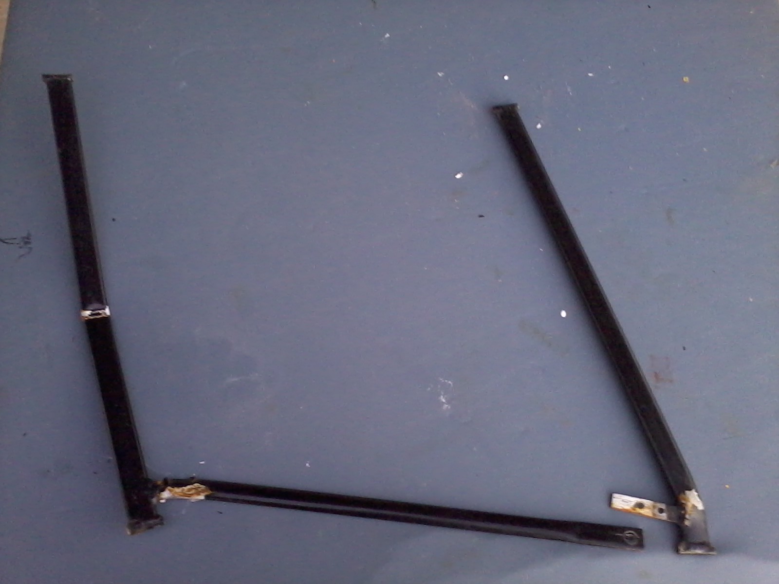

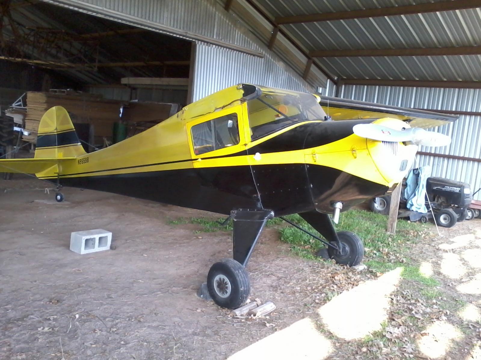

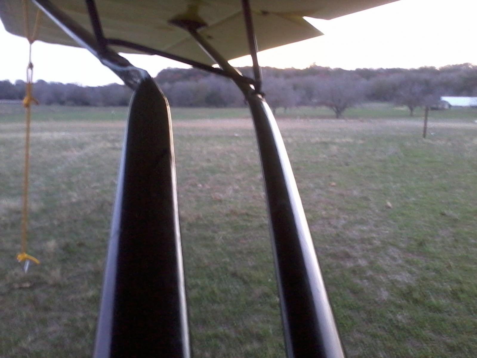

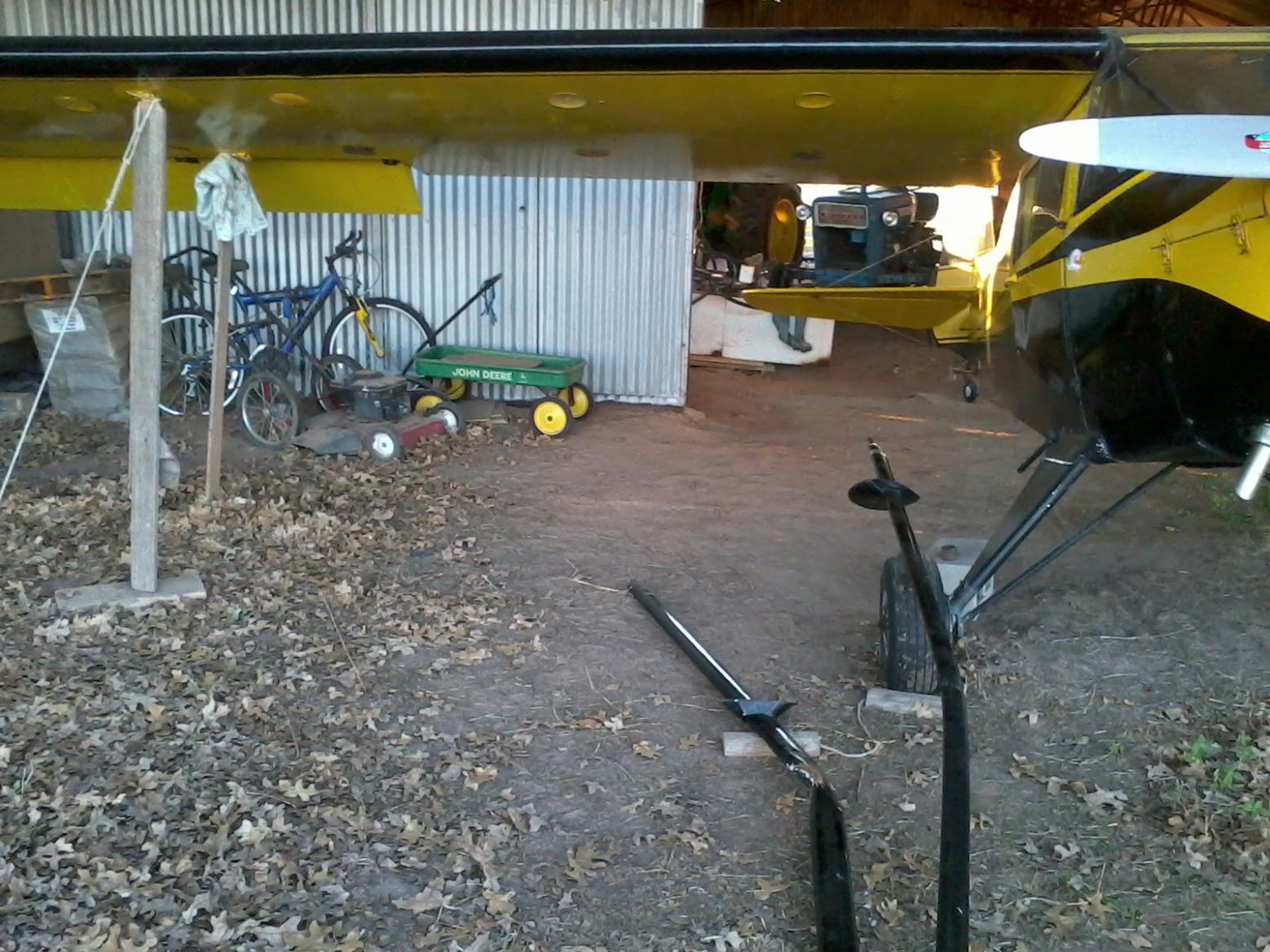

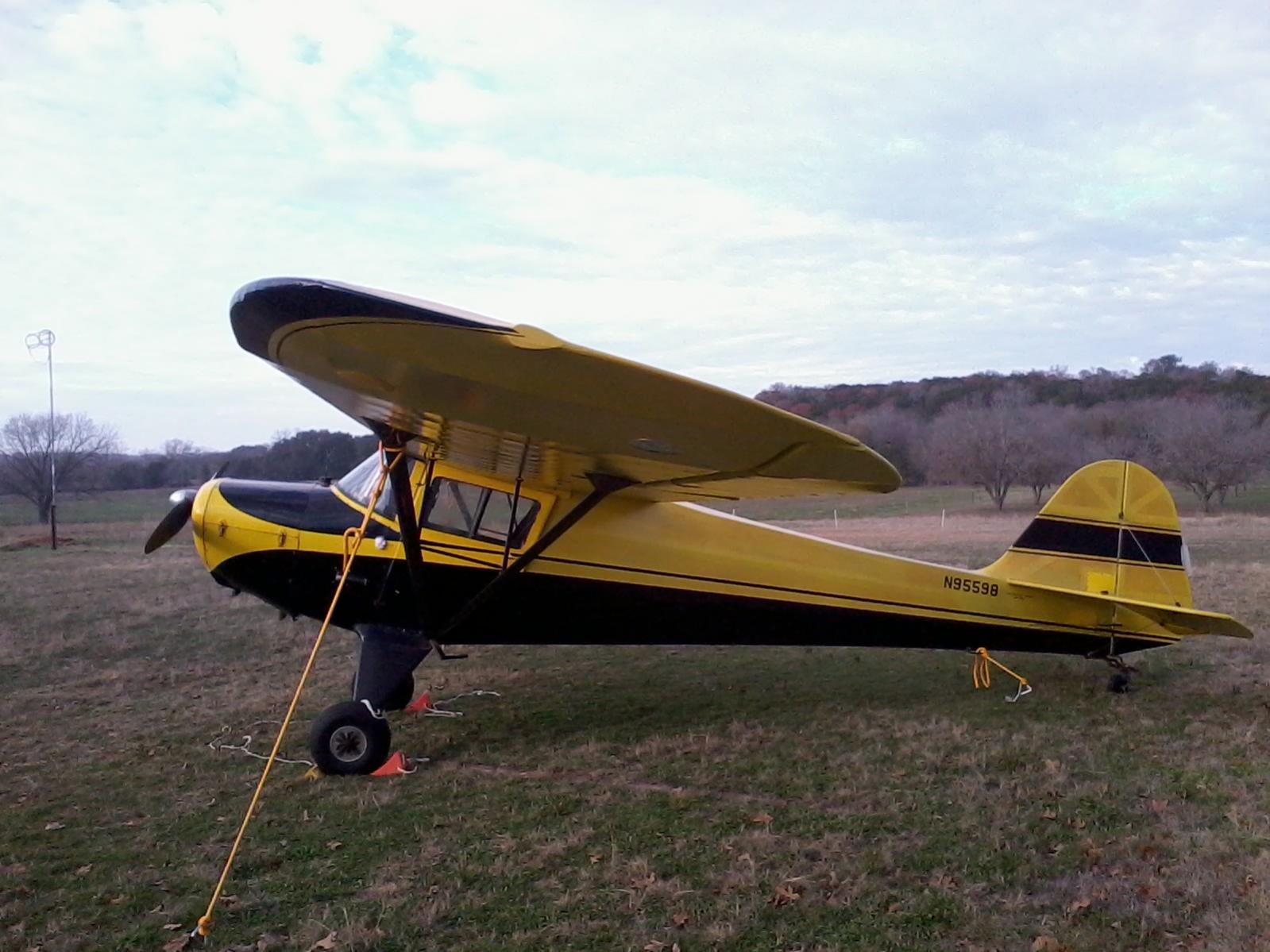

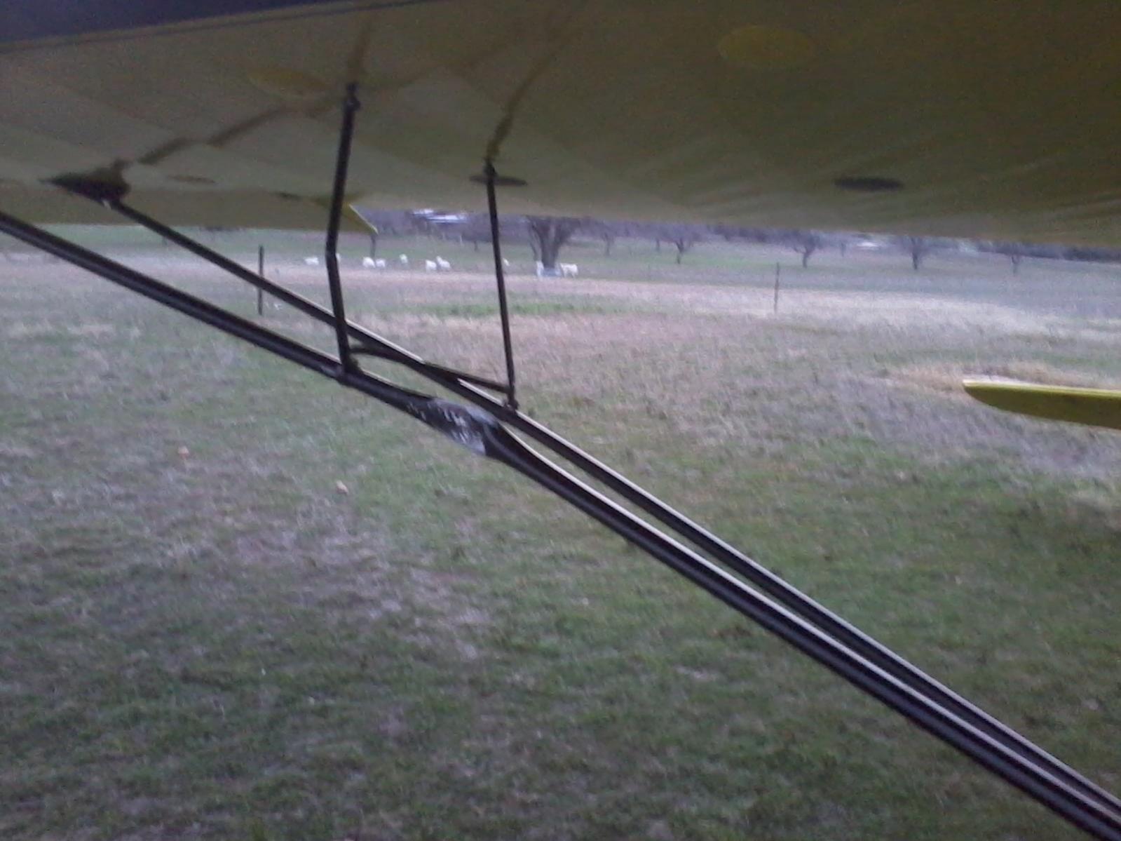

    Well as embarrassing as it is to report this, it could have been worse. It happened about a month ago. I had just landed at our home airport at Tick Hill Airfield with my daughter in the right seat. While taxiing in to the tie down area, I had a memory lapse. As I had done numerous times in the past, I turned right off the runway just after passing the windsock. Well... something new was lurking in my blindspot off my right nose. Then, I was abruptly reminded about a new goat fence we recently installed.
    Time for those new struts now.
    BC12D, s/n 7898, N95598

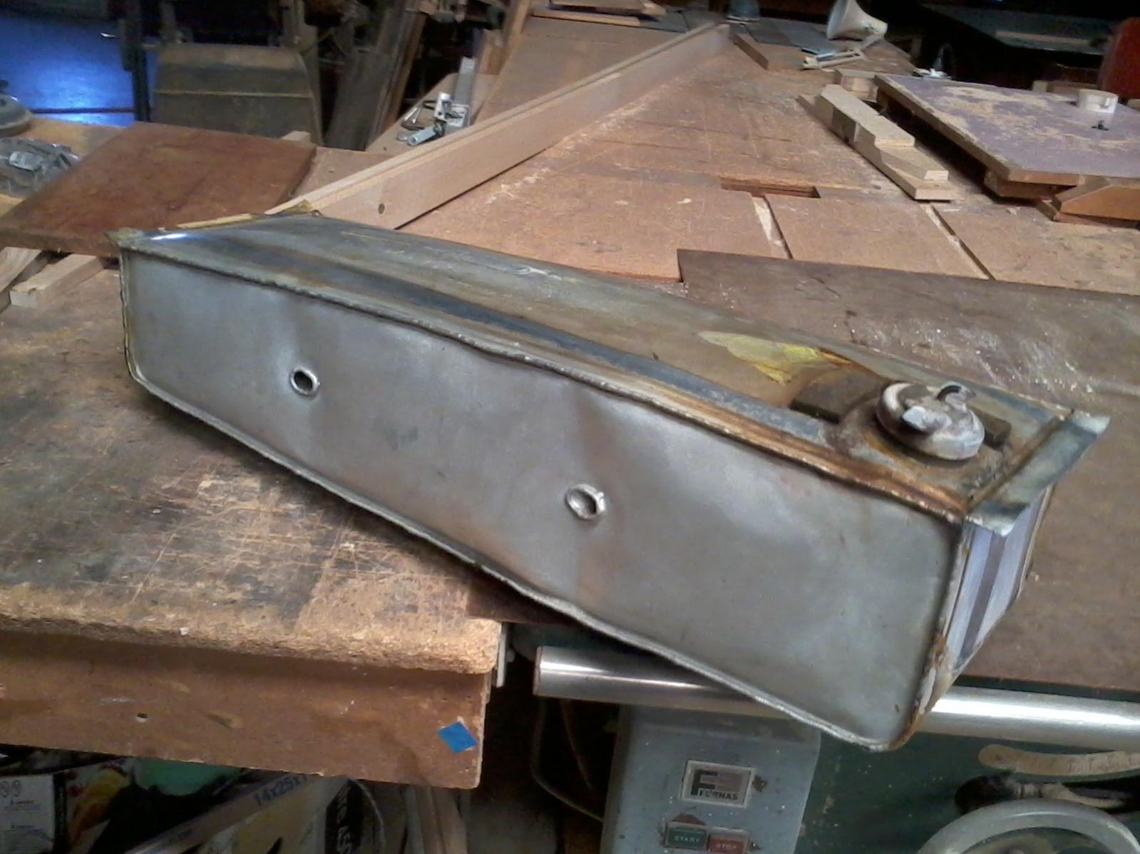

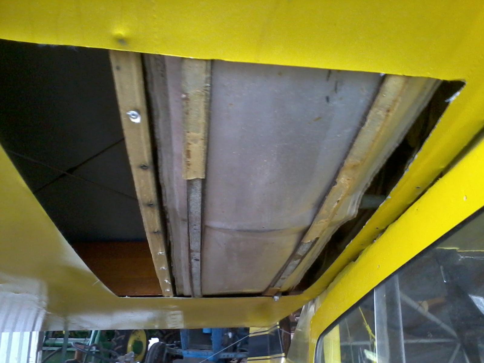

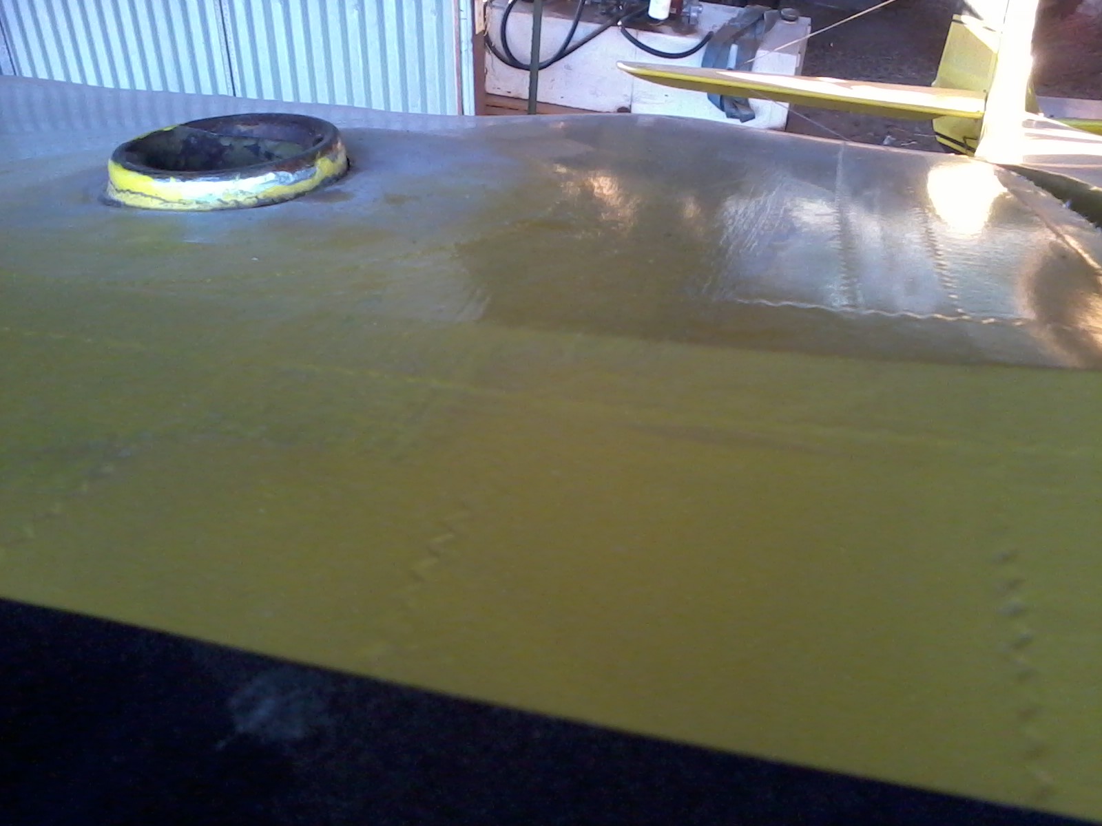

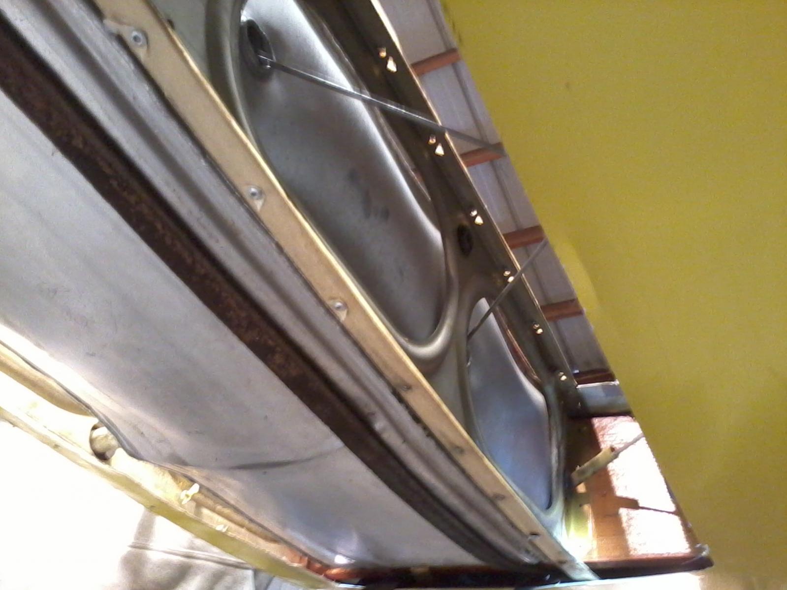

    It took me about a week to come to terms with this... but I decided I needed to look at the spars really good to make sure there wasn't any hidden damage. One of the first things I noticed turned out to be nothing to do with the taxi incident. Take a look at this photo... I really never noticed this before, but something was certainly awry with my RH fuel tank. There was an obvious bump under the fabric. The filler neck seemed a bit crooked. I thought oh... could that fence post bump on the strut somehow affect the fuel tank? Further investigation is in order here.

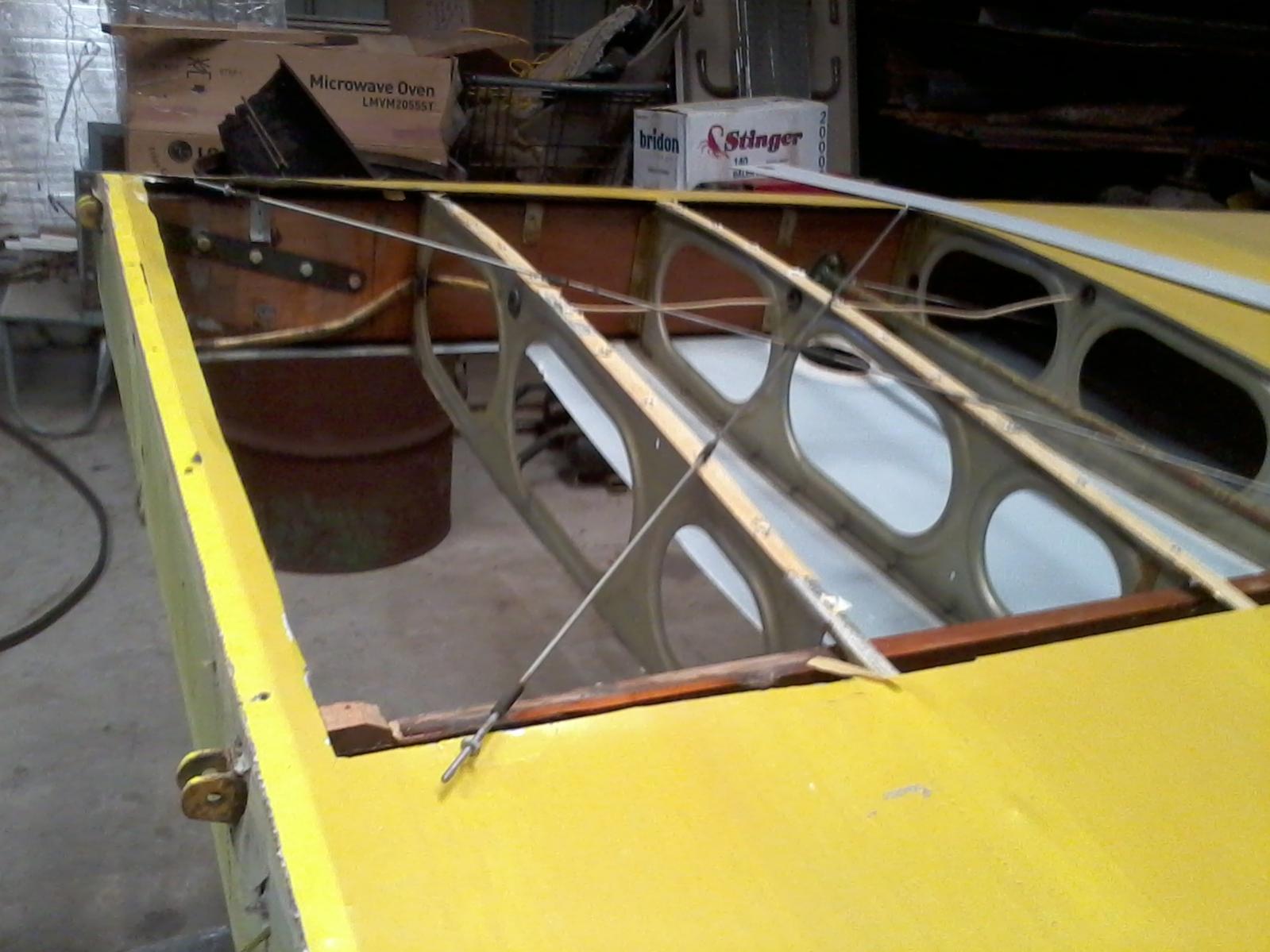

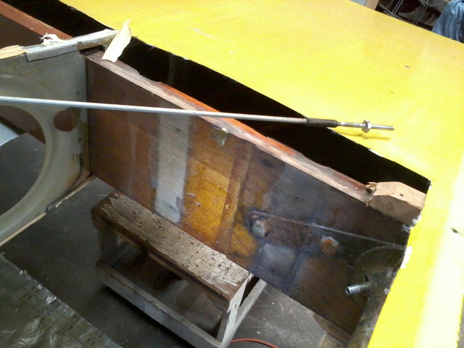

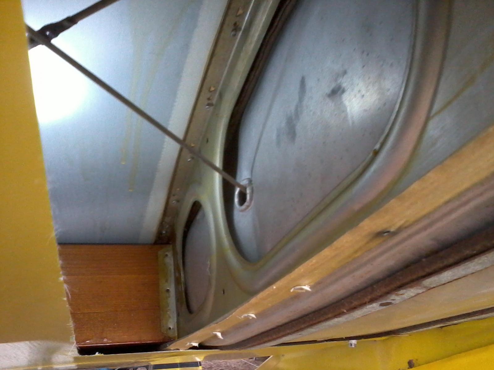

      OK... so today started out with a borrowed borescope and a plan to inspect to see what's going on with the tank. By far not enough access... so I bit the bullet and took a pocket knife after the fabric. I am glad I did.... here's what I found.
        Re: Runway Incursion N95598

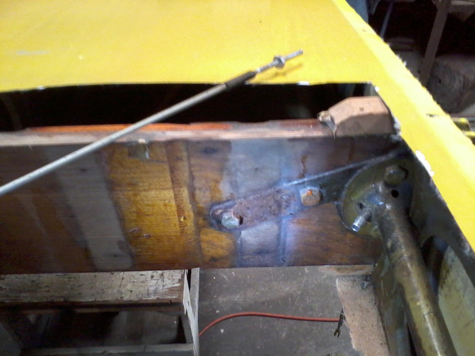

        THE GOOD NEWS.... Spars look great. I am actually looking forward to getting back into doing some fabric work. The plan is to re-assemble without the wing tank. Determined the cause of the issue was a plugged vent in the cap. Not sure how long this has been this way... apparently a long time based on some chafe marks. I'm glad I made the decision to dive in and tear this down. I happened to find a badly corroded rear spar wing attach fitting. It appears that the 1 inch felt pad behind the fuel tank likes to retain moisture.
        Jury struts, jury strut adjusters, and the wing attach fitting are bought. have the money now for RH lift struts and plan to order these on Monday. Now starting back together with it all... Goal is to make it to the Central Texas Taylorcraft Fly-in on March 30/31.
