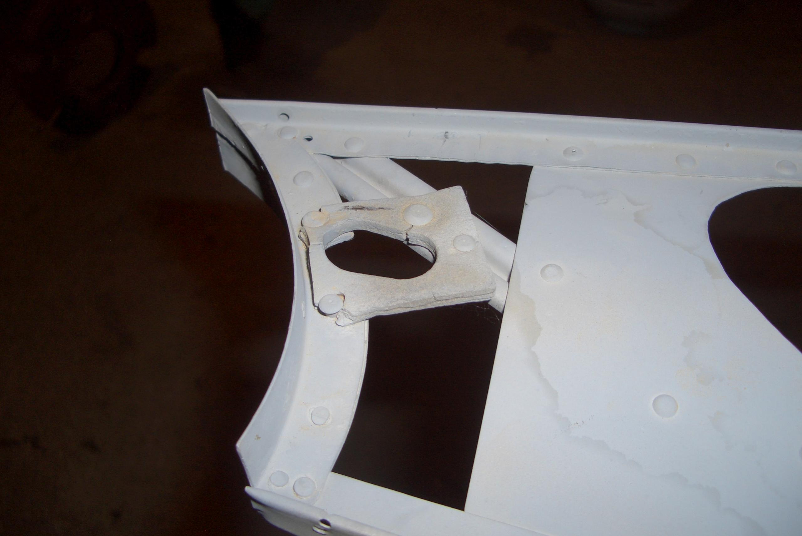

    Does anyone know where I can get material to replace the aileron cable guides? See the attached picture. What is the material called?

        When I cleaned mine up, they looked like new (although I see yours is cracked).
        Phenolic is good. It is commercially available as an electrical insulating board, so if you know anyone in the HVAC (High Voltage AC) industry, they might be able to slide an offcut your way.
        Incidentally, my other aileron cable guide looked like black nylon, although it was still riveted in with those pesky steel rivets, so was probably original.

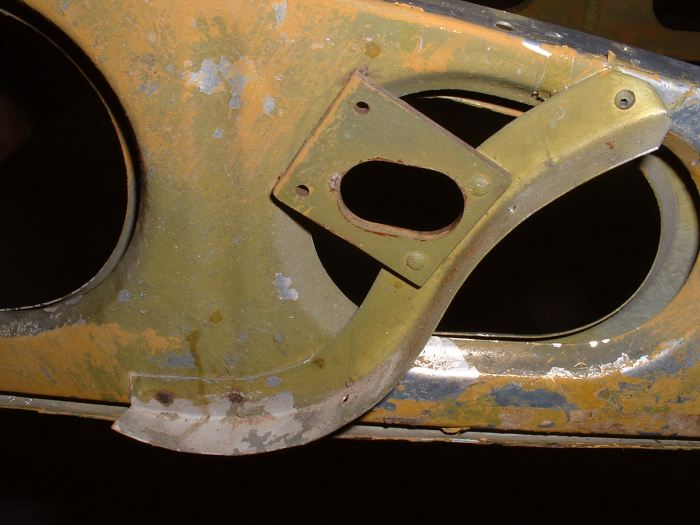

          Edit: I see you seem to appear have built-up (truss) ribs. Your fairlead seems to have cracked around the rivet holes (as would be expected).
          The photo below shows the same fairlead in my post-war stamped rib, and they only used two of the rivet holes (although evidently the fairlead is the same).

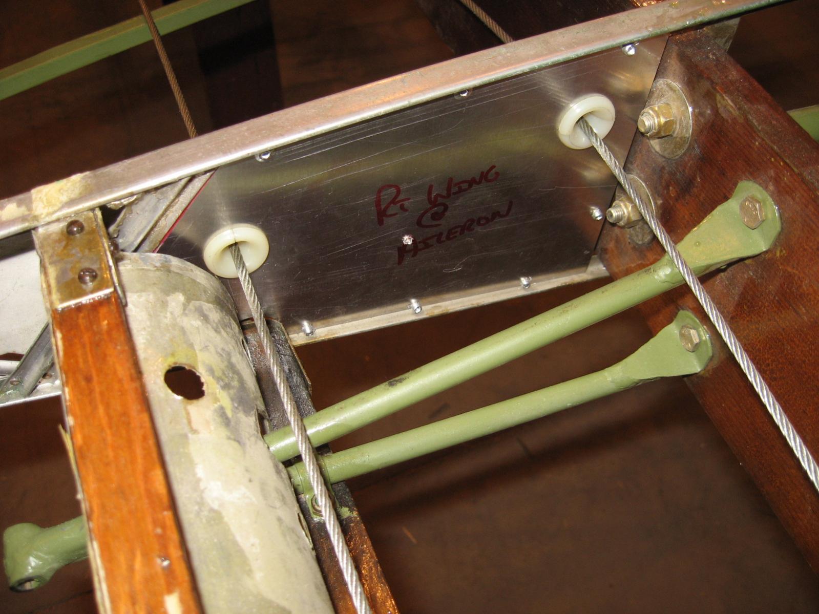

                another option....

                  If you go that way, make sure the thimbles (cable ends) will pass through the fairleads (or that you have access to disassemble the fairleads in situ) for future cable inspection/replacement.
