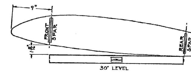

On my airplane we used the method described in the owners manual to check
washout. This requires a 30" level. When the airplane is levelled fore and
aft and laterally, one end of the level is placed up against the bottom of
the rear spar, at it's center point front-to back, and at the "first full
rib from tip - about 26" from tip". While holding the end of the level
against the bottom of the rear spar at the first full rib, pivot the level
upward until the top of the opposite end is exactly 1-5/16" from the bottom
of the first full rib and is at the centre of the front spar, front-to-back.
Is this wing wash adjustment levelling supposed to agree with the bubble
level over the rear spar?
It seems like there are too many places to level the ship and no
explanation of what to do if they do not all agree with each other.

You need a sawhorse and a 30" level. Now go do this procedure which is
straight out of the owner's manual:
Level the plane. Use the horizontal stabilizers as the level reference
longitudinally and laterally.
Place a 30 inch level under the wing in the following manner:
Put the aft end of the level at the intersection of the FIRST FULL RIB FROM
THE TIP and the Rear Spar,
Put the forward end of the level below the Front Spar,
Hold the level Level (of course).
Measure the distance from the forward end of the level up to the bottom surface
of the wing. This distance should be 1 5/16" One and Five Sixteenths Inches.
Mark J

A spirit level across the spars with a known dimension spacer will give you approximately
the correct washout...the final adjustment is done after test flying on the screw
adjusters on the rear struts. The Taylorcraft should glide *without turning* at 60-65 mph
with power off, full up trim, but you need to get trim tab, elevator angles etc correct

First level the ship as quoted in the manual.
"Levelling Procedure"
"Level in a fore and aft direction by supporting tail on stand and placing
bubble level on the horizontal stabilizer. When bubble is centered, the
aircraft is longitudinally level."
"To level aircraft laterally, place bubble level on one of the top fuselage
cross members or the seat cross tube." When the bubble is centered the ship
is laterally level. This step is not required for weight and balance but
"for rigging wings this step is very necessary."
Mark J
first.. The angles for the BC12D are as follows:
