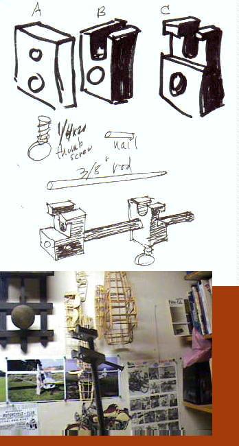

Naturally once you-all started talking about
trim tabs going ptfffoofl, mine had to do it also. So I thought about it
twice and made a gadget. Picture attached. If you don't like the picture
don't look at it.
To use this gadget turn the trim crank until the trim stops are centered,
then you simply hook the ends of the gadget over the spring brackets and
pull the back bracket back and lock it with the set screw. This will
release tension on the trim system. Now turn the trim crank till the
needle is centered. Then go to the tail, reach in through the inspection
hole and spin the trim pulley until the trim tab is even with the elevator.
You don't need to center the control wheel because there will be not tension
on the cable.
I've pushed the hooks on the gadget to one end so that it would be easy to
photograph. You can make one of these out scrap, plans are free.
RonC
Das dopplenderextenderspringenthingen plans. (picture below).
Get a lightweight tube or rod (hickory ram rod - brake lining - TV antenna
rod , etc.,) .
Drill a 3/8" hole in a block of something ( plastic, hard wood, aluminum,
etc.,) and another hole to match your tube (figure A). Saw out a notch down
to the 3/8" hole to match the size and depth of your trim cable spring
about 3/4" (figure B). It would help if you filed another cross notch
(figure C). This notch will keep the hook from slipping off of the spring
attach block (?). Slip one hook on the tube with the claw pointed left and
fasten it in place on the end of the tube with a screw, a nail, JB weld, or
what ever. Drill and tap hole in the other hook so that a screw can be
threaded into the hook and against the tube. I like 1/4 X 20 thread. It
is common and easy. Other threads available in England. Fancy thumb screws
are available in this thread in case you are going to enter it in
competition at Oshkosh. Next (see illustration - no figure letter ) slip
the remaining hook over the right end of the tube with the claw facing right
; now you can sit on the edge of the bed and light up. You are finished.
Hand rubbed oil finish, powder coating, or chrome plating is optional.
You may use your dopplenderextenderspringenthingen to expand to your hearts
content.
RonC

Pictures relate to a tool for relieving the spring tension, courtesy RonC.
Rob Lees
don't look at it.
on the cable.
RonC
rod , etc.,) .
content.
RonC
