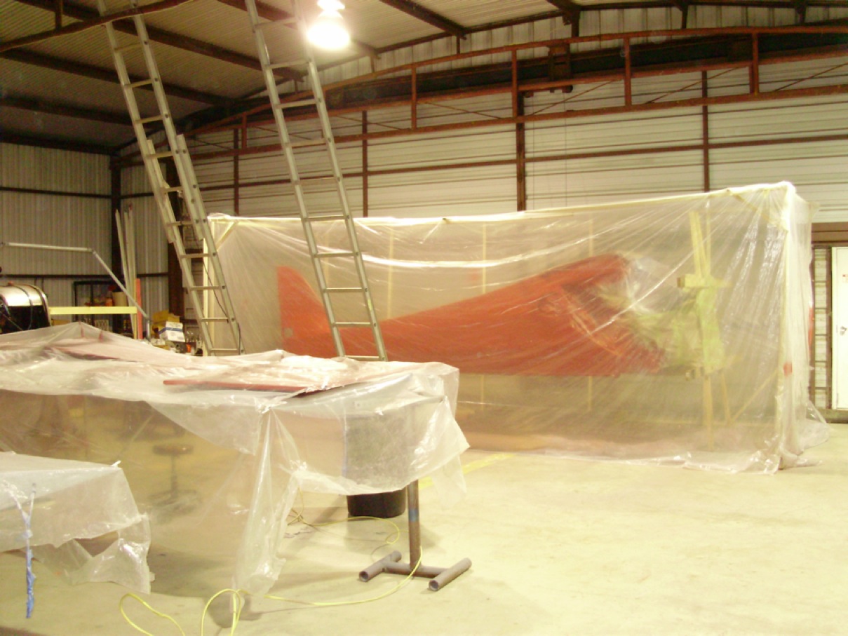

    Doc and I replaced his somewhat dim florescent tubes with sodium vapor lamps. Here is a picture with only three of six new lamps illuminated. It makes seeing inside the spray booth much easier, not to mention making tired eyes much happier when working on detailed items. Each lamp weighs 40 lbs and draws 4 amps. Two lamps provide far more light than the six original, double-eight foot, florescent fixtures. With cooler winter temperatures, the indoor florescent bulbs were getting reluctant to illuminate. Six sodium fixtures may be overkill for a hangar this size, but we can get a suntan as an added feature.
    This photo was two days before we applied tape for the trim color on the fuselage.

      Is that your paint booth , Mark? It doesn't look like there'd be enough room in there to paint. Maybe it's bigger than it looks.

        The booth is 8x8x22. It is cozy in there, but OK if you are careful. By "careful " I mean neither Doc nor I put a cheek mark on the paint job. There were moments when my back was up against the plastic curtain, but we could maneuver fairly well with two people working and using an HVLP gun.
        For those that might wonder; the time it took to make this booth was negligible compared to what it would take to buff out dust and bugs. Red paint attracts insects from mies around (and yellow is attracts bugs even more.) I have painted in the open air several times, but the quality of the finish is much better when there are no air currents and no direct sunlight. It gives the paint much more time to settle into a nice shine. Our biggest concern has been with the cool mornings and warm afternoons that the structure is still a bit cool and the paint wants to bead up just a little. We solved that problem with a little extra reducer and because we are painting mostly on flat level surfaces we can get away with heavier coats of paint that flow out well.
