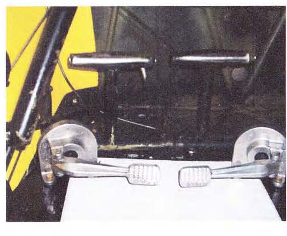

      We have a kit set-up for Grove brakes with heel pedals retained.

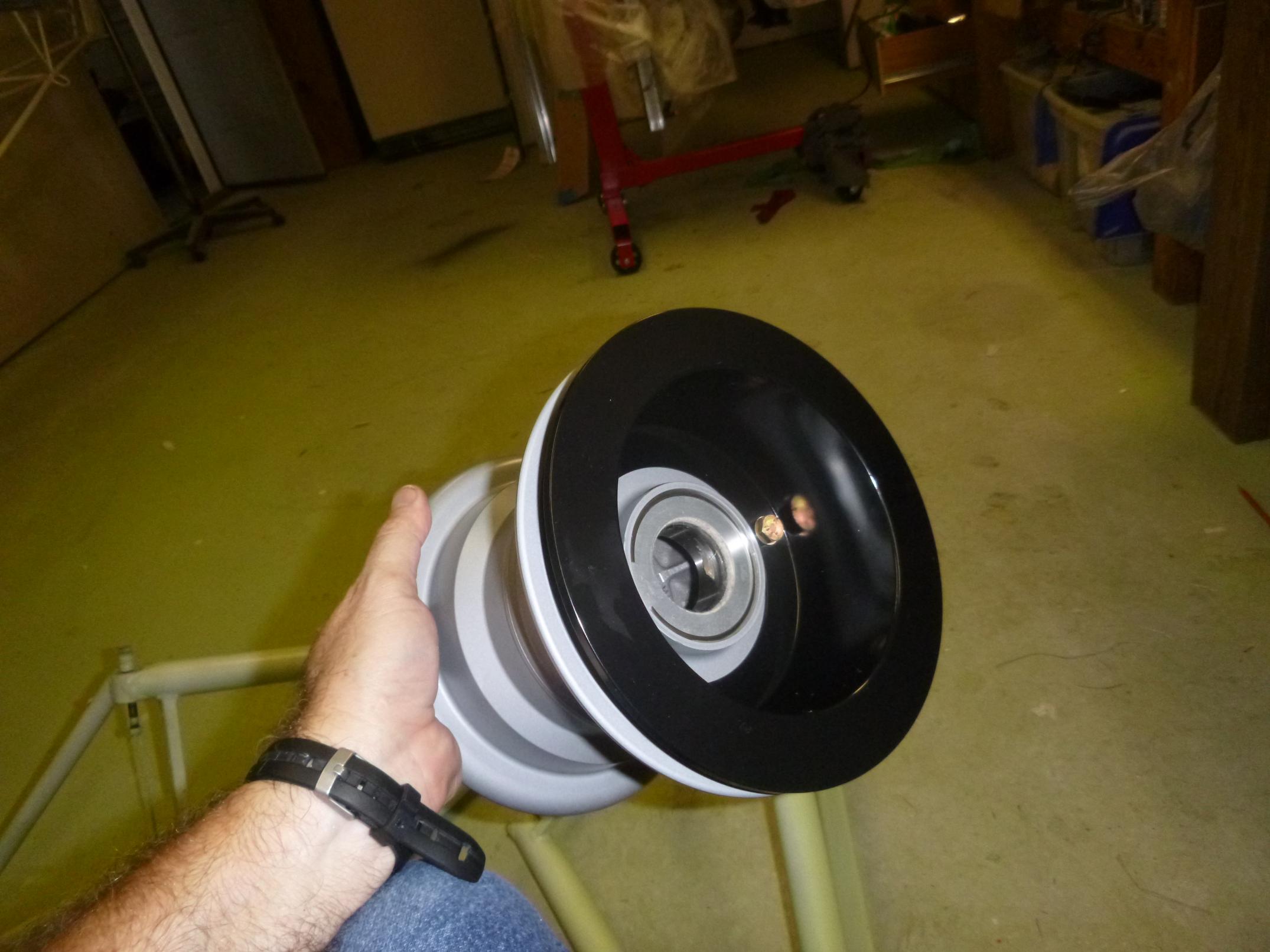

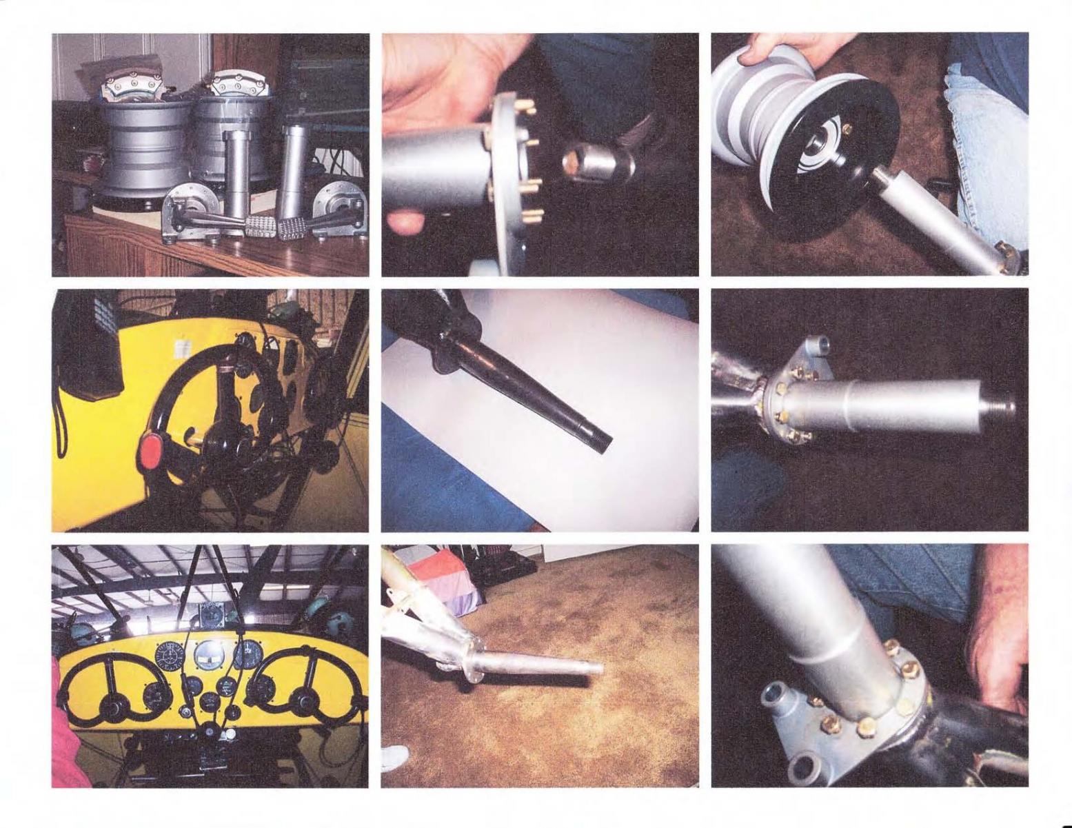

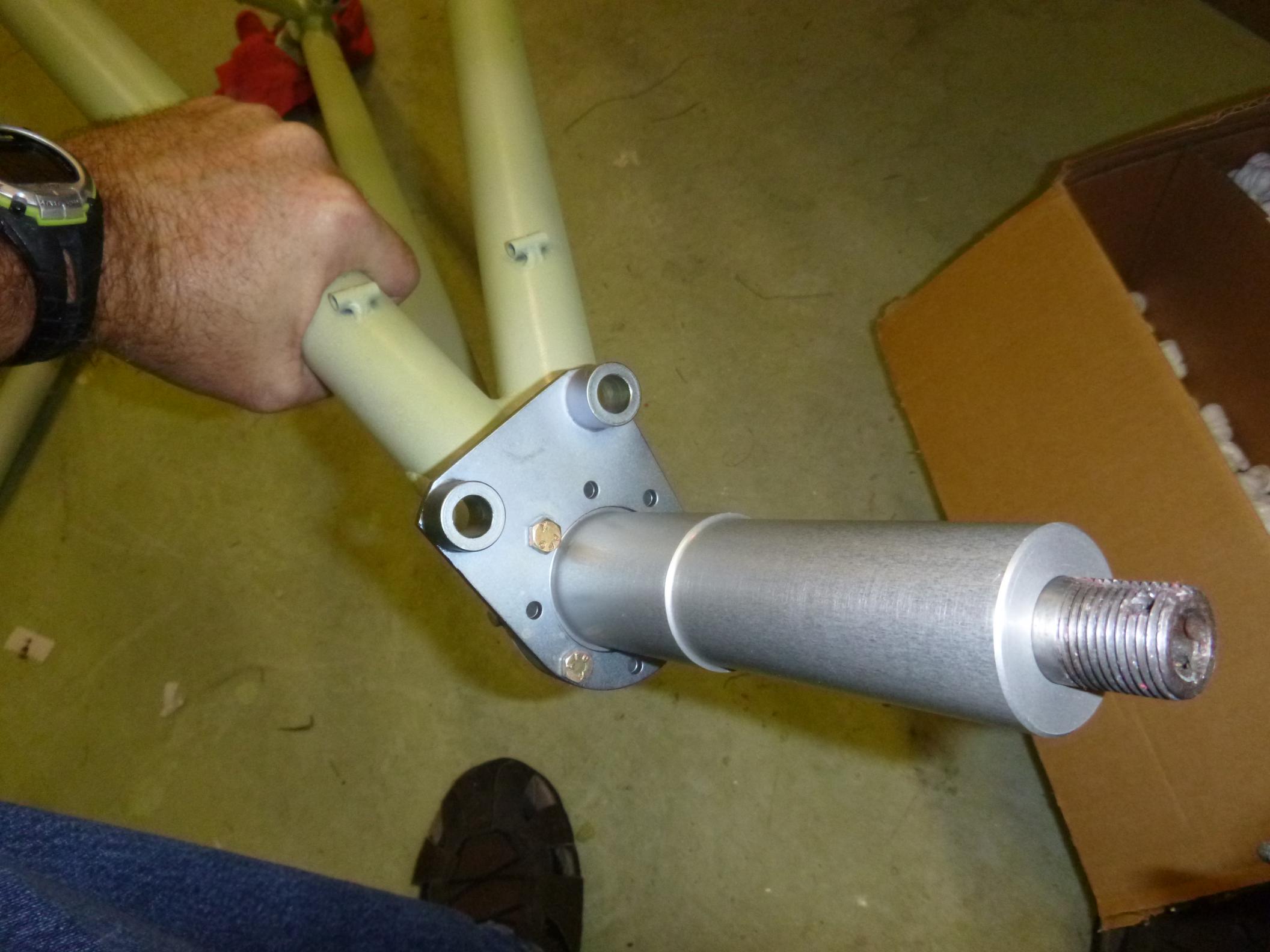

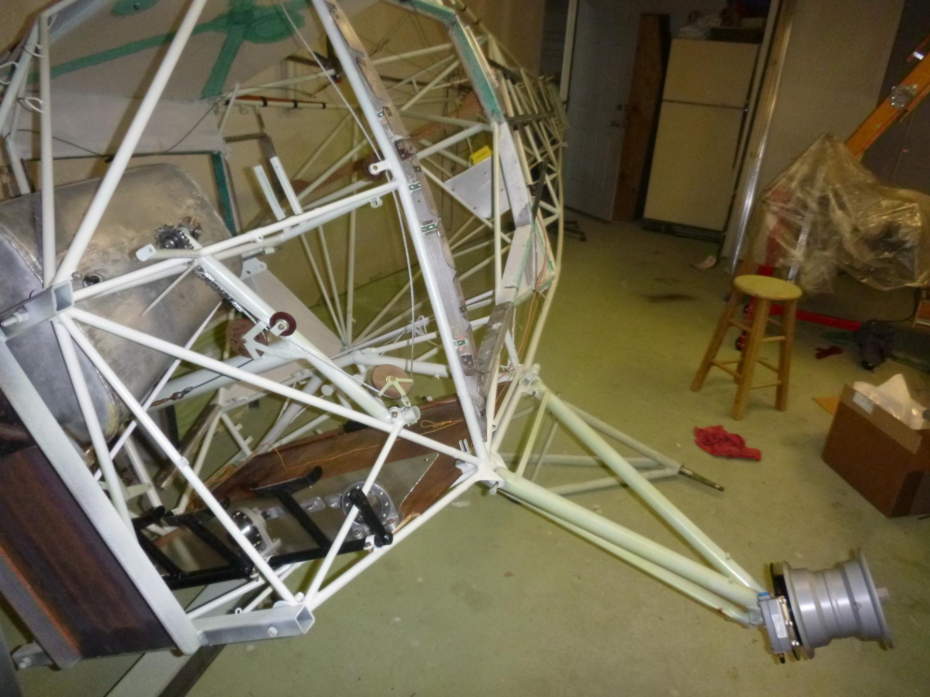

          Yes, I bought a kit from Grove that included new wheels, slave cylinders, axle adapter, and adapter plate for $1289 in Oct 2013.
          I spent a total of $2230 on the new wheels and brakes.
          The third pic below shows the Grove axle adapter. It's mounted incorrectly in the pic, but it shows the part.
          The fifth pic shows the wheel, slave cylinder and the master cylinders in the cabin on the floor boards.

              I was the first to do the grove brakes Tim used my paper work to do his.The file with all the paper work is on the teck section of this site.My 337 was field approved in the Nashville FSDO.Use it for data.If I did it again i would use groves master cylinders and the stock pedals they will bolt to the bracket that the first pully is in and the pedal and are pull type cylinders.The only thing that i don't like is they will make 600 PSI and will give you very strong brakes,with the scott cylinders they make 300PSI and you still have lots of brakes and can lift the tail braking but they are not as touchy.

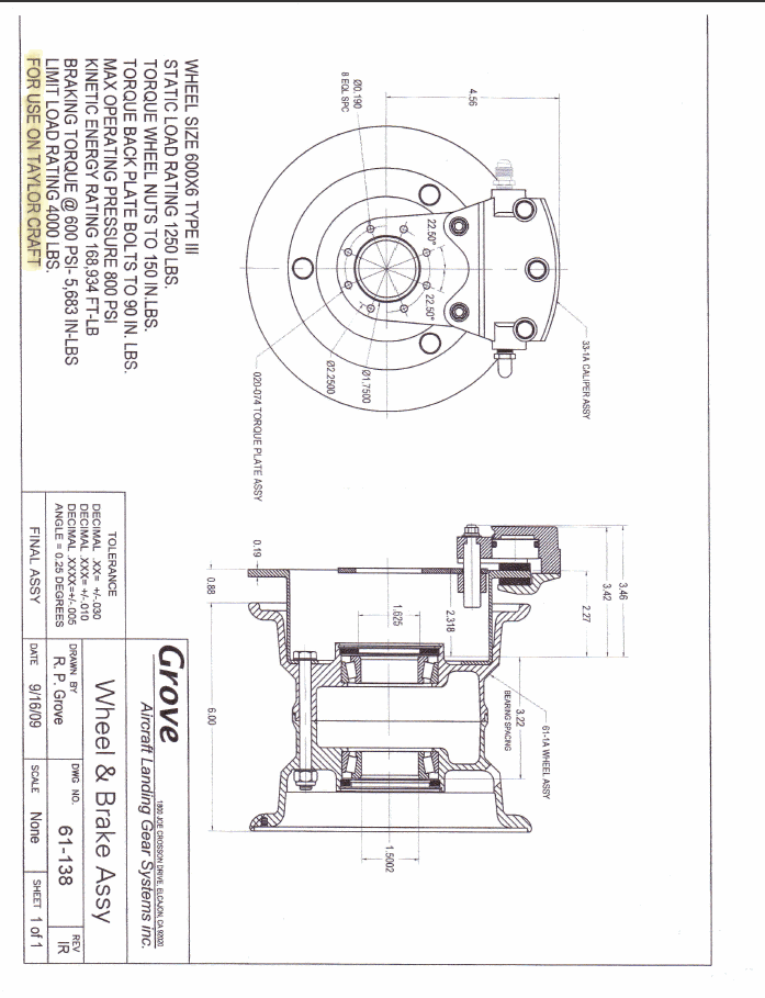

                    Has anyone done any calculations on the coefficient of friction and shear forces acting on the bolts that hold the torque plate on?
                        Not sure what you're looking for but Grove has some design specs on the install prints in Post #5 above. I bet the tire would slip before some hardware lets go.
                          My concern was that the bolts holding the torque plate on could shear under heavy braking, but apparently that isn't a problem. Still it would be nice to know how far you are from the limit load factor.
                            That might depend on the particular plane's momentum, tire radius, contact patch, and type of braking surface? I'm sure Grove has figured it out. In my experience depending on tire pressure and bead mounting the tire yields before the brakes on small aircraft. Then there's always the nose over to save the brakes for whatever good that does.
