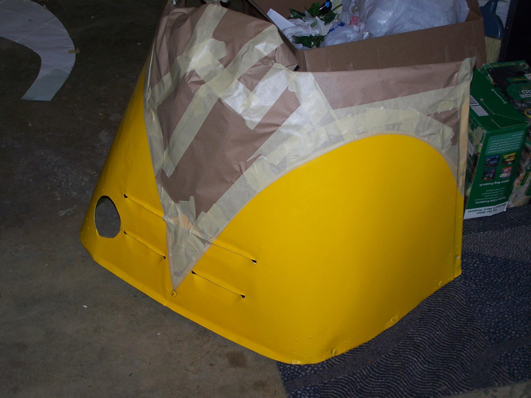

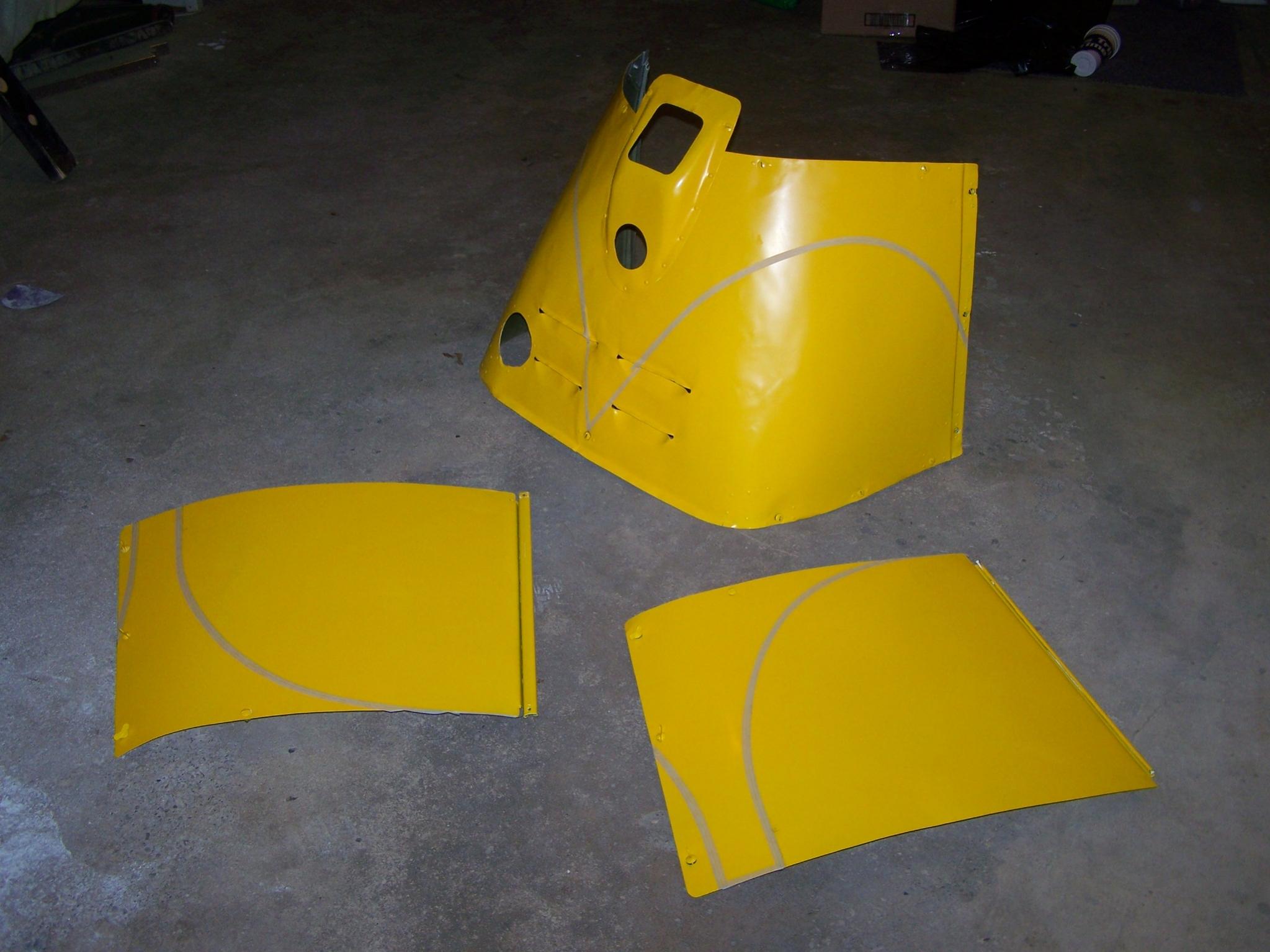

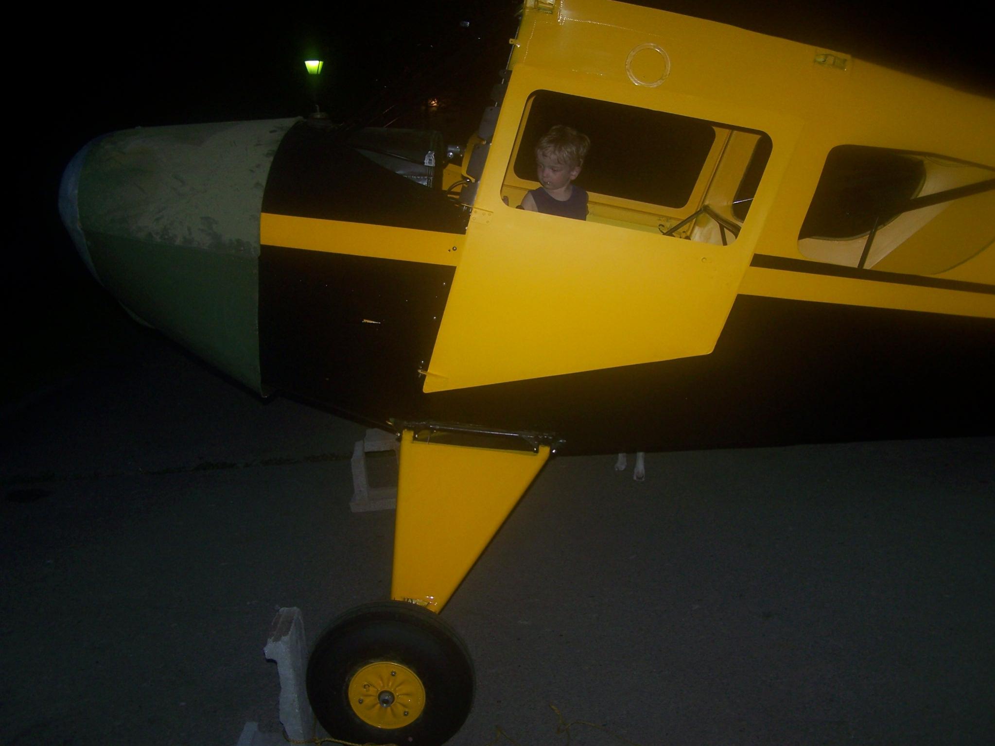

    Hey Tim, trying to remember here, I assembled all of the unpainted cowels to the unpainted boot cowel and assembled that to the yellow painted fuselage and ran a chalk line from the tail to the grills. That helped get the stripes at right height on fuselage. That was a "hey looks good there". Then measured for the other side. A constant was windshield fairing for the top of the black stripe. Painted fuselage on rotatory. For the cowels, I finished the coot cowel through the stripe first. I again reassembled everything just to get that stripe. Finished boot cowel. I then put the yellow painted cowels on the finished boot cowel and used the stripe and the bottom zeus fastner under the cowel that attaches to the heat box as reference points. My dad drew a big circle on cardboard paper and we taped it up, and drew on the line. As far as how big to make the circle, we just eyeballed that and said looks good. drew on a line, removed the template and flipped to the other side, repeated. Can't remember what we used as a circle template...but you can see the template on the floor in the pic of the taped bottom cowl. Make sure to fit your windshield fairing to line up your stripes. We used chalk lines down the fuselage to keep things straight. I made sure that the entire nose bowel stayed yellow for simplicity. I also did purchase good tape for the automotive paint store for masking the curves.

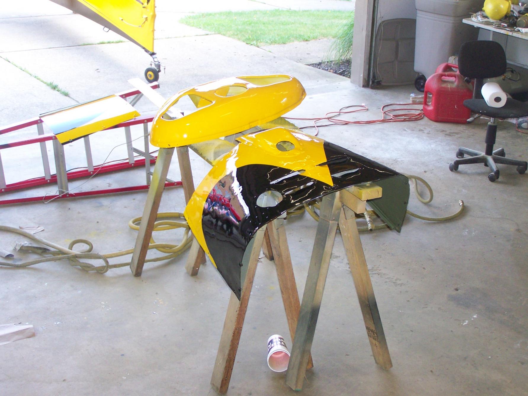

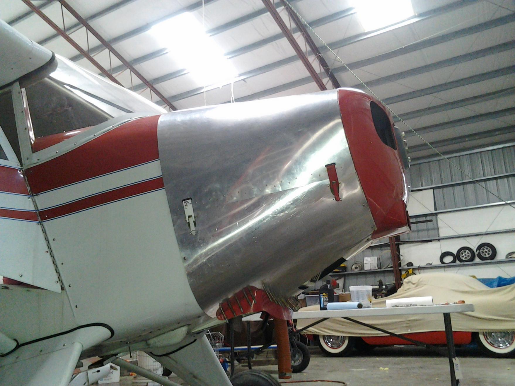

      Here's a pacer cowling i just completed, built from scratch. I still need to put the blue pin stripes on.
        Re: How do I paint my fuselage?

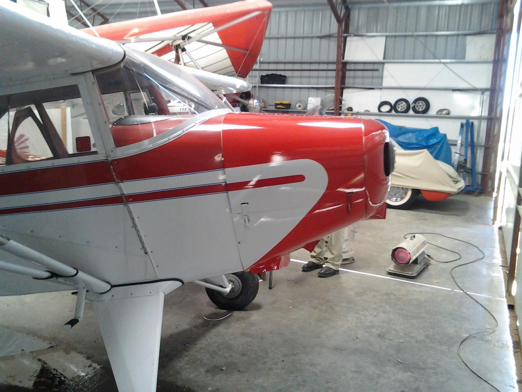

        Years ago I spoke with a painter who worked at the factory just after the war. He told me management didn't really care about the dividing line on the fuselage. They ran the tape from front to back and one guy held it while the other pushed it down. Sometimes it ran to the base of the fin post, sometimes part way up between the bottom of the fuselage and the stab. The only thing that mattered was that both sides of the same plane be the same! He also said that if the division did NOT go to the lower rear corner of the fuselage the rudder would either have a curve down or could go straight back (again. making sure it was the same on both sides). The same was true for the cowl. The "Deluxe curve" wasn't the same every time.
        That explained why do many photos I had showed it different ways. It was done how the painter felt that day! The same went for the second color on the wing leading edge. Sometimes the tip curved back, sometimes the line went straight to the end, sometimes it curved all the way back to the trailing edge at the rib outboard of the aileron, and sometimes, but not often, they just left the second color off of the wings. Just depended on how the painter felt and if the wings were ready to paint trim before it was time to mount them.
        What this means is, however you do it (within reason) no one can say it isn't right.........but someone always will. ;-)
        By the way, REALLY nice model! And I agree, the slightly cream color looks a lot better than the "snow white". But that could be just us.

          Nice looking Pacer, Kevin!!
