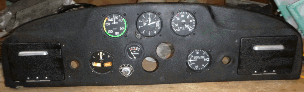

I printed them with a small pilot hole where the mounting screws go.
To mount them yesterday, I drilled the pilot hole out to 5/64" (I think) and used PK screws (#4 x 1/4") to mount them.
The doors from David W. didn't have holes for mounting the handles. But luckily, I had an original door. So I got the handle location from that old door and drilled the new .125" holes (a bit of clearance for the PK screws).
I primed them and painted them silver. I wasn't sure how the paint would stick to the plastic. But a day after painting them, I was handling them vigorously during the mounting process. And the paint held up fine
