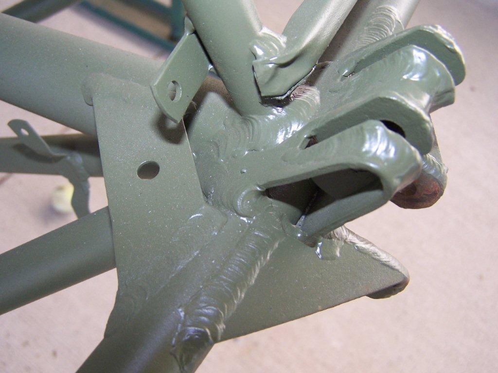

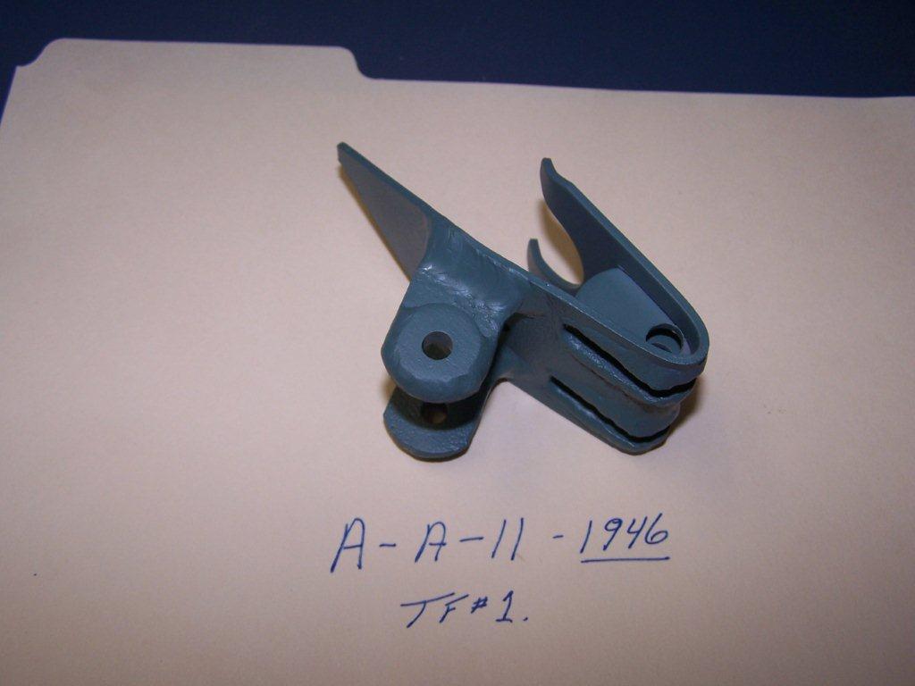

        Here are a couple of pix to help visualize the strut attach fitting which are at the heart of the discussion.

          Re: Strut fitting A-A11 - Factory support???
          Thanks for the pics and contact info Dick!
