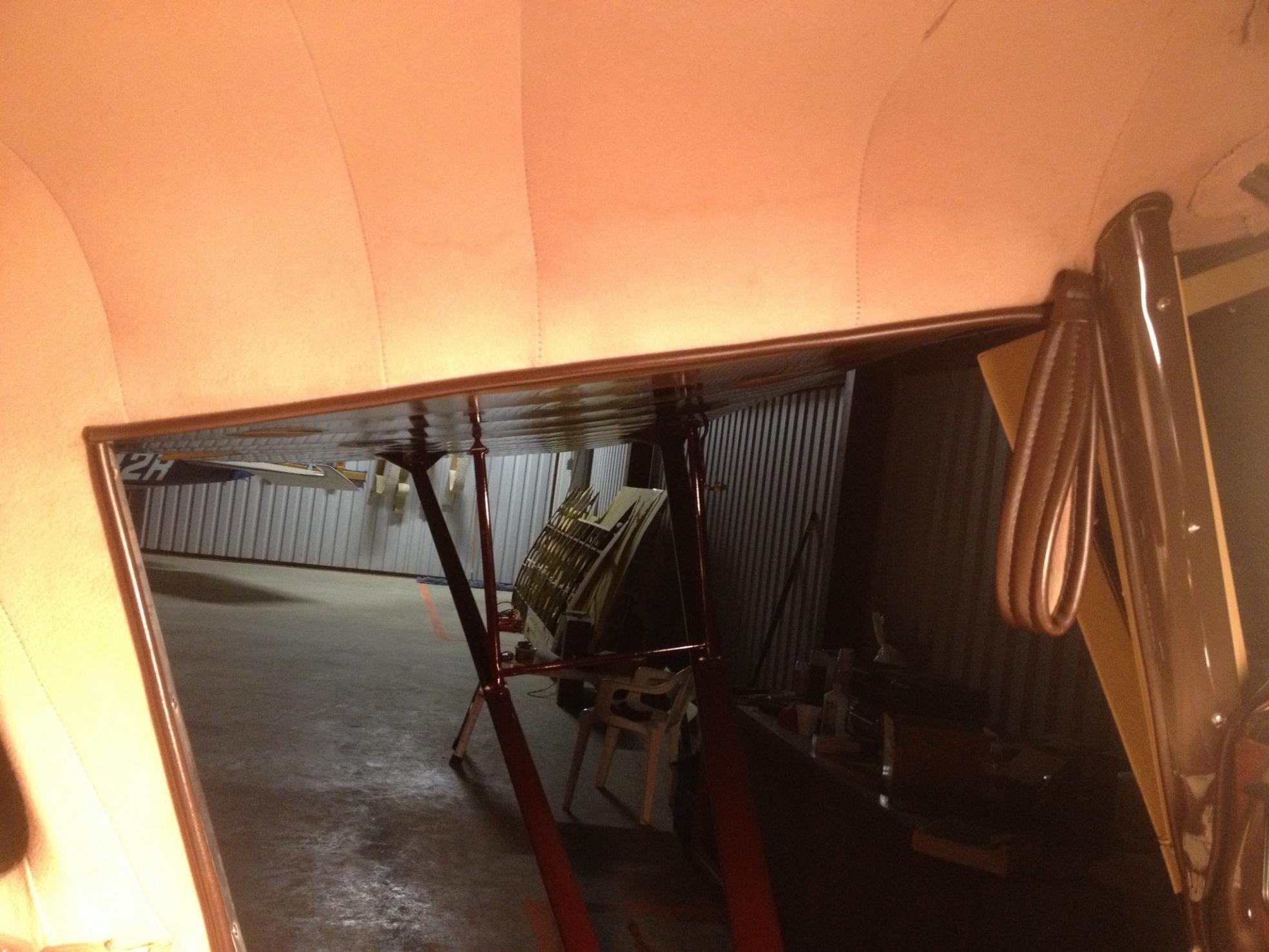

            Hope you have the headliner installed by now but thought this picture of how my 41 is done might help. It has welting attached under the metal strips which are screwed to the wood door frames to finish out the headliner edges.
