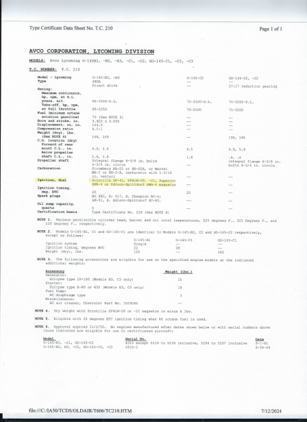

    Need manufacturer name and part numbers for magnetos used on Lycoming O-145 65 hp engine used on Taylorcraft BL65
ID:	196122 Per TCDS E-210 Lycoming 0-145b1, b2
    Scintilla SF-4L, SF4LN-20, -21, Superior SMA-4 or Edison-Splitdorf RMA-4
      Slick may also have something approved under a STC.
