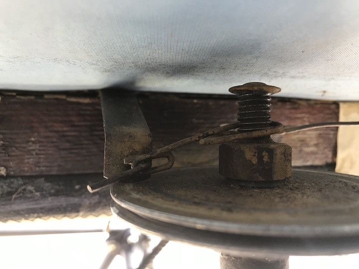

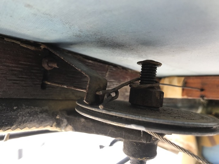

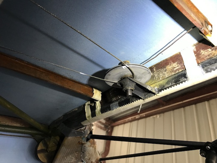

    Today I had need to pull back the headliner in my '41 Deluxe. I thought I would take the opportunity to repair the "up-down" indicator which hasn't worked since I bought the plane back in 2014. Before getting into this, I reviewed Rob Lees' and Buell Powell's posts that described how they refurbished their indicators. I was excited about getting mine repaired.
    I compared my indicator to that of Rob and Buell's, but there's little comparison. The apparatus that drives the left and right movement is not the same. While Rob and Buell's indicator employs rigid structural components that are fixed to the cross member above the windscreen, mine uses a heavy wire attached to the stringer over the passenger's head that is eventually connected to the screw above the pulley.
    Here are a few photos of what I have

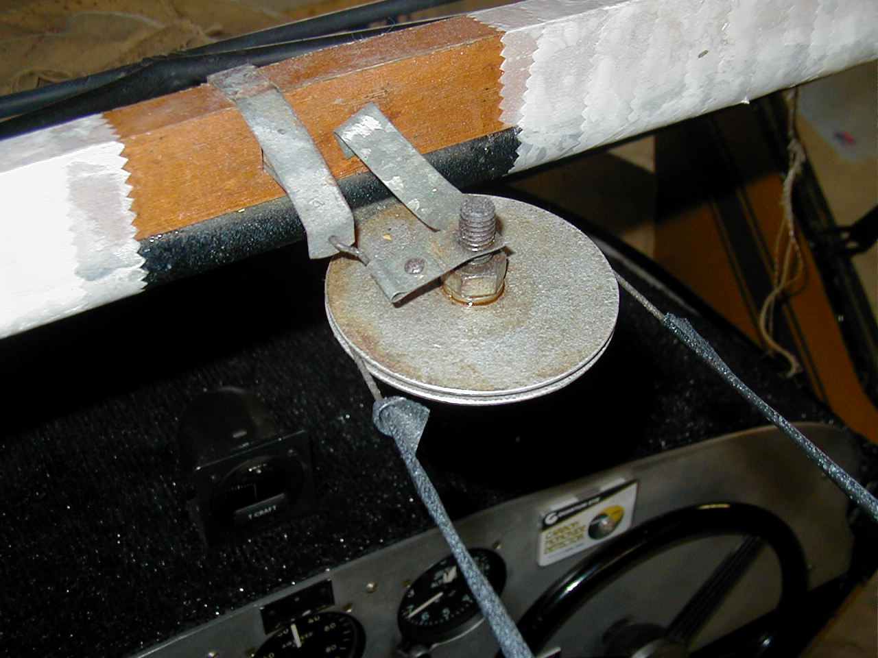

    Now, see below. I found this photo on the forum. It is somewhat similar to what I have, but not the same.
    Image result for taylorcraft trim indicator
    Does anyone know if the three images on the top are the original set up?

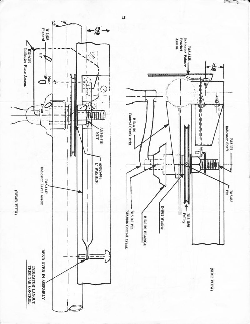

      I did up a set of drawings of the original mechanism parts. From the photos I can see why yours didn't work. Just a bit too Mickey Mouse to work for long. The original was "Rube Goldberg" but will work for a long time if you don't drive it past the limits.

        Sorry, wrong drawing.
          I guess the headliner blocking the trim parts complicates things. With a skylight it's visible. Marking the cable as it travels fore and aft would suffice, or like Piper, have a tab the cable moves as an indicator. Maybe the later trims with a full size tab are critical, but with my partial span tab it does't over control the elevator at any position.

            I just fixed it. It must be an original design. Hank's description of the system being too Mickey Mouse is accurate.
            I'll keep running it in its original configuration until I get tired of fooling with it. Then, I'll look into installing something more durable like the ones described in other posts.
            Thanks again.
            Peter

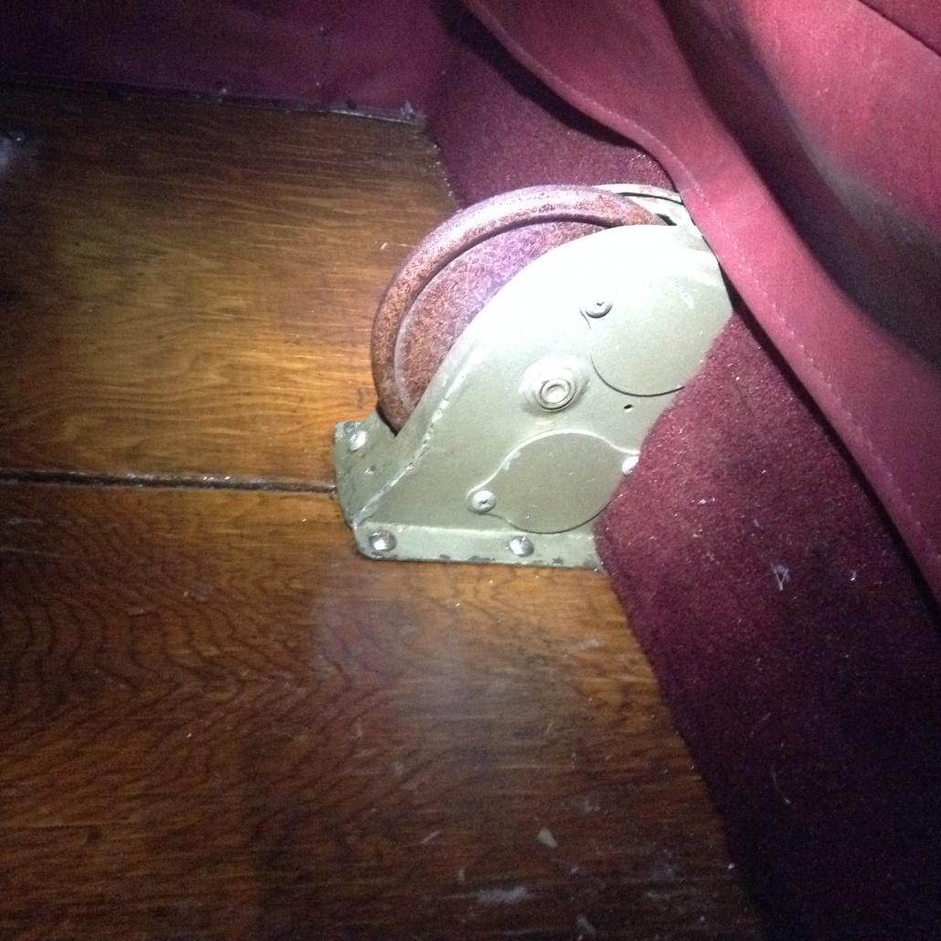

ID:	181851FWIW........this might be another option. My '40 has a trim off a Cessna 140 (gasp)! Not original but it works flawlessly. Cables routed straight back thru a couple short steel tube ferrules. I still much prefer the flippers on my '38 for both function and ease of use.
