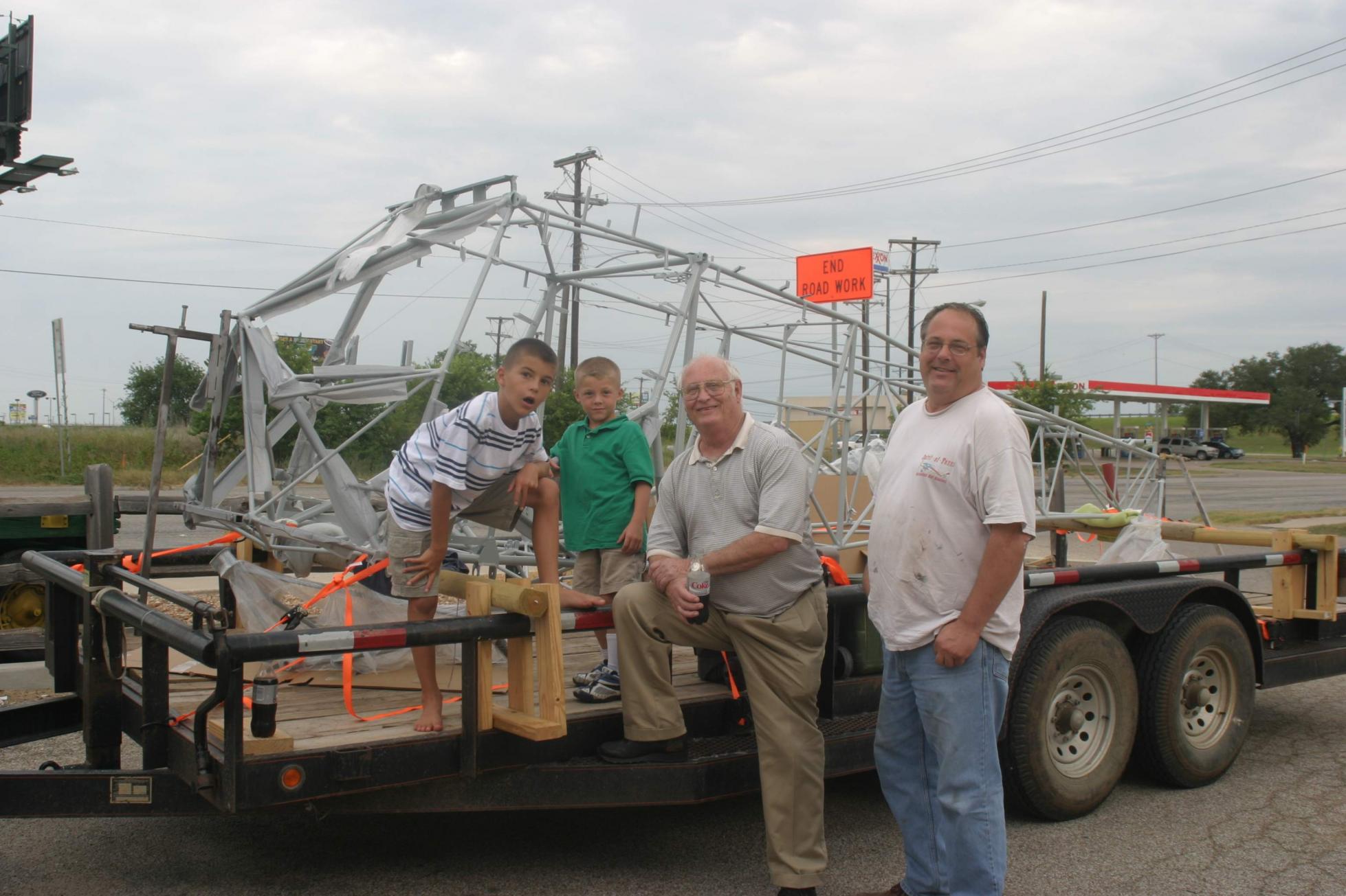

                          Dad and I and the two boys drove to Corpus Christi Monday to pick up the fuselage from the powder-coat shop. Those guys down there do great work (Protective Coatings Corpus Christi, TX).
                          Reassembly has begun.
                          Here is a picture of the crew and 6658N taking a break on our way home.
