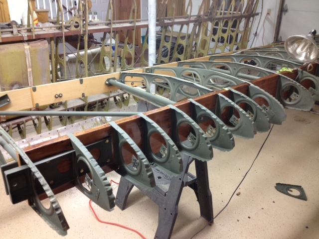

                    What has happened to all these 15's that were being rebuilt ?
                      Re: ATC-3A3 & Support
                      At Least 1 of them is in process...
                        Looks great. Nice job !
