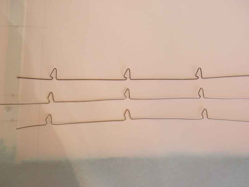

I have three examples of wire available.
The first is a couple hundred feet of NOS Taylorcraft wire (THANKS drude!!!) that I intend to use for this recover job. The second is the wire of unknown origin from the previous recover in 1991. This wire has held the fabric well for the last 20 years, and I was careful taking it off. I have almost enough to use if needed as a backup. Finally, I ordered one roll of Aircraft Spruce's Martin Wire. I was curious of the reported "worn machine" that their supplier used had really been repaired. The diameters are: NOS .0322", Old .0330", AS .0332". The old wire seems to be stainless while both the NOS and the AS wires seems to be a plain steel.

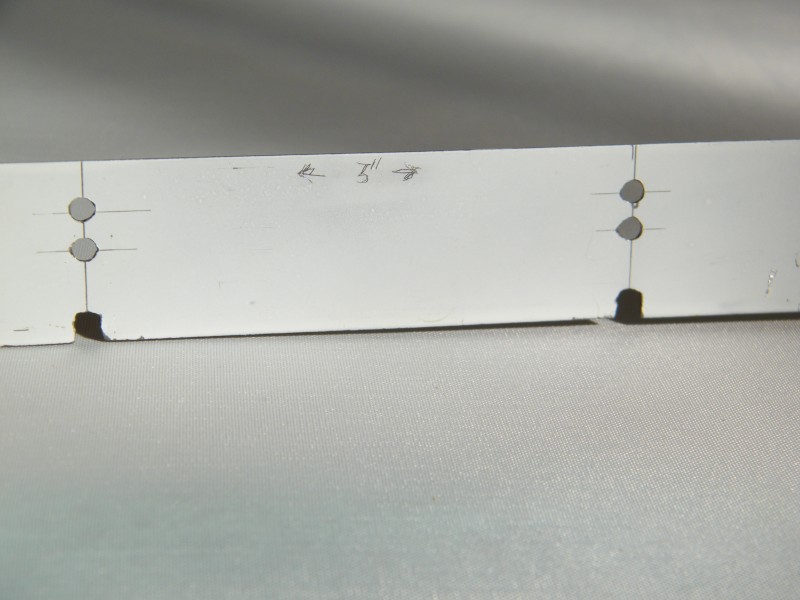

To see how the wire layed on a rib, I drilled a piece of thin steel with 1/8" holes on 3" centres so that I could get uncluttered pictures. Besides, my ribs are already covered and I don't really want to play with them at this point. I DID mesure the ribs and the holes are 1/8" on 3" centers as closely as I can measure.

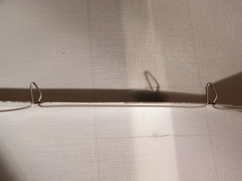

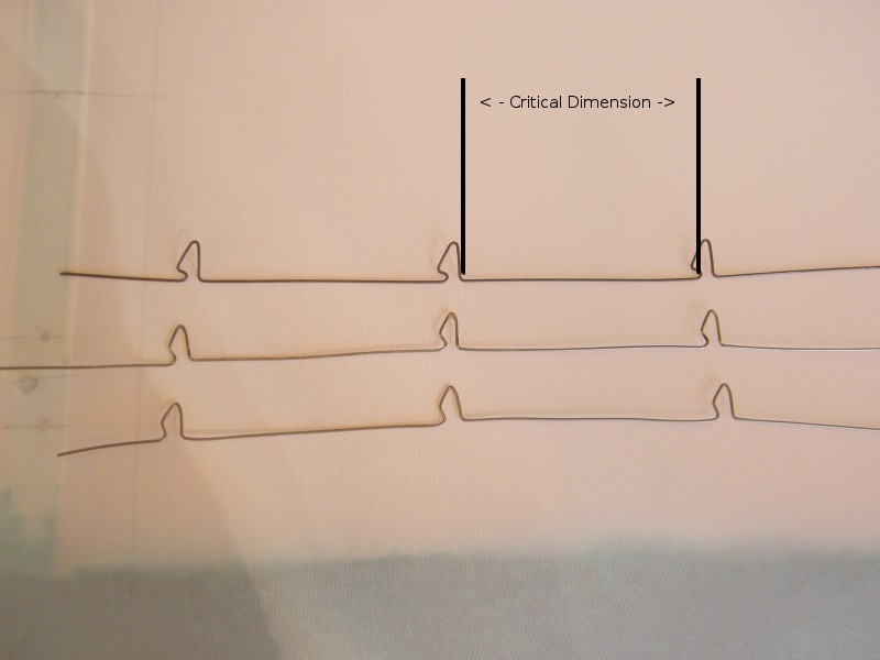

The critical dimension of the wire is from the front of the barb that locks into the hole in the rib (The right-hand barb below) up to the square back of the next barb that locks that previous barb in place with no possibility of backing out (The center barb in the picture below). This dimension should be 3" - the 1/8" hole size, or 2 7/8" which is 2.875"
My three wires measure:
NOS: 2.830"
Old: 2.875"
AS: 2.885"
I THINK that my old wire is right on at 2.875 because it was installed in the holes for 20 years. The NOS wire takes a little work to fit in the jig that I made, but the bending of the barb for insertion into the 1/8" hole seems to relax it out to the proper dimension. The AS wire is just a few thousandths long. This isn't enough to require the Z-Bend referenced in other posts, but does make the wire just a bit looser in the holes than the other two wires. So it seems that AS has fixed whatever problem referenced in those earlier posts about wire so loose that it needed a Z-Bend! Good for them.

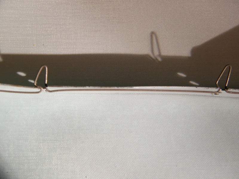

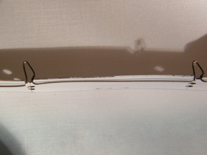

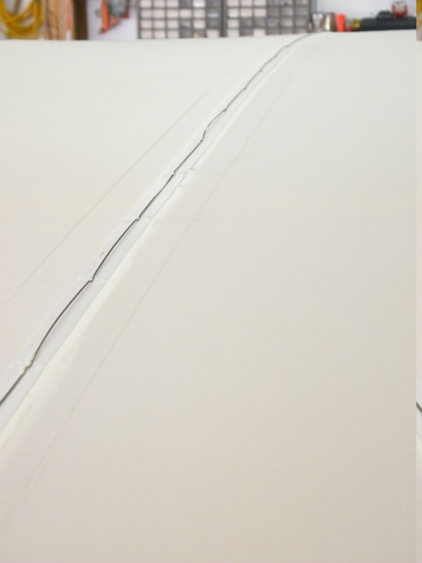

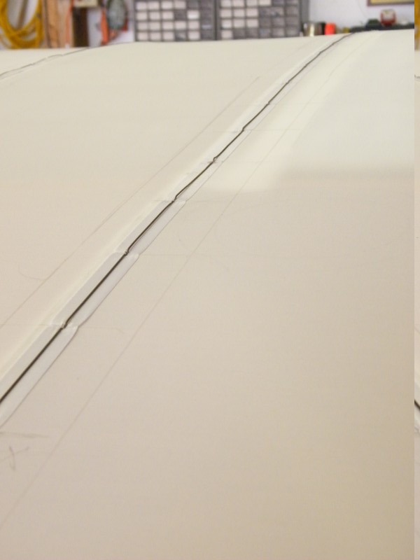

I put each of the wires into my jig. All three wires layed straight between holes and were tight enough that I could use any of the three. Although they all fit fairly well, the AS wire moves in the hole just a bit making it seem loose. The AS wire could be used, but it seems marginal without a little tightening. The funny thing is that putting the AS wire in the holes, bent its barb enough that its shape is virtually identical to my old wire. However, it is just a bit looser as mentioned above. For those ribs that have had wires ripped out and holes expanded, the AS wire is least desirable. The NOS wire will stay tighter in slightly enlarged holes and the looser AS wire will be even sloppier in such enlarged holes. Fortunately almost all of my ribs have nice clean round holes.
First, the NOS wire:
Next, my old re-usable wire:
Finally, the Aircraft Spruce wire:
So, in summary, I intend to use the NOS wire. It is tighter than the other two. There is one concern with re-using my old wire. It seems that bending and unbending the barbs by installing and then removing, tends to work-harden the wire in the bends. I had two barbs break as I bent them to fit in my jig. Neither of the other two wires showed any tendency to break when bending. If I were to use the AS wire, I would probably spend two or three hours with a long-nosed pliers tightening the angles that make up the barb to more closely match the NOS wire.
However, the Aircraft Spruce wire does seem, at least, usable.
