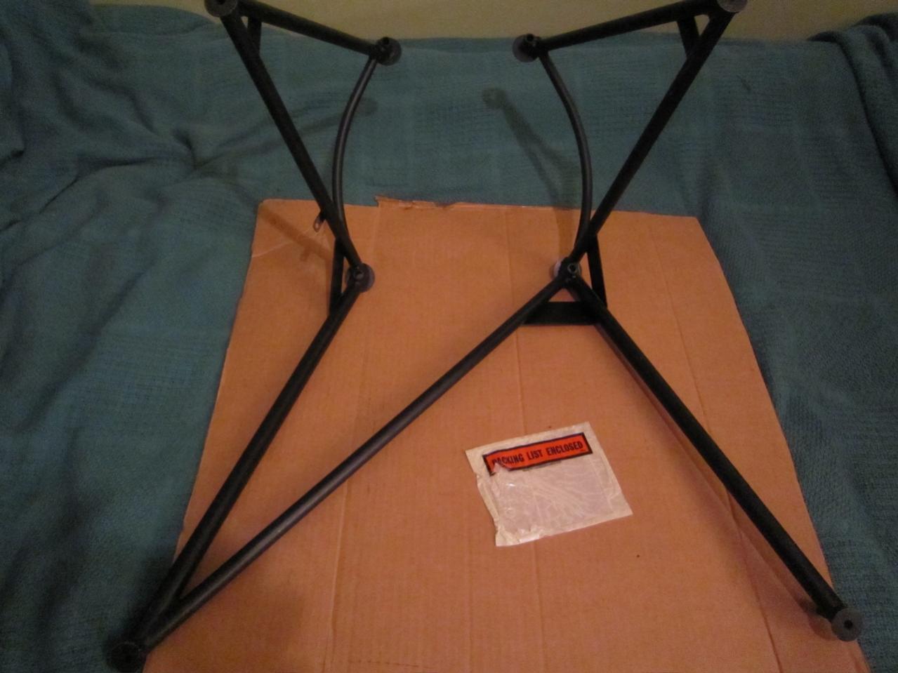

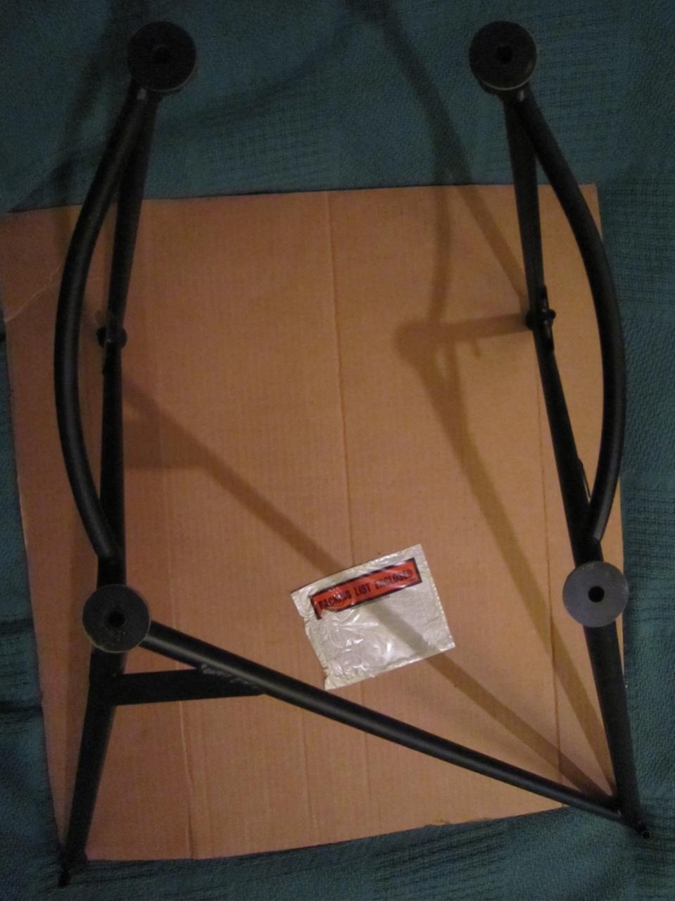

    I am glad to report I found a motor mount for the F-19, a brand new one in the box from the Taylorcraft factory, was collecting dust on a gentleman's shelf. Now I just need a nose bowl.
