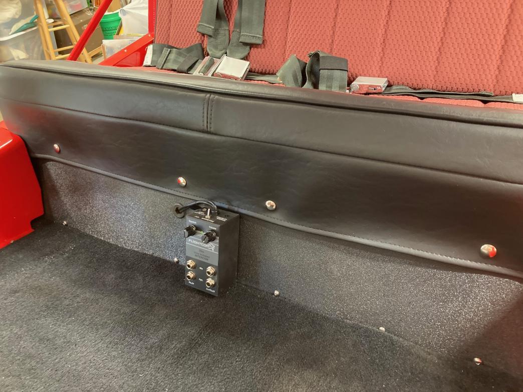

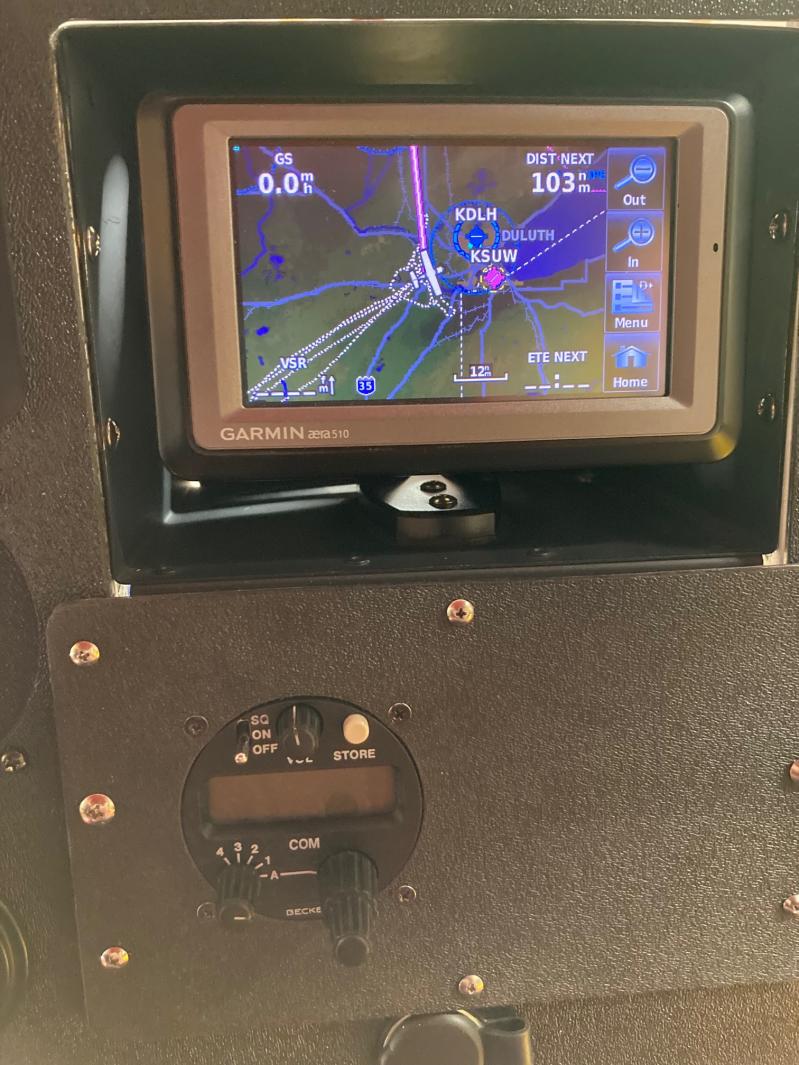

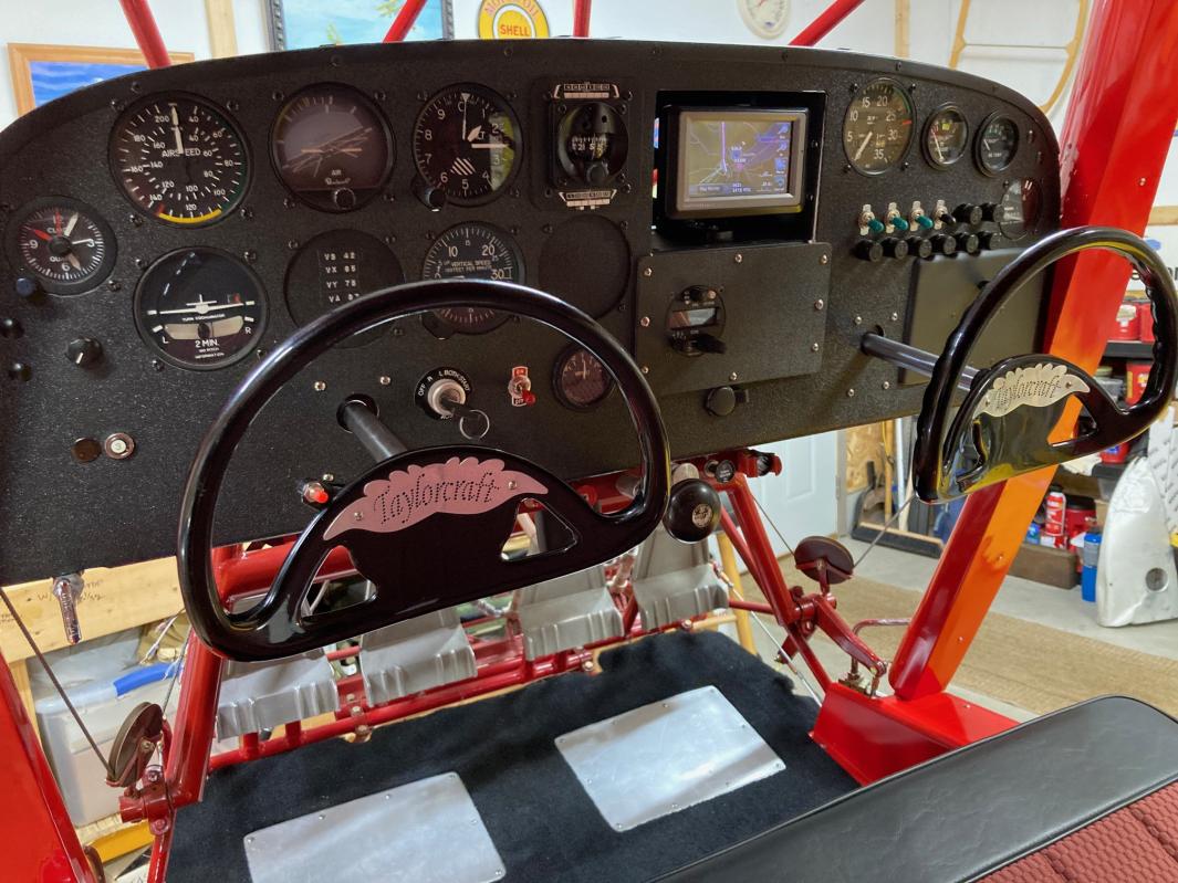

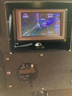

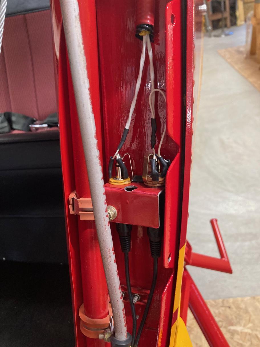

    Radio GPS.jpg Seat bottom.jpg Radio wiring.jpg panel final.jpg The F21A I have came with radios and VOR that didnt work, so I removed all of them and their boxes. As a simple solution to good com and navigation I fabbed a new aluminum box with a power plug and installed a Garmin and a Becker radio below it. A Flightcom was added between the seats on the floor and the wiring was routed behind the kick plate and connected to the radio halfway up the left side of the cockpit behind the fairing. It did cleanup the panel and the wiring as desired. The PTT was previously explained in an earlier post.
