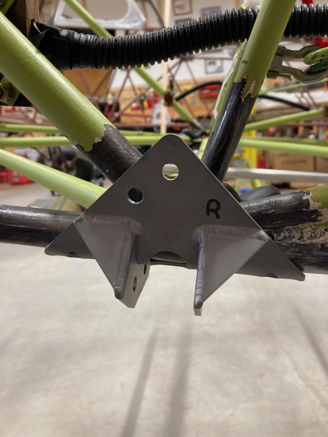

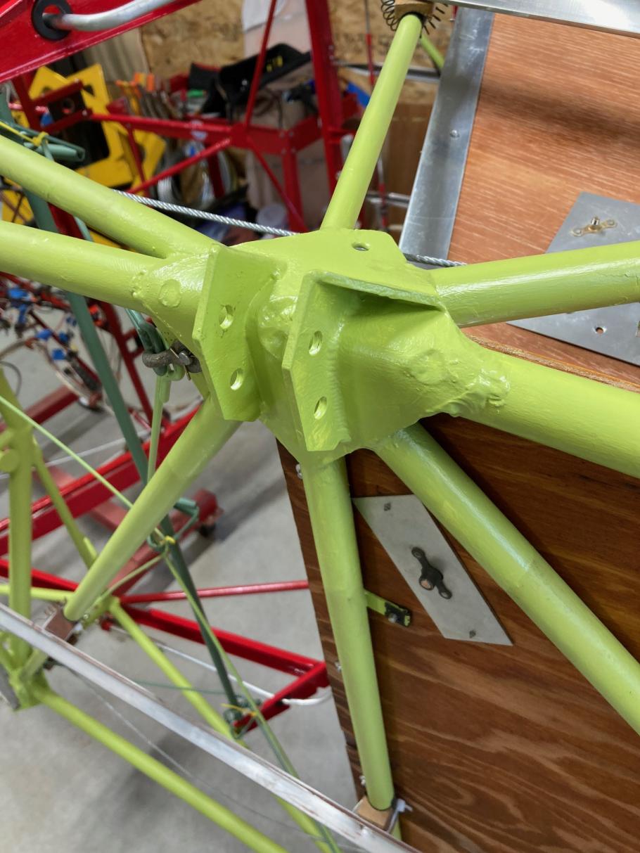

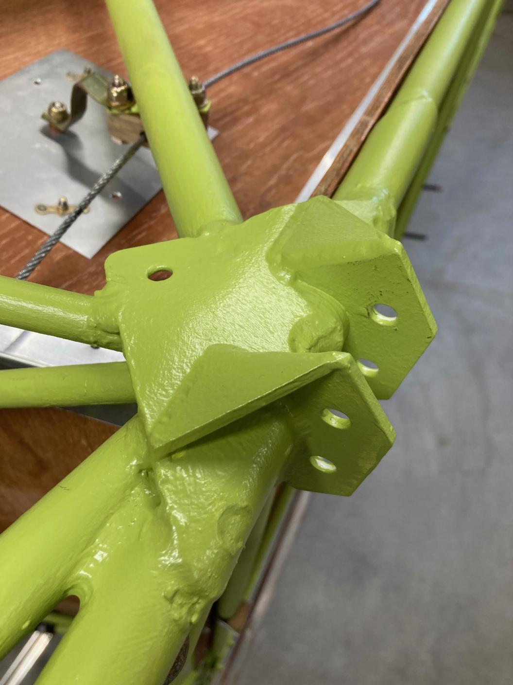

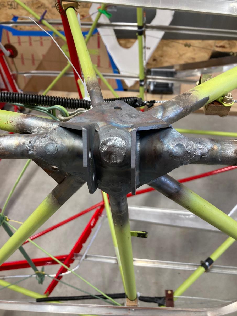

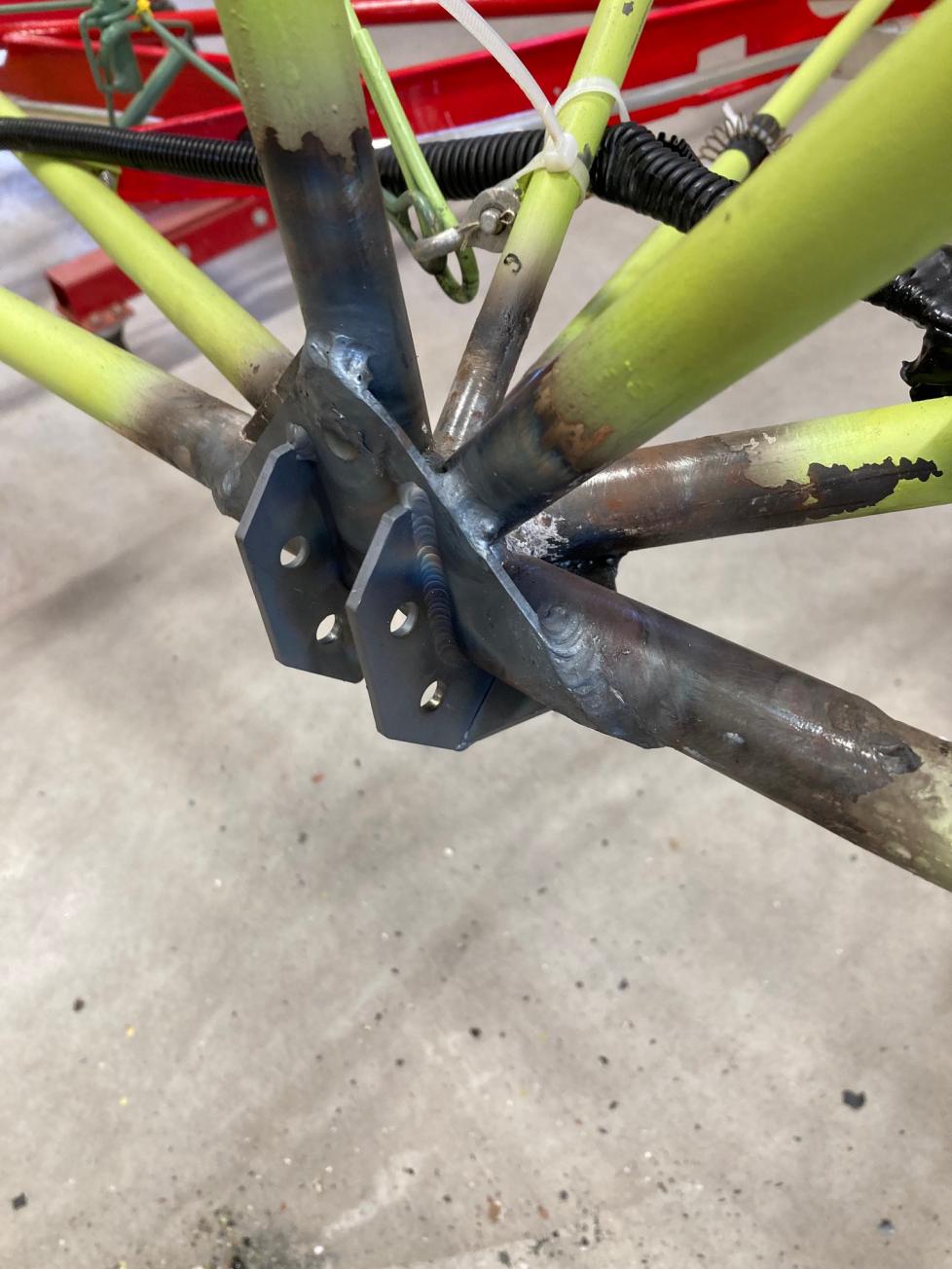

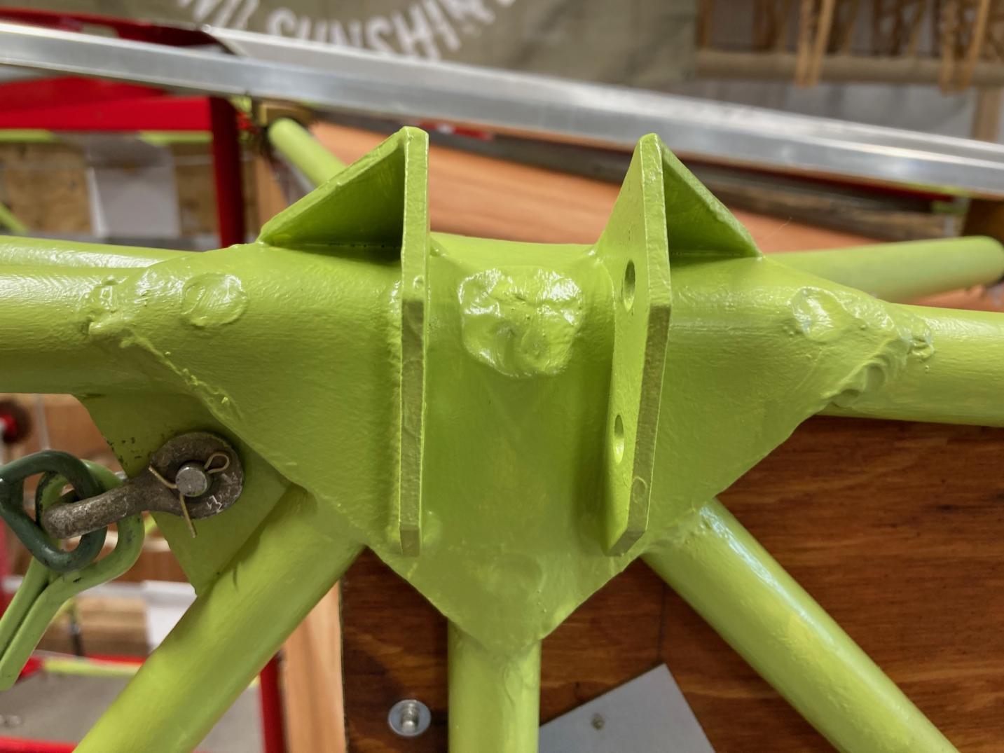

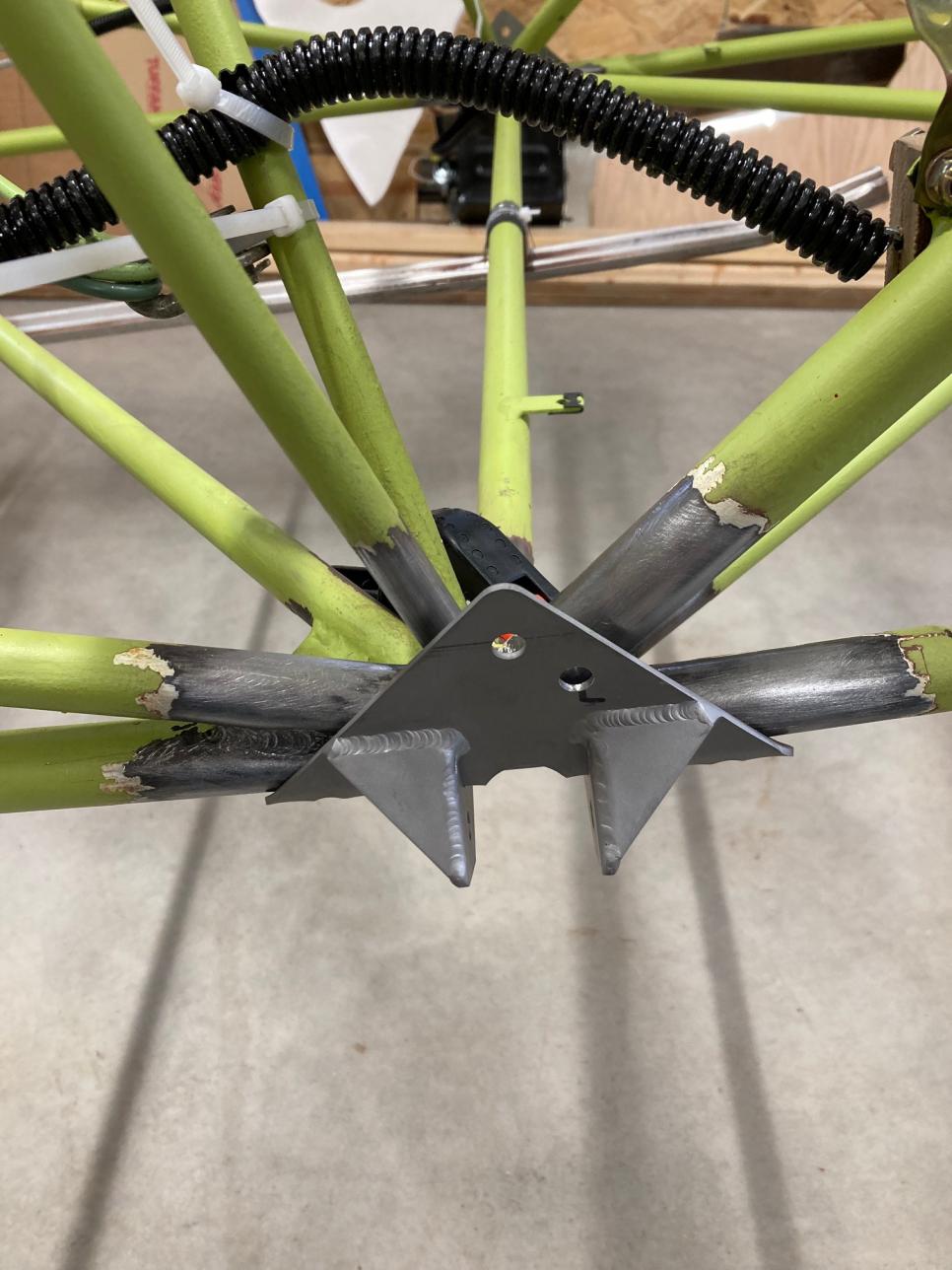

    Since the F21A can be setup to be a float plane I decided to install welded on float fittings during the rebuild. With nothing available I used a local set fabbed out of 4130 for Piper Super Cubs. The fit was easily adapted by applying a little heat to the fitting to form it to the fuselage prior to welding. Click image for larger version
