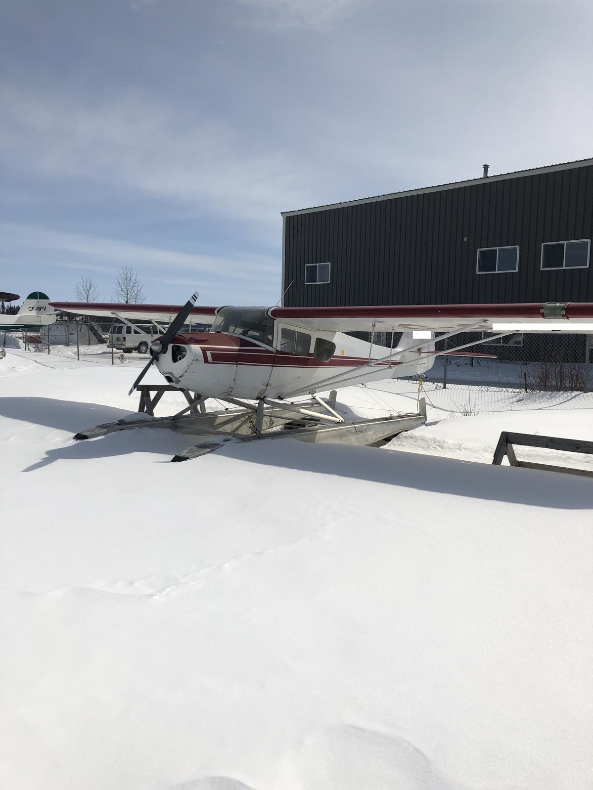

    I'm new to the forum and looking for your wisdom. I am a fairly new pilot located in western Canada. Currently I own a 172 with a couple buddies but am looking to buy something on floats so I can start flying to the family cabin. That said I got a call the other day from my cousins wife, her father passed away a couple years back and he was an avid bush pilot. They are now looking to sell his plane. Which drum roll...... is a 1976 F-19 with Aqua 1500's. So with the all the research I've done looks like an awesome little plane and was cared for meticulously why he was alive. However it was pulled out of the water when he fell sick in 2012 and has sat in dry dock ever since. Plane has 1500TT on original engine and prop is newer with 875spoh. All cylinders have been replaced in the last 500hrs. So with that all said I firmly believe this is a project plane it will need extensive engine work and probably all new fabric. So my questions for you pros are:
    1) What is it worth as it sits? (Just what the floats are worth???)
    2) If it had new fabric and an overhauled engine what would it be worth with a current C of A?
    3) What are the key things outside of fabric and engine that should be inspected closely when I go to look at it? IE. under side of tubing at tail and end of fuselage?
    4) What is it worth to have a plane re-skined via 3rd party?
    5) Any other insight would be appreciated.
    At the end of the day I don't mind a project, but when I'm done with it, I can't have more into it than its worth. I should note my uncle is a retired A&P mechanic and is willing to help me restore this plane. So I will have lots of expertise on my side when I go to look at the plane and through the restoration process. Picture attached below. Also when commenting if you let me know US or CDN dollars it would be much appreciated. 30% spread right now on currency.

                That's a nice looking bird in that pictue!!
