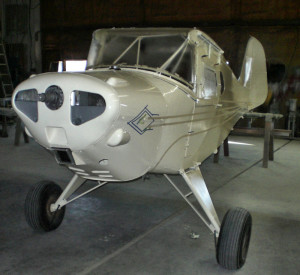

        Note that the C-150 exhaust usually requires cowl bumps to fit under the forward bottom cowl. They are available here: http://www.crosswindsstol.com/index.html
        Pic:
