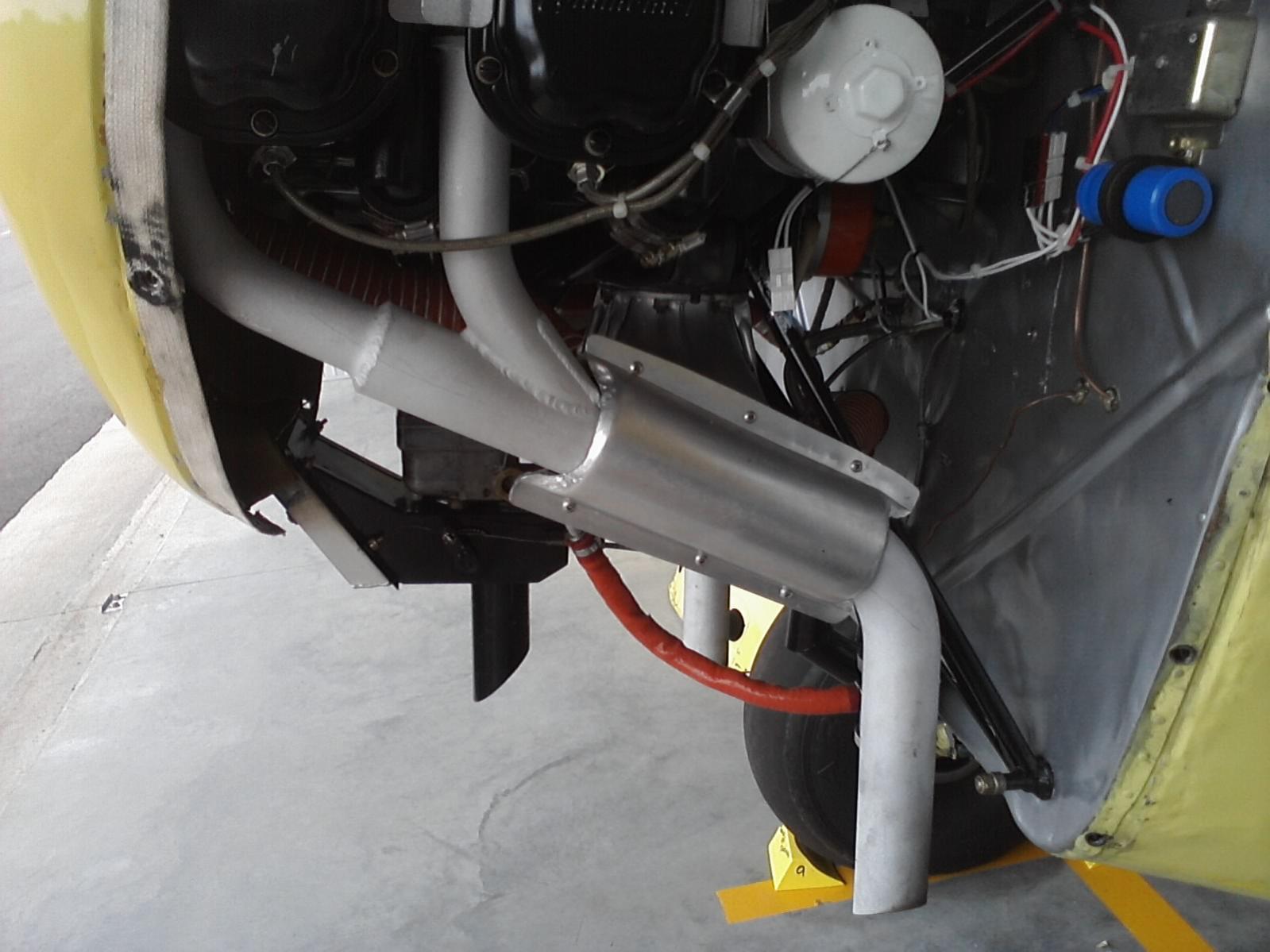

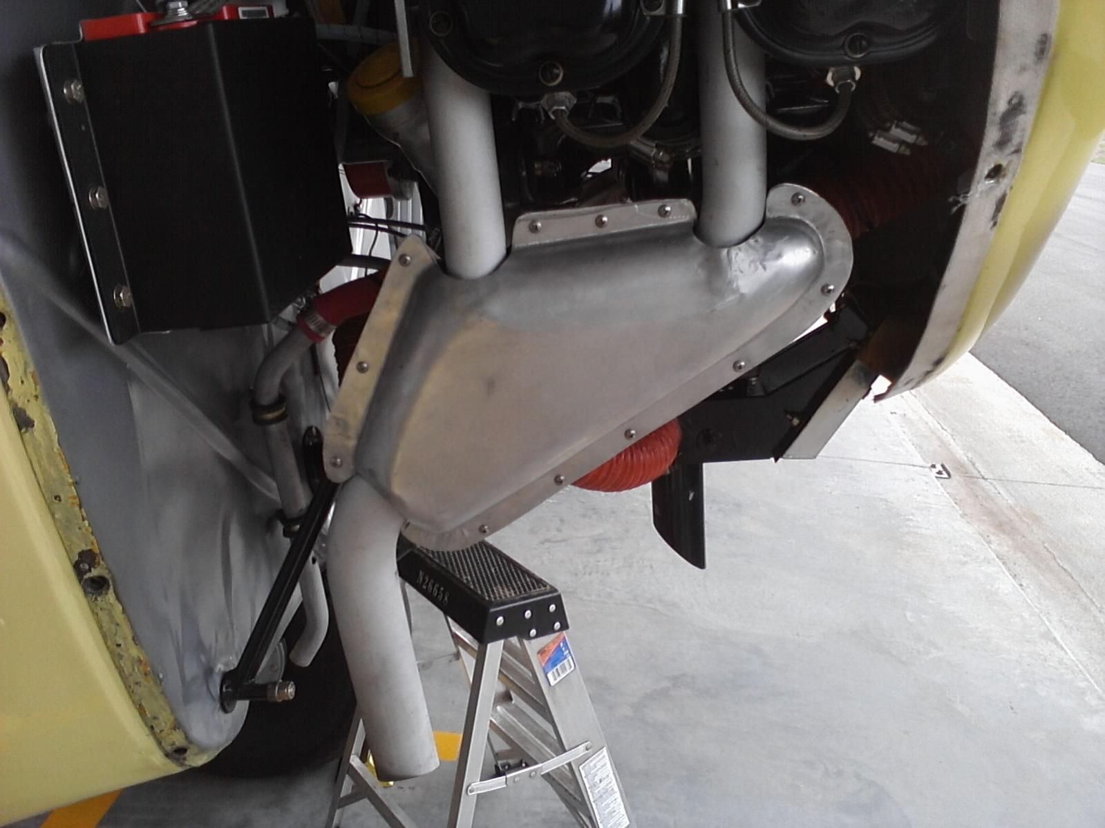

          There's one here for the F-19 (http://www.taylorcraft.org/resources.html). I have a set F/A on my BC12D-4-85 as well. Depending on cowl and header shape they may or may not need a cowl bump (mine doesn't due to re-shaped header pipes). Charly Center has made bumps before (http://www.crosswindsstol.com). Edit: See an example of cowl bumps in last picture under "Photos > Builds".

            Tim I remember looking at the Hanlin walker exhaust when i did my c85 there are two one is the Cessna and the other is Aeronca I think the Aeronca fits tighter to the engine and is the one that does not need the cowl bumps.I did the luscombe with Terrys paper work

                    Atlee Dodge makes a defroster kit I've had in a few planes that provides a firewall heat valve with two fixed 1" outlets plus the main 2" as usual. The 1" hoses can be routed up and fixed to the panel cover with individual outlets. They also make (as do others) a three-way "Y" shaped 2" duct adapter to split the secondary heater inlet into two hoses for a similar fixed application below the screen.
                    With the C-150 mufflers there's an option to add additional outlets to the heat muffs with 2" flanged and riveted duct adapters, or add Y adapters to split the single outlet to feed two cockpit heat sources. Lots of choices as required. The advantage of the C-150 system for heat is the relatively large surface area of both mufflers...the larger the heated area the more heat can be extracted. Having lots of inlet air volume is important as well. I'm comfortable to -20F in my Taylorcraft but that's my limit for small Continentals in winter.
