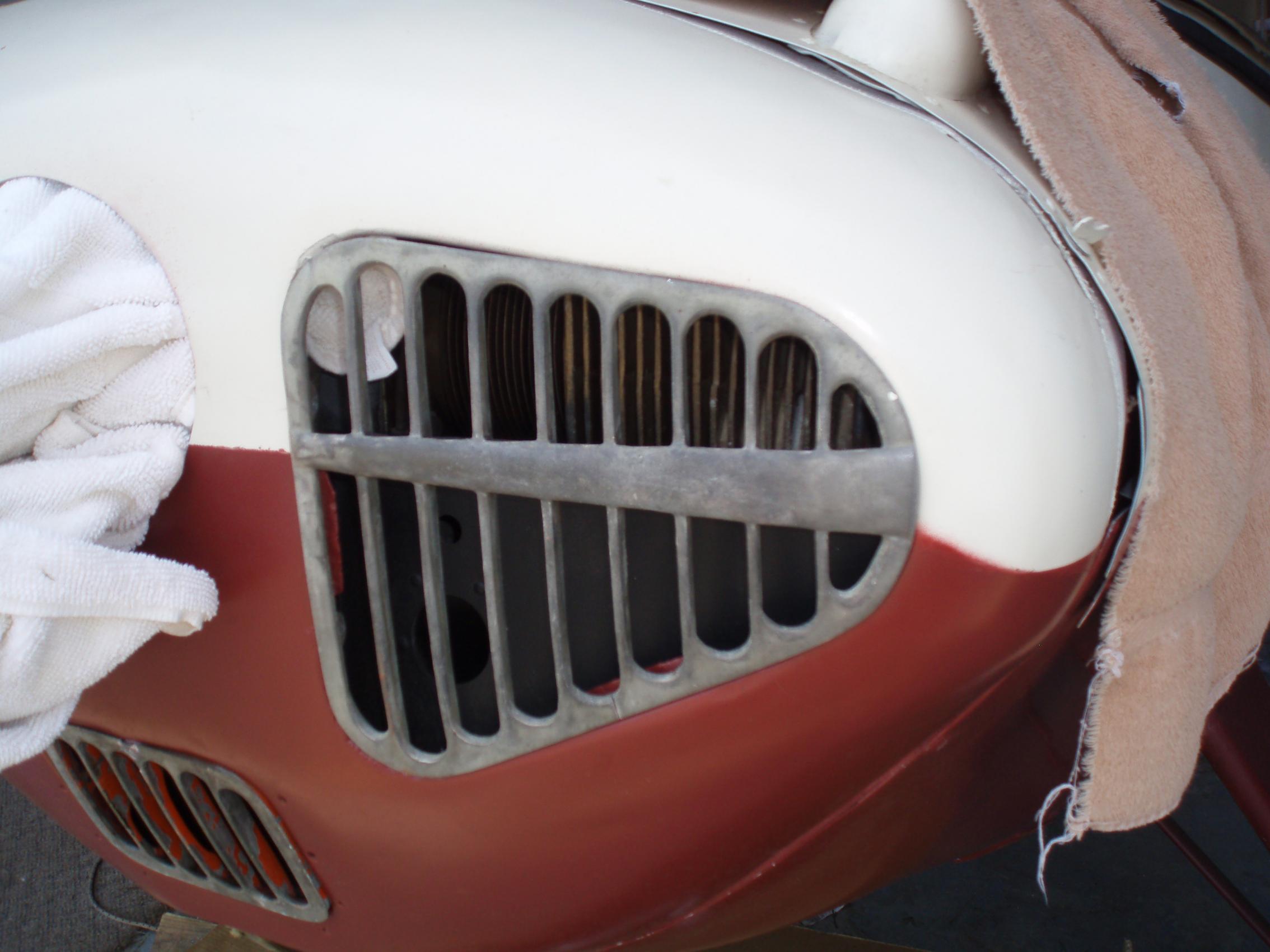

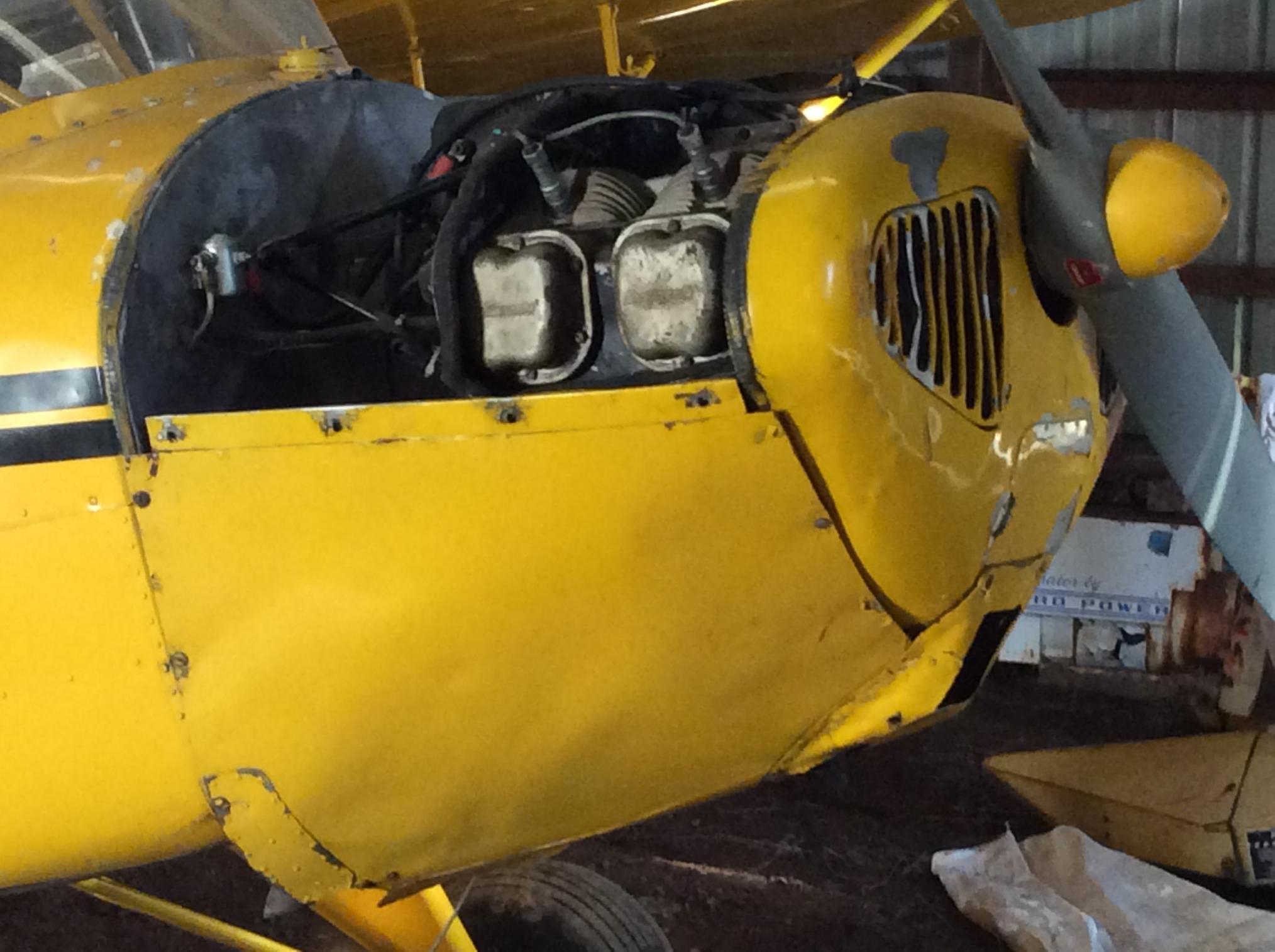

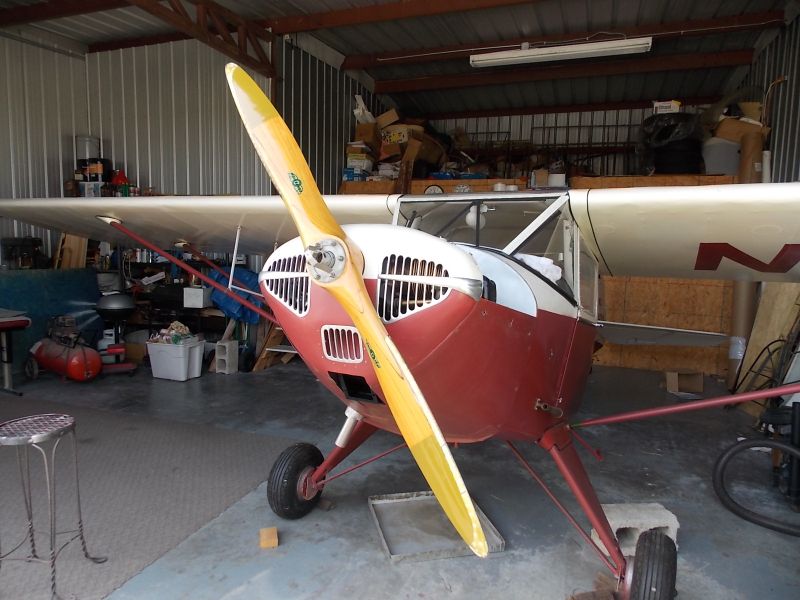

    Can anyone help me with some sources for cowling parts. I have an F-19 that I recently purchased. The nose bowl is rough but serviceable for a couple more years with some TLC. Upper sides are serviceable except for the cheeks. The bottom is a flat sheet brought together at the front with the part of the cowling that surrounds the airbox, that I am looking for a source for that as well as the cheeks. The nosebowl appers to be a BC12D that has the air intake blocked off and the lower part modified to meet the airbox of the 0-200...is that what they originally came with?
    I will post a picture or two shortly.
    Re: F-19 cowling repair
    Here are a couple pictures of what I have. Thanks in advance for any advise.

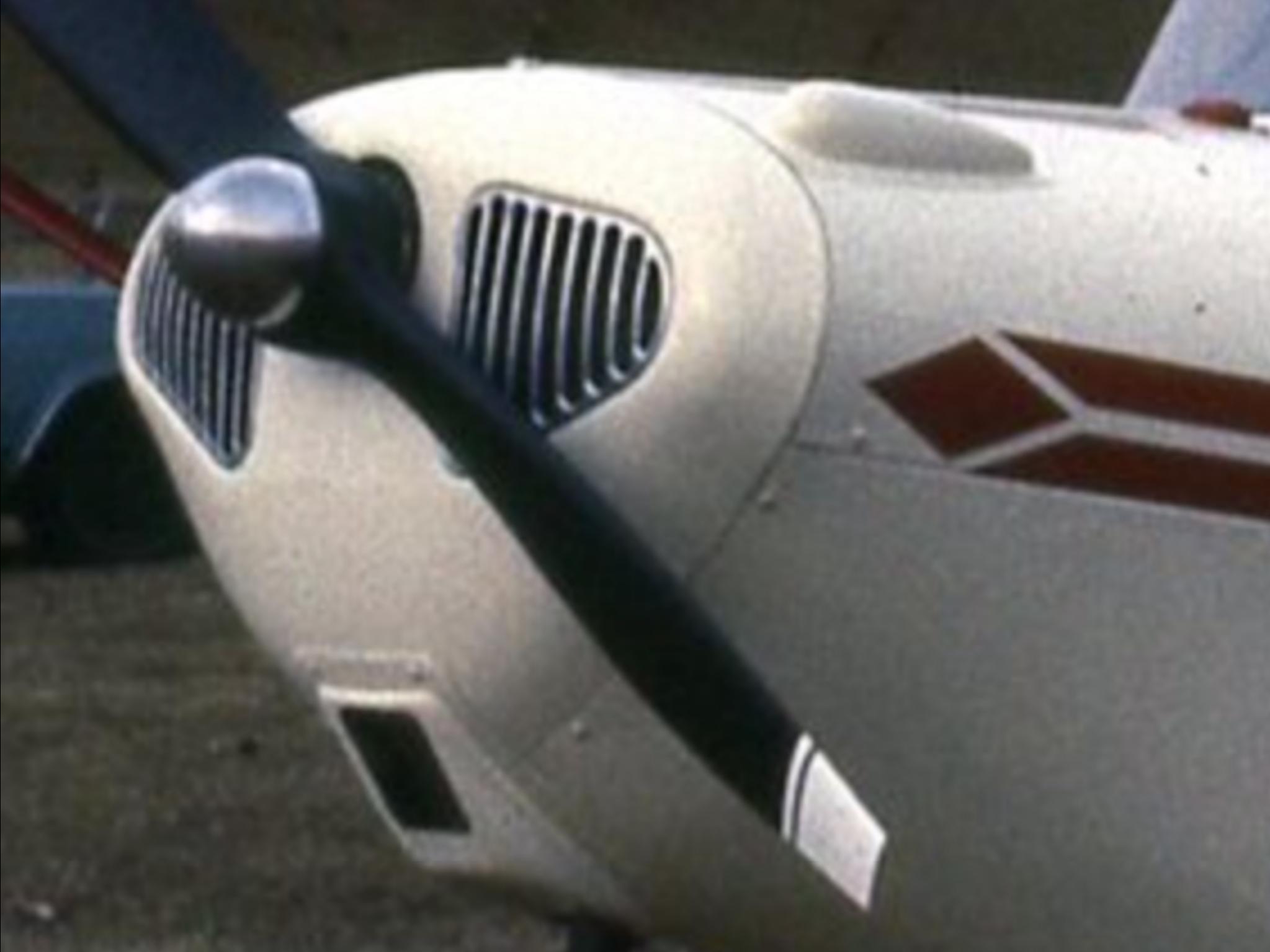

          Thanks for the suggestions. Univair only has B series parts for cowlings. I am looking for the part that is attached to the bottom cowl and the nose bowl of the F19, the air cleaner inlet hole and the "cheeks or bumps" on the top. I have a BC12D cowling right now with the air cleaner hole patched over. I would really like to find an F19 nose bowl but am not holding my breath for that one. I have attached an example of what I am looking for.
            There was a guy in St. Louis that was making those but I believe David makes those, too. Give him a call, he is a really nice guy to deal with.

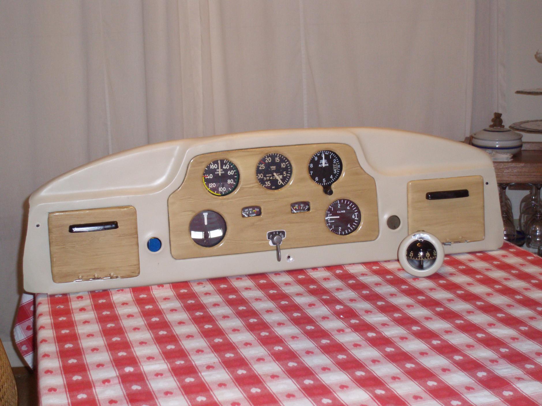

                            If you can't find a good metal worker you "can" make it yourself. I made my instrument panel with just a plastic mallet and shot bag and repaired a nose bowl when everyone who saw it said it was pure junk after a nose over that left cylinder cooling fin impressions all over it. The nose bowl on my 41 was all hand bumped back into shape and has less than a teaspoon of filler on it. It CAN be done and does NOT take talent, just an abundance of patience and a willingness to throw a LOT of aluminum practice parts away.

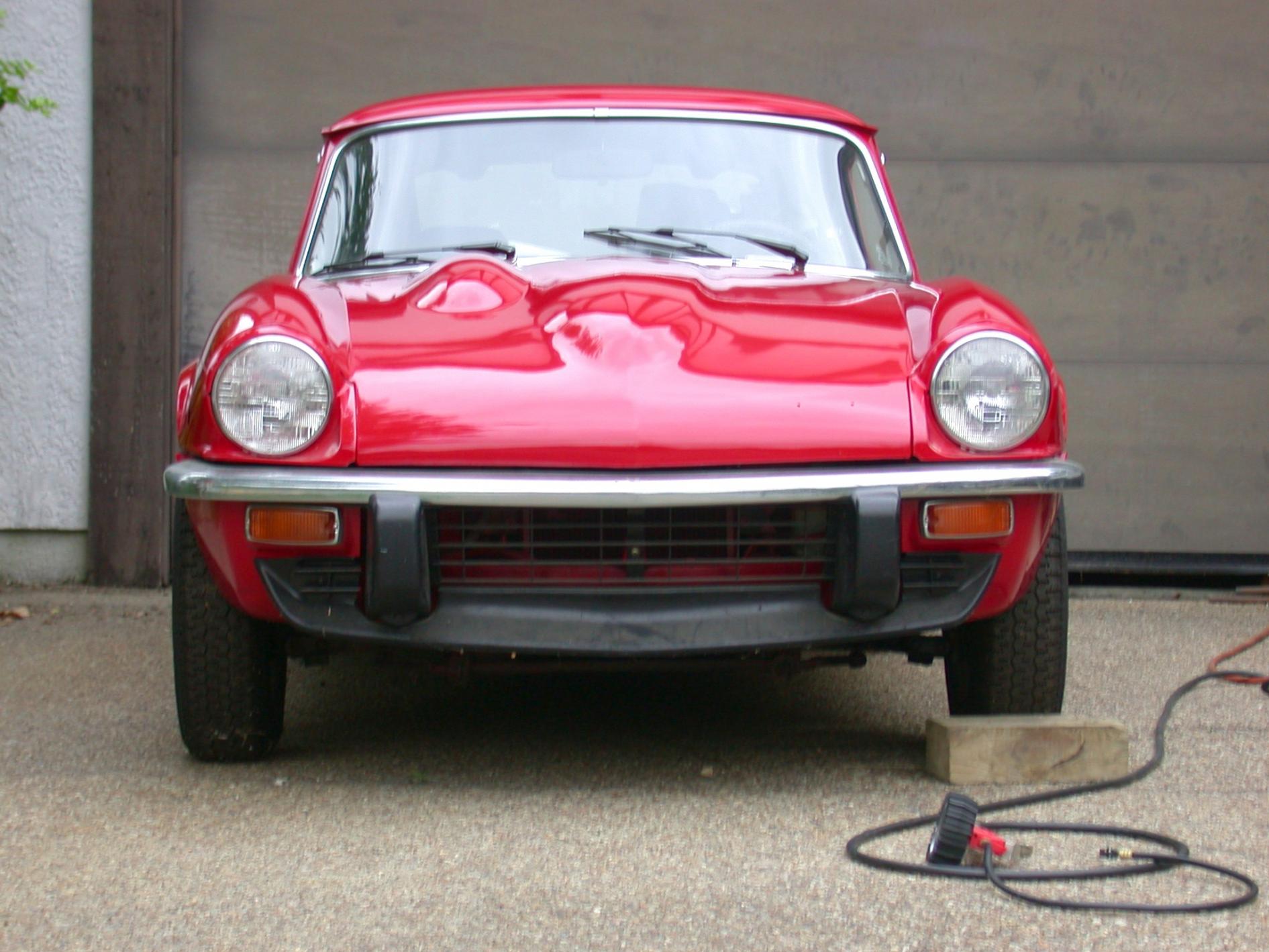

                              Just as a side, this is the car I rebuilt. It is a 1971 GT-6Mk III LOTS of body work! Wish the engine worked. ;-)
