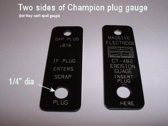

      We use unshielded plugs, but the principle is the same: use the plug manufacturer's recommendation, which in the case of Champion, is their plug gauge (see picture). Our plugs last about 500 hours before replacement. 100LL used exclusively on A65-8.
        It is critical to properly rotate the plugs to ensure longest life. If you're getting less than about 400 hours, you're doing something wrong. When you rotate the plugs, make sure you are reversing the firing polarity. This is more important than going from top to bottom. The easiest way to remember is to move each plug froward one cylinder in the firing order. Clean and gap the plugs then check them with the mentioned gauge. If they don't fit in the hole, they're good to go, regardless of what your IA may tell you.
