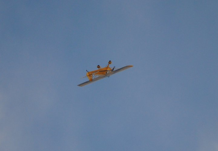

                            Loving getting ready for IAC season. . . . . looks like 4 days in a row of good flying!

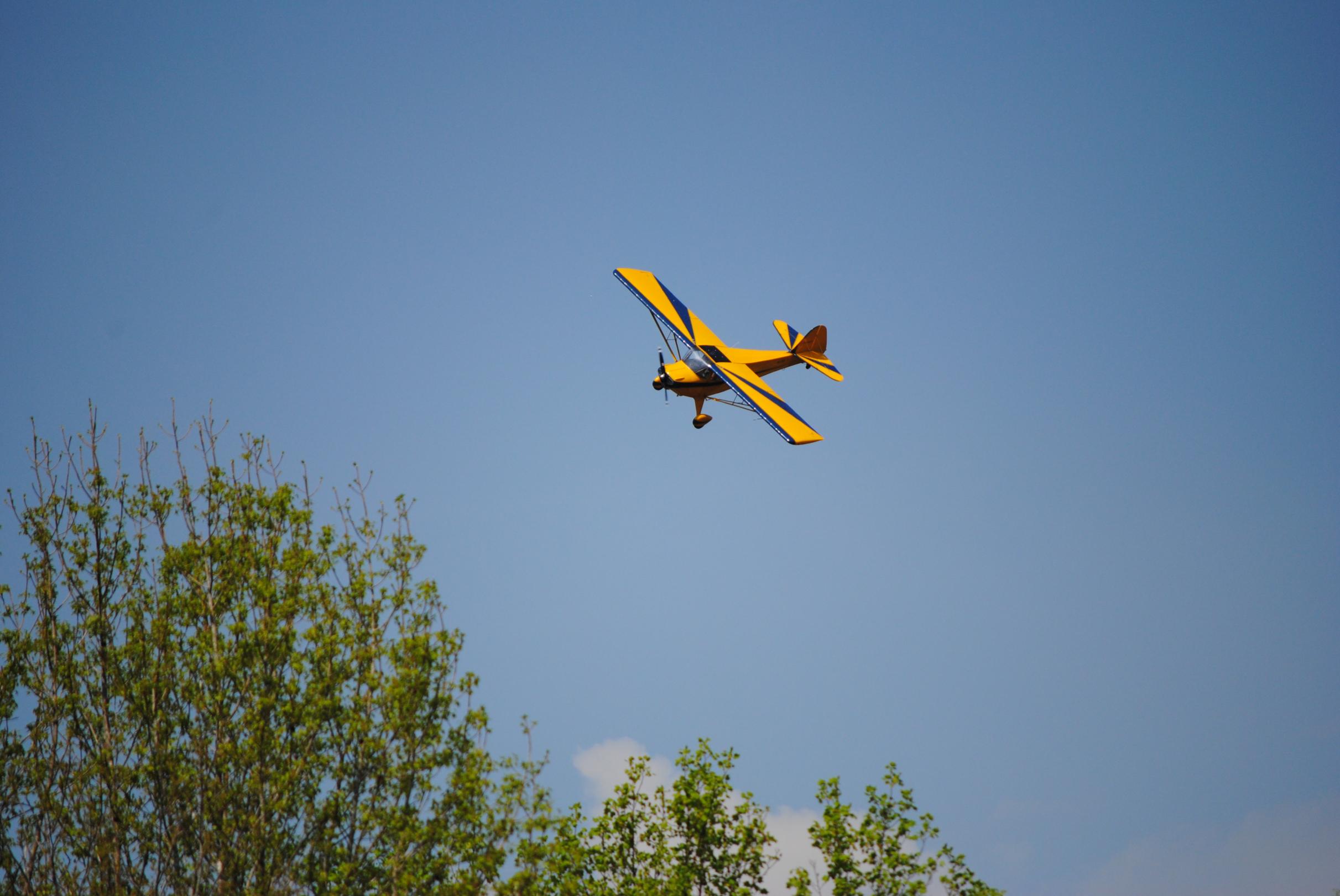

                                More time getting ready for the contest, got the 74-41 McCauley back from the prop shop. The overhauled it and balanced it. It is the perfect combination for an O-200 powered clipwing. Way better climb than anything else and at least as fast on top end. I am getting 115-120 mph flat out at 2750 rpm. If I were to advance my timing to 28 degrees and add the higher compression pistons I'm sure it would turn it 2850 or more. Loops from level flight are easy as are rolls etc.
