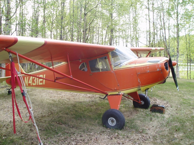

    Rolled out of the factory in January, 1946. NC-43121; BC-12D; SN 6780; A-65 continental engine.
    Test flown by Al Barber.
    Sold to a dealer in Los Angeles
    Went through 14 owners, all in Oregon, from 1946 through 1982; minor damage history.
    I purchased in Oregon in 1982 and flew her to Alaska. My first airplane.

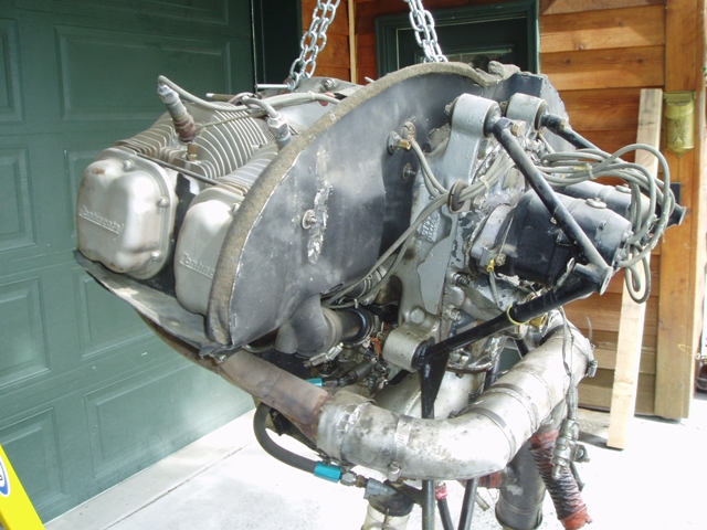

    I put about 1,000 hours on her from 1982 through 2004. During that time a few “mods” were completed:
    o Removed wheel pants and installed 8.50s
    o Removed original taylorcraft “hockey puck” tailwheel and installed Maule tailwheel
    o Removed headliner and the “sling” baggage compartment – installed extended baggage
    o Removed Continental A-65 and did the Gilberti STC to install a C-85 engine (no electrics)
    o Removed original landing gear and installed F-19 landing gear – with ski brace / strengthening
    o Removed cable brakes and Shinn wheels, installed Cleveland wheels and hydraulic brakes
    o Rebuilt and recovered both wings after major wind storm and wing damage, including broken spar.

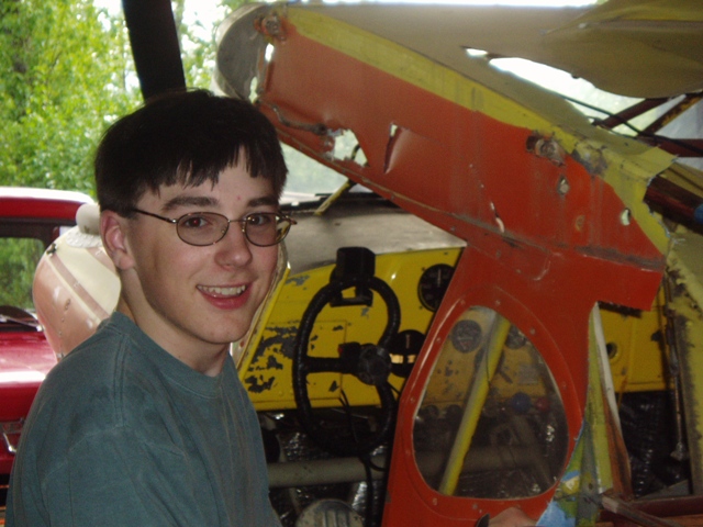

    Decided in 2004 that it was time to take on a total rebuild / recover, including wings again.
    Tear-down in 2004 and then into the garage.

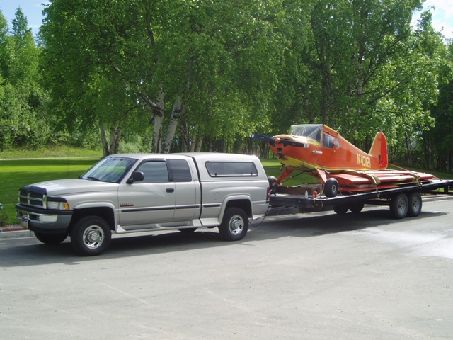

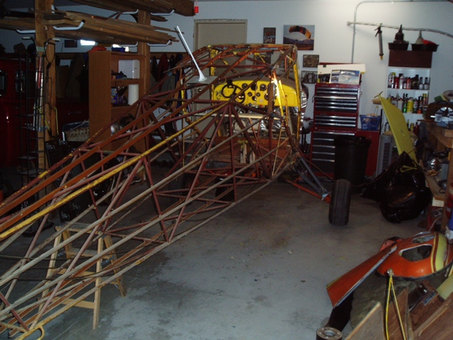

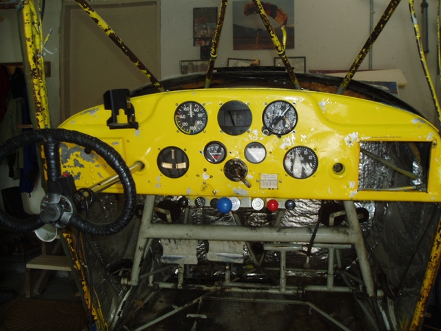

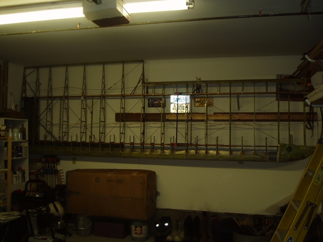

    Posting #2 - Six Years of Very Slow Progress
    The old bird became a "garage queen" and I made some minor progress. Tear-down; minor fuselage repairs & painting; new cables installed; minor rebuild work. Then moved from Valdez, Alaska back to Wasilla ... she went from one garage to another ... and sat.

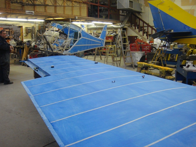

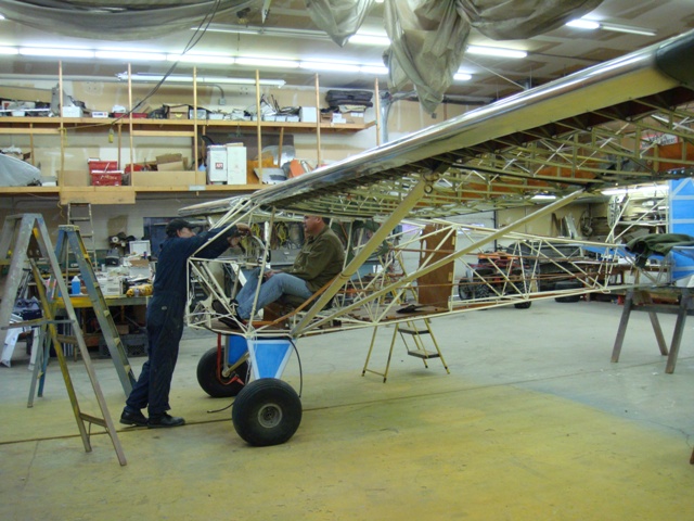

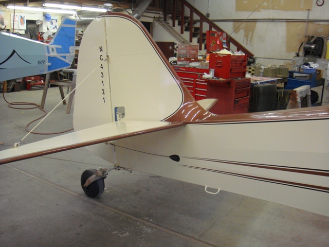

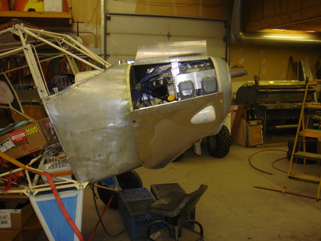

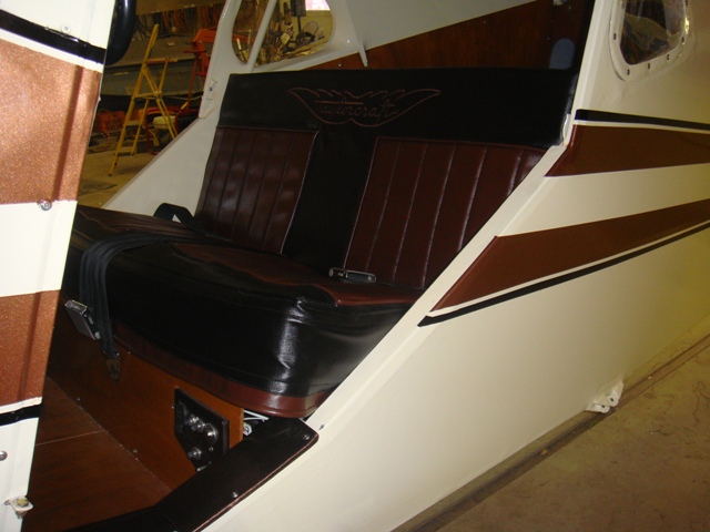

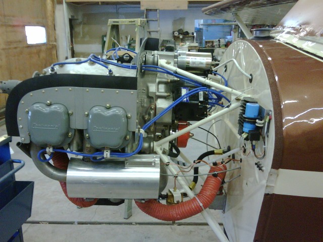

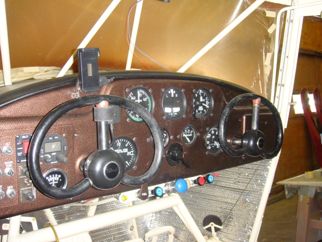

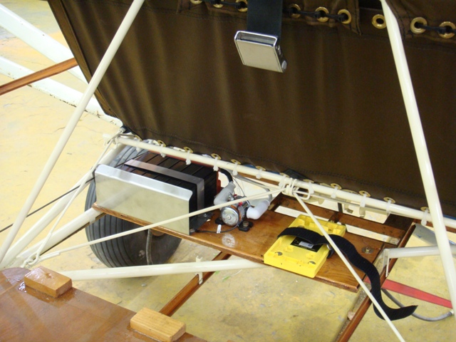

      Posting #3 - June 2010 to May 2011 - Complete Rebuild at Crosswinds STOL
      After 6 years in the garage, at the rate I was going, this project wasn't going to get done in my lifetime. Rather than making my son wait for an inheritance, I finally decided that I needed to get some serious help and get it done. Charly Center of Crosswinds STOL is my brother-in-law (I married wisely) and a renowned aircraft mechanic specializing in tube-and-fabric aircraft. He has a number of STC modifications (mostly for cubs), but works on a variety of aircraft. In fact he just put a set of floats on an RV-9! He owns a tcraft himself. He and his right hand guy, Mike, took over the project and things came together:
      - Installed skylight
      - Installed zero time C-85 with electrics, new C-150 style exhaust, and new Sensenich 76AK-2-38 prop
      - New cowling to fit long mount and new engine installation
      - New electrics (battery, radio, intercom, nav lights, alternator, GPS, ELT)
      - New struts
      - New shoes … 29-inch Airstreaks by Alaska Bushwheel and “Baby-Bushwheel” tailwheel
      - New seats
      - New paint
      - Float fittings (but no floats … yet)
      And ... put the "C" back into the registration numbers.

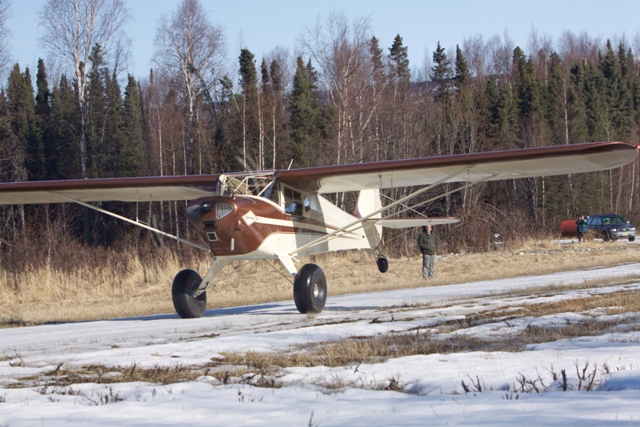

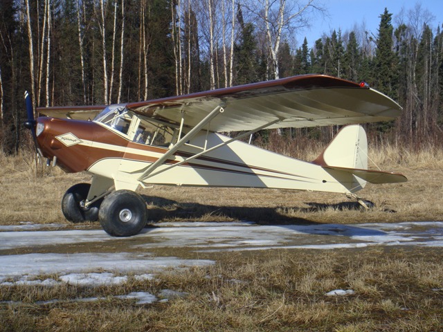

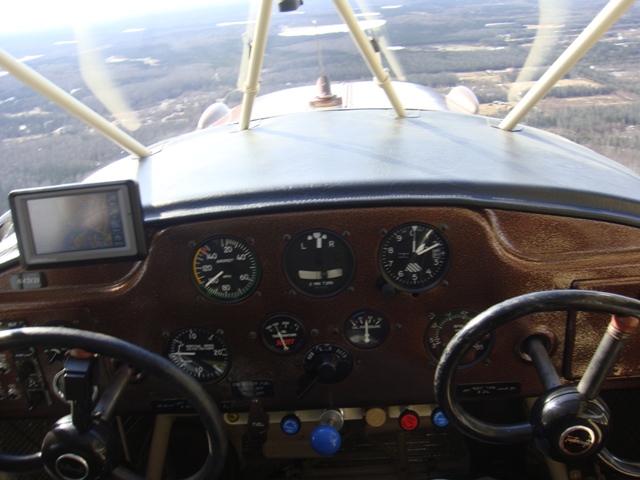

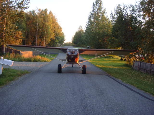

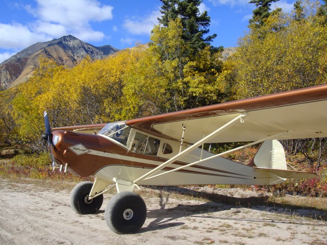

        Posting #4 - May, 2011 - Back in the Air!
        Final push-out, test run, maiden flight, engine break-in flight, and final adjustments to trim. Great to be back in the air again!
        Last edited by N-43121; 08-03-2012, 22:15. Reason: Removed those blue-sky cropped and rotated pictures of an alleged loop - which simply wouldn't be legal if it were true, right :)
          Re: Nc43121 - 1946 bc12d

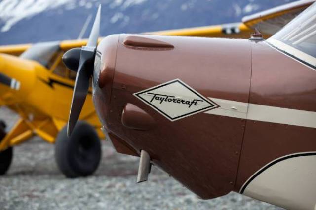

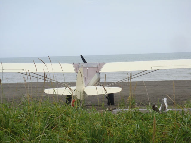

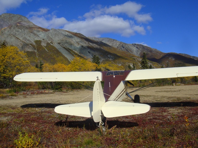

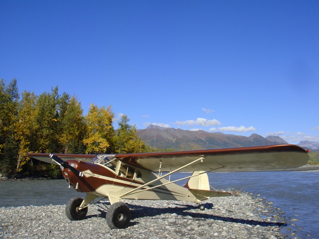

          Posting #5 - Summer 2011
          Had several fantastic flights this summer. From May through September put on 115 hours. Explored new areas, caught lots of salmon, went to some fly-ins, and generally converted avgas into noise ...

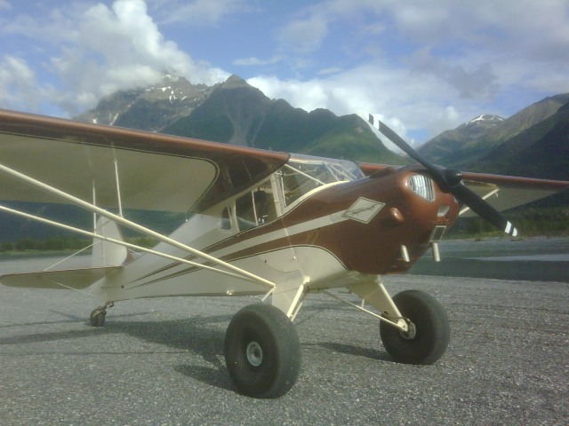

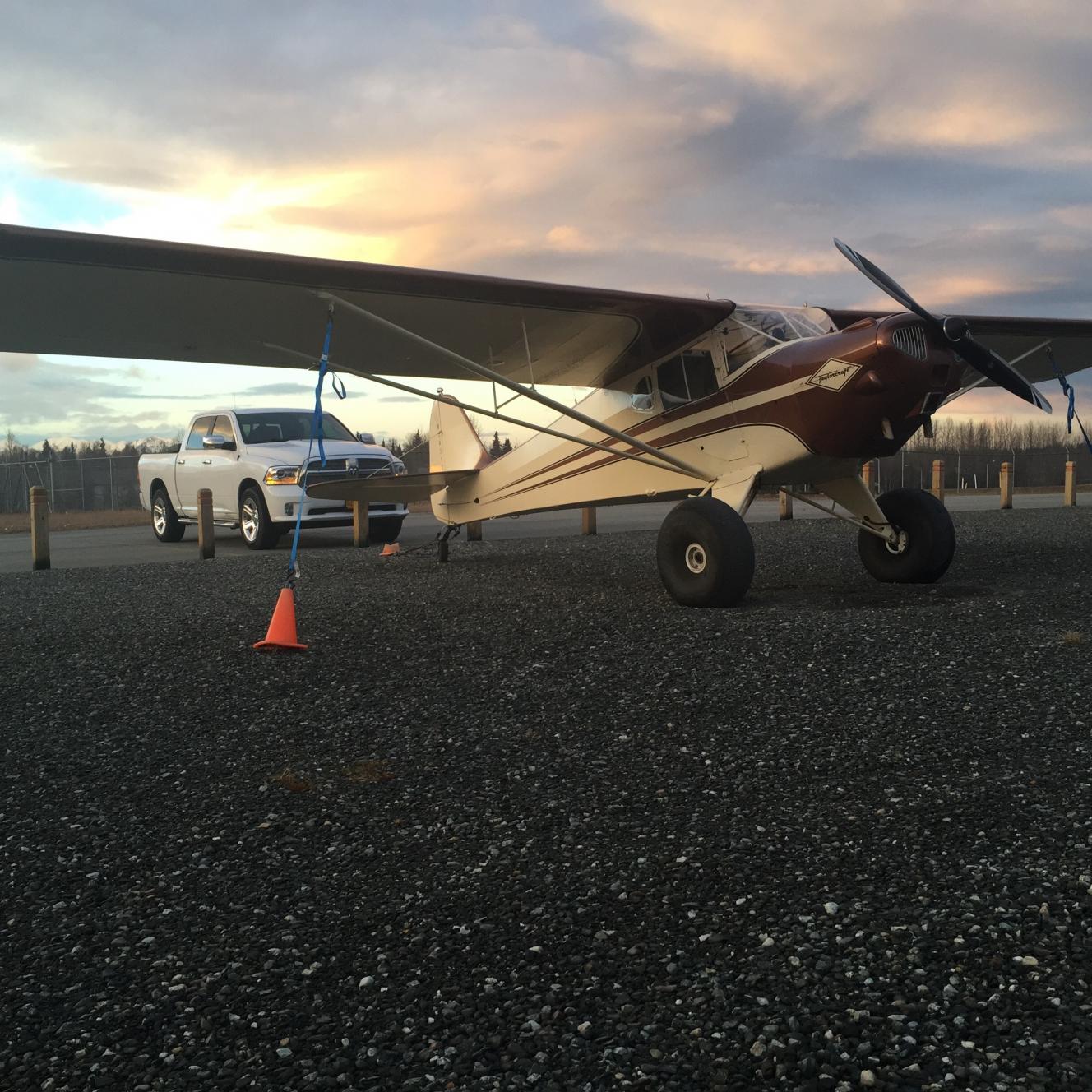

                      Posting #6 - April 2016
                      It's been 5 yrs since the "re-birth" of NC43121. She's doing well with 485 hours since rebuild. Now my daily commuter and my weekend access to the backcountry.
