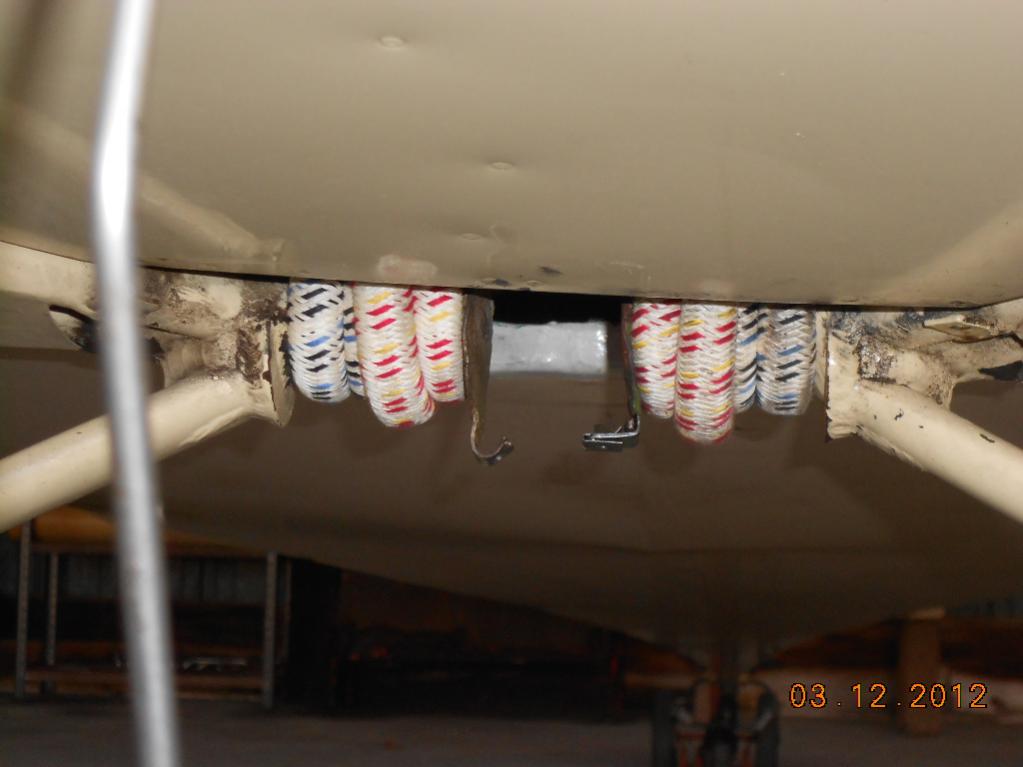

I would share your opinion mechanically, but defer to those more knowledgable. Here's a picture of mine, replaced just last weekend. Blues were on first, reds last. The bungee cover tab was bent in the process of "manipulating" the cords and restored to its original position after the picture was taken. The overlapped cords didn't change much (to become side by side) after 3 landings, but I presume will, in time.
