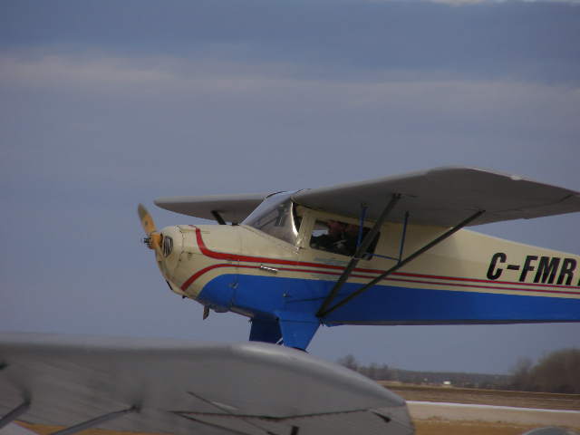

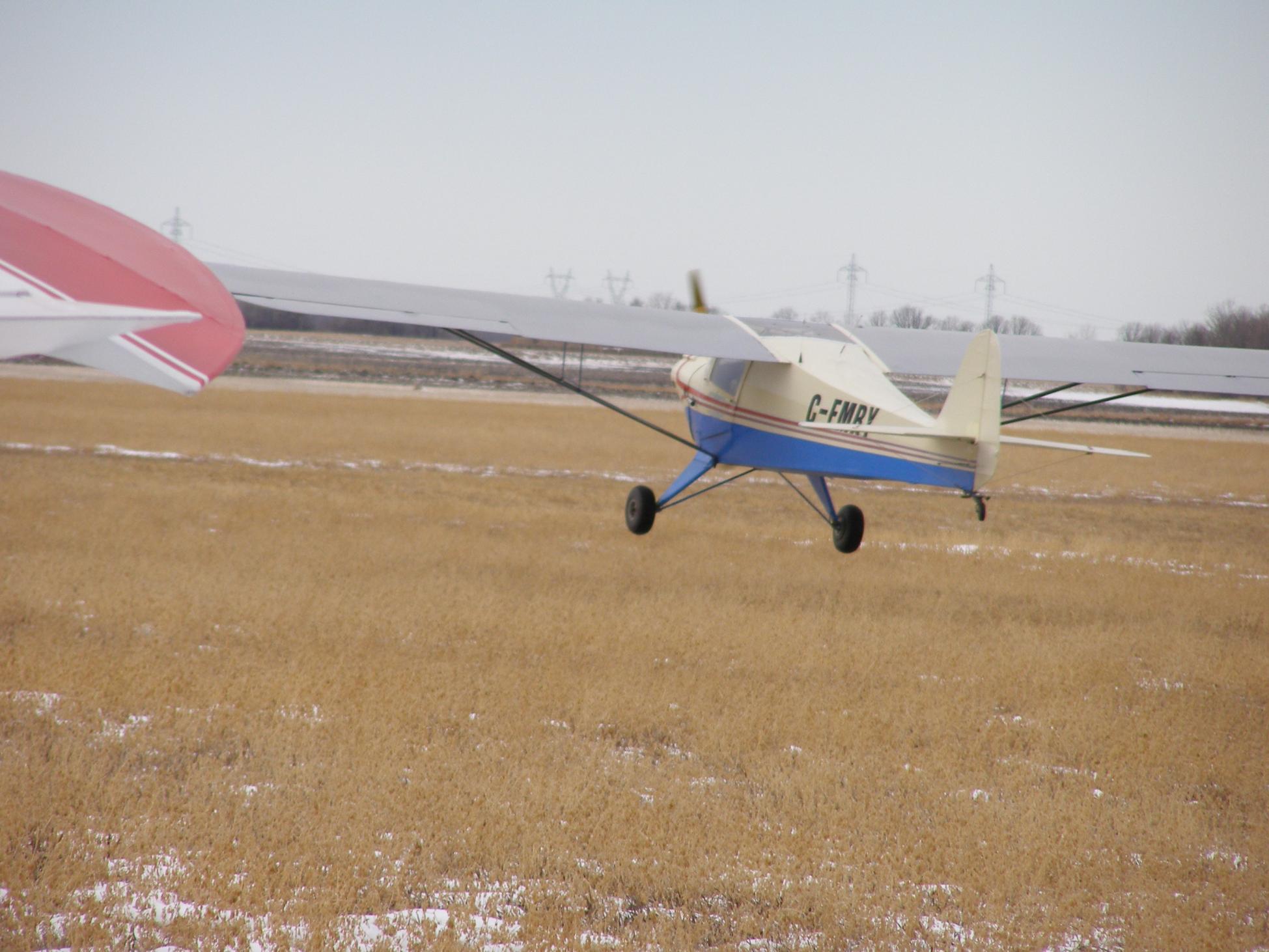

    After mounth an mounth of try to get my t-craft to fly straight,instead of banking left when you let go of the wheel,
    I took the engine off the plane,my ame came down,he check all the tube on engine mount,found bent tube on the left top,bottom tube,with little tapeing of rubber mallet,an put two washer on top,bottom of left engine mount,engine slid in esay,use to fight on left side to install engine bolts, then the test,ame took off,did couple fast,slow pass,landed,he siad it fly straight.
    He siad time to give you your check ride,in circuit,let go control,like im on auto pilot,did 4 stop/go an he bailed out,did my
    solo ride with my t-craft,for anoth 4 circuit,
