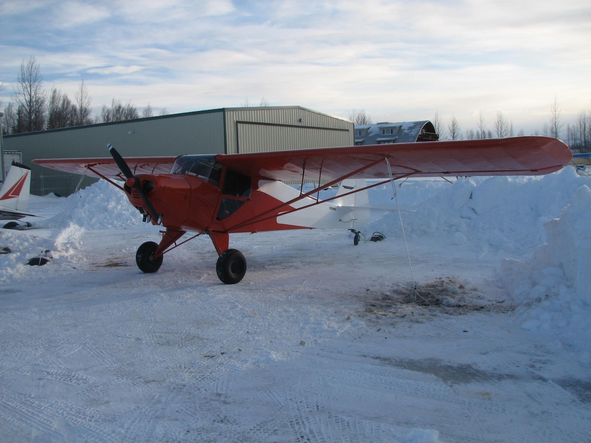

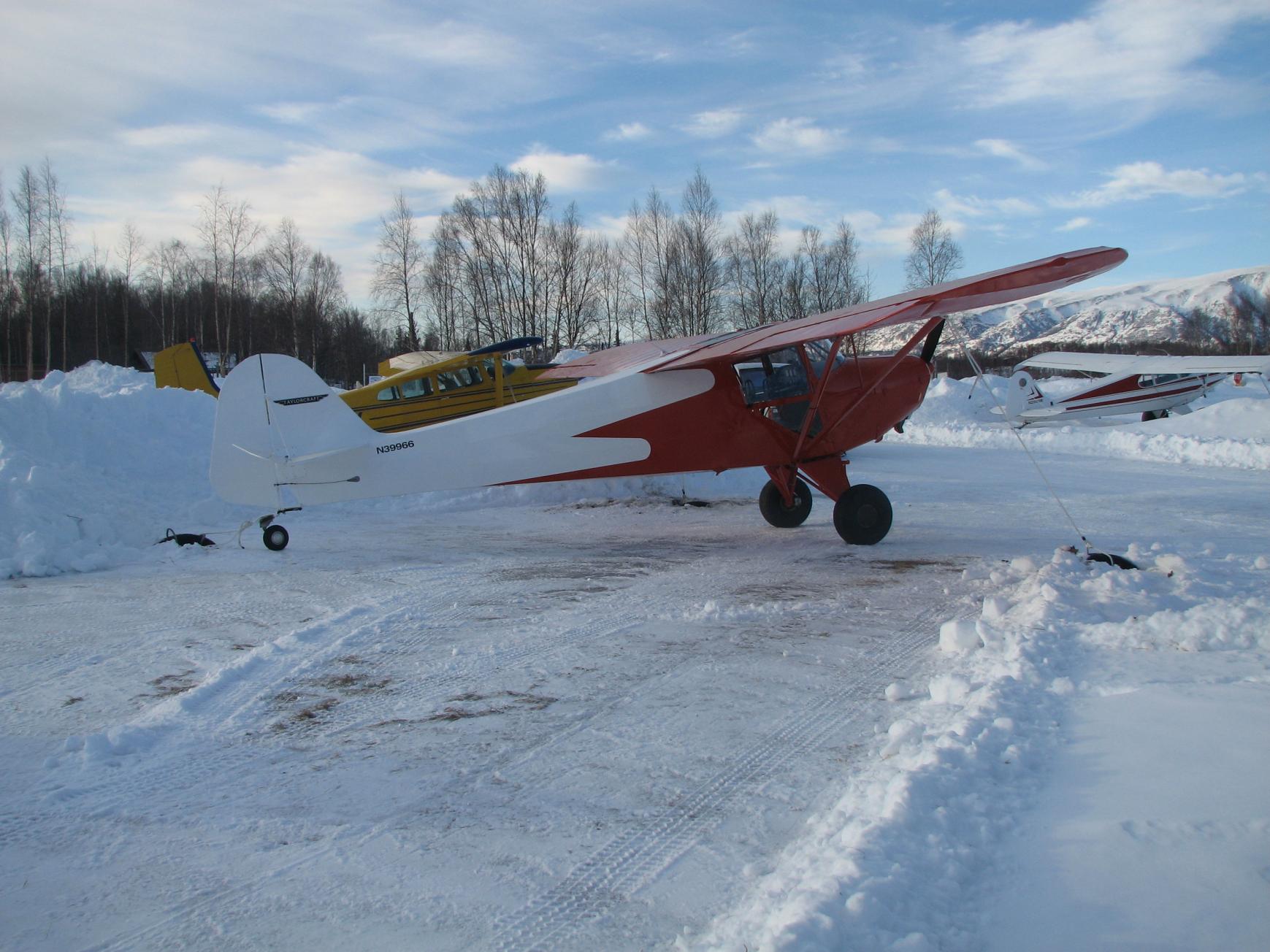

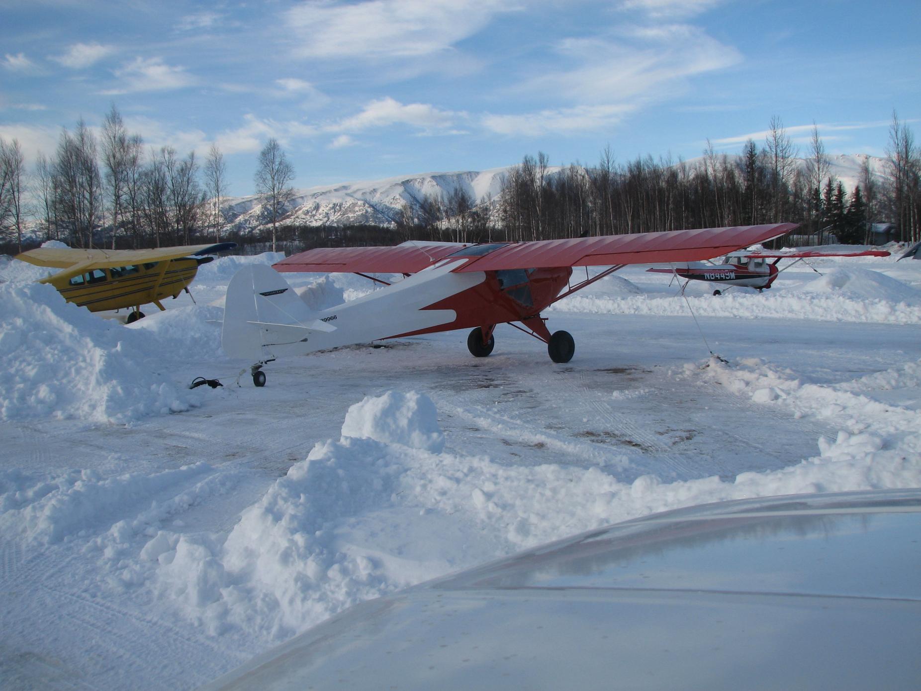

She looks better and is better than when I bought her ten years ago. I hope to go another ten years before a rebuild. She lives out side and the cover will be thirty years by then. We will see.

Thanks Marty! I considering parting her out and I am glad I did not. These old birds are becoming fewer and fewer.
The colors are Stitts Cruiser Orange and Insignia White. We painted the rear lemon yellow over white and I ended up sanding it off as It showed the paint spray patterns and all imperfections. A huge disappointment and it was unacceptable. Lemon yellow should only be used on a new substrate with no imperfections as it has low pigment making it transparent. I like the white better anyhow and so far everyone that saw it before and after prefers the white also.

Looks good!
Our '46 was last covered in 1971 with Irish linen and dope and it's still in excellent condition. Taken care of, covering will last a VERY long time.DJ Vegh

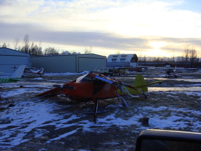

Jim, I finally got around to logging on the computer and looking for those pics. Here's a couple shots of your pretty bird when she wasn't quite so pretty ... after one of our infamous wind storms. Sure looks a lot better now.Originally posted by Jim Hartley View Post... Thanks Rod! Go ahead and post the pictures if you want to....
jim
Hope you are enjoying having her back in the air again.
