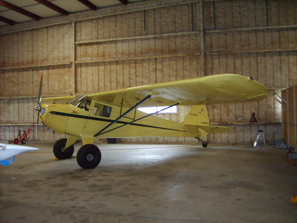

              my BL/BC-65 is 748 with disk brakes and bush wheels no fuel 4 qt oil

                Just curious is the 748 a calculated value or as weighed on a scale? Dave
                  Re: BC12-D Empty weight.....
                  On scale tail level with scale on all three wheels my plane has no upholstery jest nylon fabric seat sling wood floor no head liner 65hp no electric. In 1940 when it was new and had wood 83in prop and lycoming 0-145-a1 it was 654 lb on wheels and671 on herth skis at 1150 gw useful 496

                    What did they leave off at the factory to get it down to those amazingly light weights? I am not saying it can't be done, but to get a BC12D down to that weight would mean it would really be stripped down. I would be curious how someone got it down to that weight. I am lugging around an extra 150 pounds compared to that. I have a metal prop and a headliner. But the headliner probably doesn't add more than a pound or two. I know the metal prop adds about twenty pounds. I don't have wheel pant, so I must have cast iron spars. Hopefully we will have a west coast flyin this spring and I can take a look at your plane. I really like those tires.

                        Now that is a grate idea Marty i wish i had thought of it. Also when it was new it was a trainer one door tail skid no wing tanks and no brakes equals 654 lbs. and the pre war B models are lighter then post war.

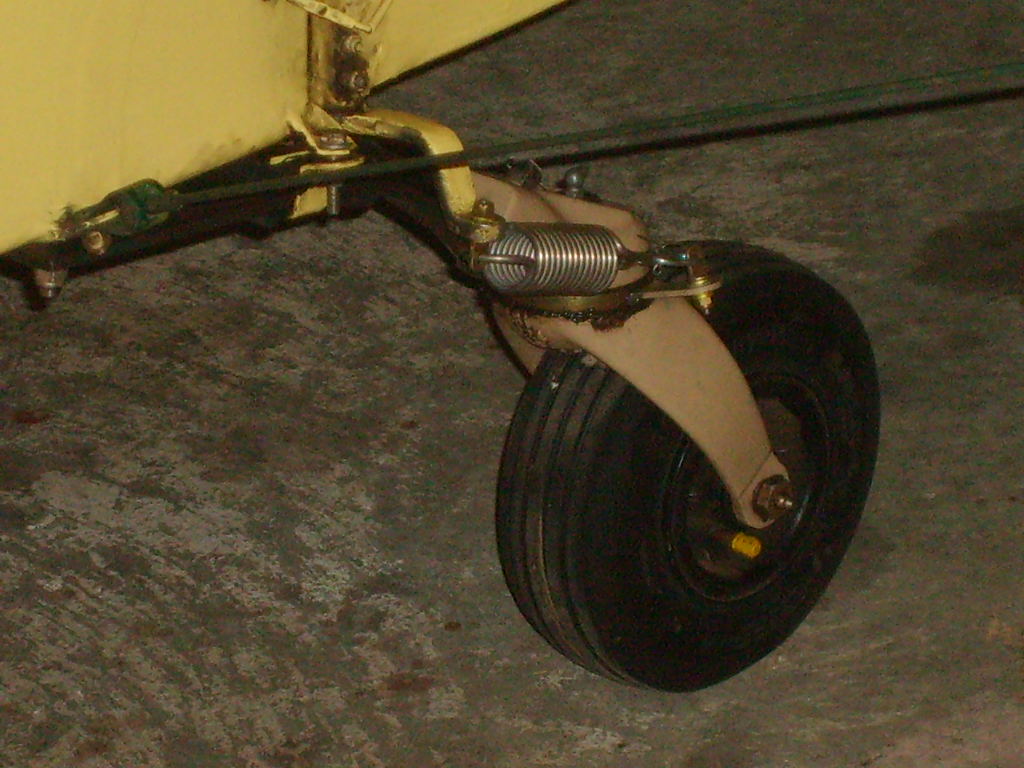

                          WOW!!! I bet that is fun to fly! I guess the tail skid acts as a psuedo brake when you let the tail down. Hmmm....if I only put on a couple of coats of silver, and paint it silver I could get the weight down even lower. Less weight = more fun. Hmmmm.....

                            It has alaska bush wheel 3200 tail wheel and 26/12.50/6 ak bush wheels and yes it is fun to fly the way it's set up
