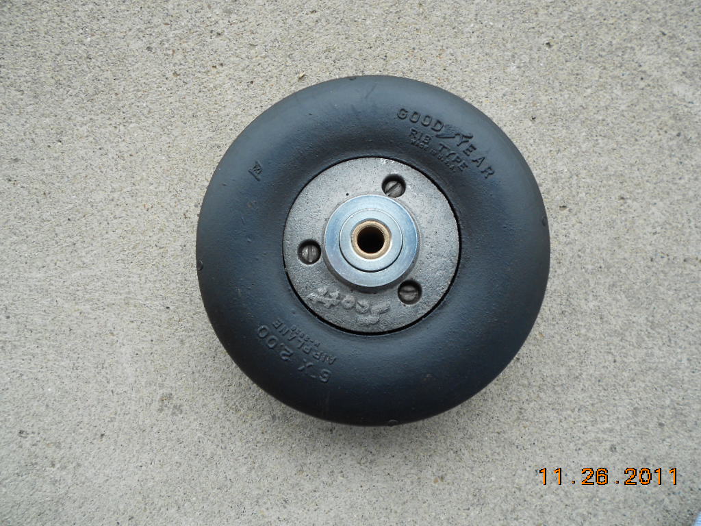

    I have a Lang tail wheel assembly with a Scott hub. Recently I changed the tire... a Goodyear 6x2.00 solid tire with a new Aero Classic 6x2.00 solid tire from Aircraft Spruce. Aircraft Spruce says that this is the replacement for the Goodyear tire. After 3 or 4 landings with the new tire I found the tire very loose on the hub. After removing the hub/tire... the hub screws were not loose.. I see that the new tire has 4 small knobs on the ID (which were partially worn down) while the Goodyear tire has 11 larger size knobs. These knobs are necessary to fit tightly to the Scott hub. It may be possible that I over tighten the axial mounting nut, but it seemed to turn ok when I tested it on installation.
    For now I'm using the old Goodyear tire... its a little worn but ok. I don't know if Goodyear still makes the tire... Desser & a/c Spruce don't carry them. I'm not happy with the new Aero Classic tire... is any one else having problems with this tire??

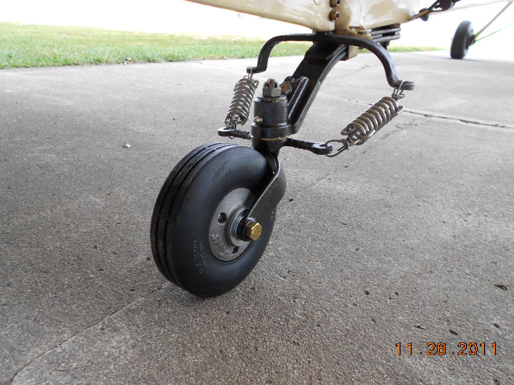

      N44305 has a Heath assembly with the Scott hub and 2 1/2 years ago I duplicated what you did - replaced a Goodyear with the Aero Classic from Aircraft Spruce. I noticed the tire was loose last weekend while cleaning mud accumulated by skillfully landing in the only soft spot on 2400' of turf. Anyway, it also is apparent that the wear isn't completely even, as if the camber needs adjusting. The leaf spring is straight and tight, but the bearings are moderately loose, both in the hub and on the fork. So I attributed the tire wear/looseness to the worn bearings and will replace them ASAP. Now that I know about the knobs too, I hope we can both find a better replacement tire.

                        Brown Bearings wasn't able to provide the F-350-14, and locally I could have ordered the -12 with 1/2" bore, but getting a thin walled sleeve didn't pan out. Instead we replaced the worn bearings with the -13s (5/8" bore) and used SYMCO SS-1420-20 sintered bushings to reduce for the 7/16" axle. Pix attached.
                        Mike V.
