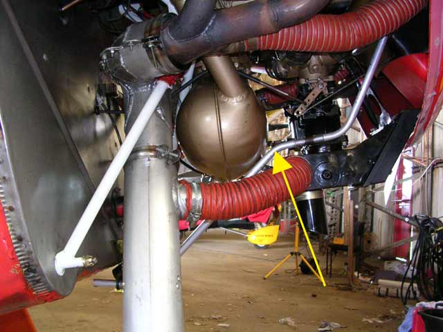

    My Taylorcraft used to have an A65 engine, and was prone to throwing oil through the oil breather. Now that I have upgraded to a C85, I expected that oil consumption would be less but I still find that the engine looses most of its oil through the breather.
    I discussed this briefly with Forest and he has advised that this is probably due to the end of the breather tube being in a low pressure area. The effect of this is to suck oil out through the breather.
    One suggested cure is to put a 'whistle hole' in the breather tube to relieve the pressure so that less oil is sucked out. The question is where?
    The attached photo shows the routing in the oil breather. Any suggestions on location and size of the hole.

          Had a 'whistle hole' in my C90 equippec Cessna 140A. It seemed to keep the blown out oil to a minimum. My hole was cut about halfway between your suggested spot and where the vent came out the engine.

              Thanks for the replys out there. I will add a whistle hole this weekend mid way between the oil brether outlet and the arrow on the picture. I should be able to determine fairly quickly if this has had an effect on the oil consumption, especially as I have just done a 25 hr oil change on the engine.
              If this doesn't help then I will investigate the Continental mod.
