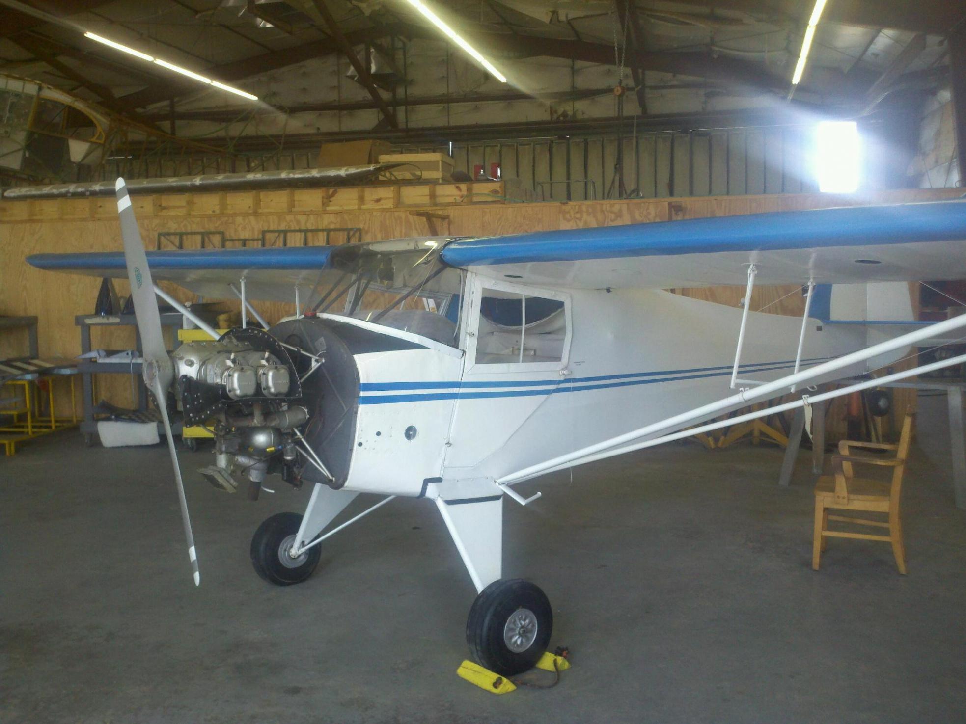

    N 399991 is almost ready to fly again after two years of slow and painful ($) work. Estimate to have her ready by the 4th of July week end for her first test flight. Then work on the details, aileron rigging, etc...:dance:

        PIA did a great job restoring this ship. The sad part of the story is that when the restoration was completed, it sat unattended ( wings were removed and engine pickled due to the owner's illness) until about two or three years ago when a fellow from WV bought it and flew it a few times. So actually, this ship has sat since restoration. Over these years it developed some rust around the tailwheel area that required attention ( sat with the tailwheel on the ground and we assume that water may have condensated or...? into that lower spot), as well as new wing root covers, aileron and wings rigging ( flew sideways with the tail wanting to come around from the left( Big ?)), unfreeze pulleys (two were replaced, two or three more might also), unfreeze the trim system (still working on it), engine inspection ( 75 HP upgrade at overhaul: 10 hrs SMOH, starts on the first pull. Case Mags, metal cruise prop), repack bearings, get the breaks working again and other items that require attention before it's ready to fly again. Has fabric doors that need some work in order to close and keep a tight fit. The fabric is in like new condition as well as the wood ...very well varnished and NO living creatures nor evidence of them was found either!!. So nothing to worry about, just the usual maintenance that these planes may require when left unattended over time. It has new sealed struts, new tires and a rebuilt cowel painted with a different white color than the insignia white on the rest of the plane...this may have to wait.
        If we dont make the 4th of July date, it will be sometime in late August-early Sept when she may go up. other than the above, we think that she will be a good ship for many years to come.

          Test flight last week end went well but still needs some rigging of the wings. Ailerons are flush with the wings...no droops...just straight. Something does not feel right with the wings...holding rudder and aileron at times...then adjust the wing struts and is too much... or too little or the wrong direction= got worse...quite a job to get it right!!!. At this point, I take any suggestions that the tribe may have on rigging the wings...pointers or any other help. I'm ready to start the whole process again from scratch.
          The engine has a knock ...A&P-IA said that might be a stuck valve in one of the cylinders. Added MMO to the oil and fuel...he claims that it may get it loose. We'll see.
          Other than that, it flies great. What a nice feeling to be back in the air.
