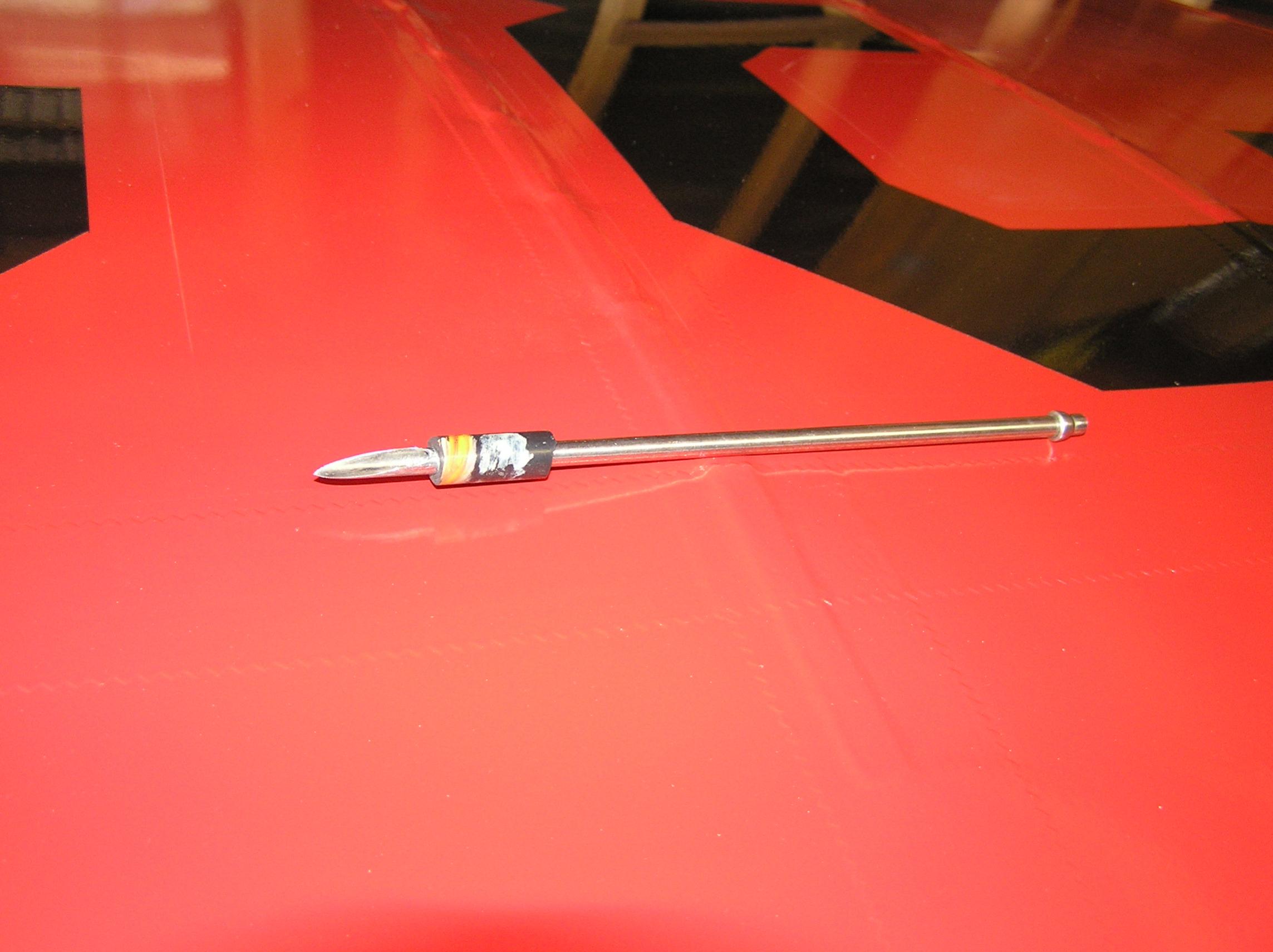

                          Another way to cut drain holes. This is a copy of a tool the military used that works well. It's just a piece of 1/4" tubing cut tapering to a point and sharpened. Glue the grommets (metal seems to work best as opposed to plastic) with Poly Tac and install reinforcing patches, -push the tool in and turn using the edges of the grommets as a guide-either before the finial paint coats works well to finish the hole edges or tough then up if cut after.I put a piece of 1/4" fuel line for a safety stop. I haven't tried a soldering iron but this makes a neat hole and only takes long enough to push the tool in to cut a hole. One thing that makes a difference in how well it works is to keep the cutting edges sharp.

                            Re: Wing grommets
                            Hi Buell, my Dad had one in his fabric covering tool box, I still have it too! He had a bigger wooden handle on it.

                              Hi Forrest,
                              My Uncle that passed away a few years ago built and restored wood boats and made that and several tools when he helped me with some things for my Taylorcraft when I restored it from remembering tools he used working for the Air Force -He had a house and boat shop on the Guadalupe River -sure miss going out there-working in that shop-cooking fahitas @ chapupies, @ drinking a Shinner Bock in the evenings by that river.
