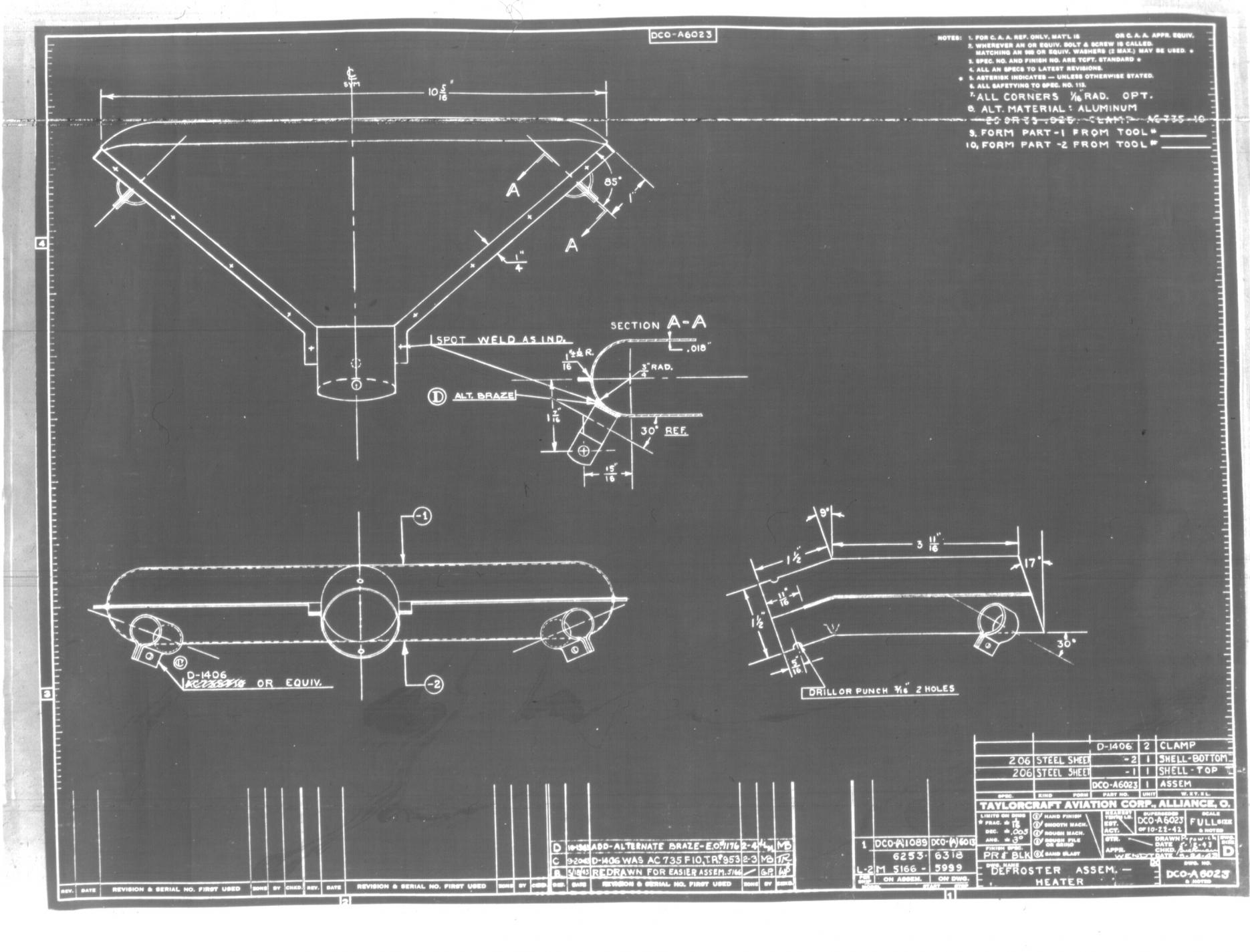

    Does anyone's Tcraft have a defroster similar to the Taylorcraft print below? The firewall on my F-19 was pretty much smashed and I did not see this part in my boxes of parts.

    F-19 used heat up around the tubes. That print is for the DCO or tandem ship;

      Thanks Forrest.
