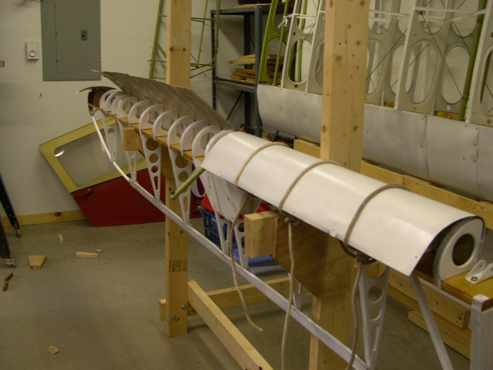

        Here's a couple pictures of my aileron rebuild.
        The first shows the leading edge being installed, I used rope to gradually bend the leading edge around the nose ribs. The parts are primed with polyfiber's white epoxy primer, the spar is finished with epoxy varnish.
        The second photo shows a nut plate behind the hinge fitting. The nut plate allows tightening the hinge bolts from the front side and it is less likely to crush the spar.

          Bob has some good pictures. You need a stiff fixture to hold the spar straight untill the leading edge is attached.
