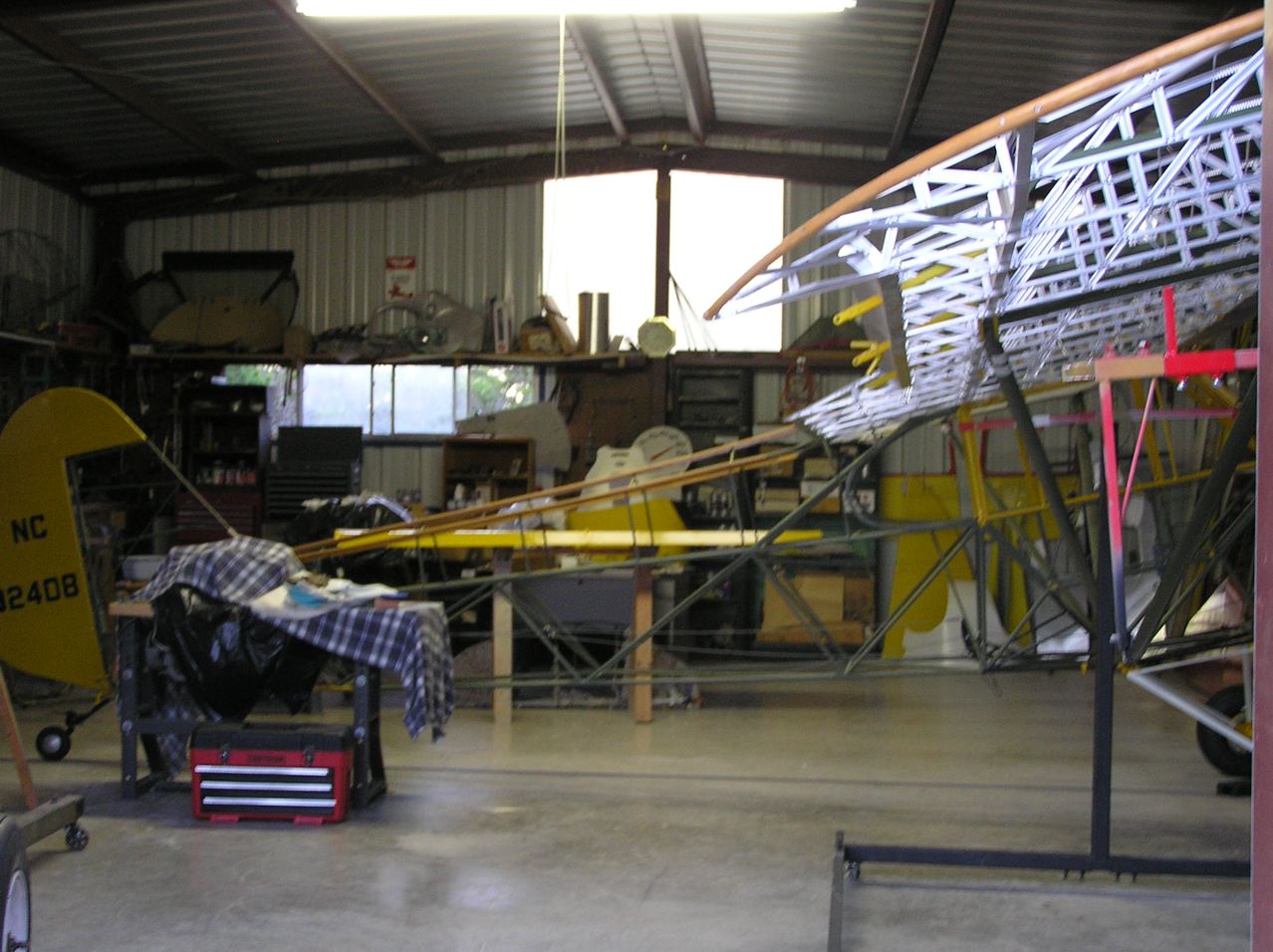

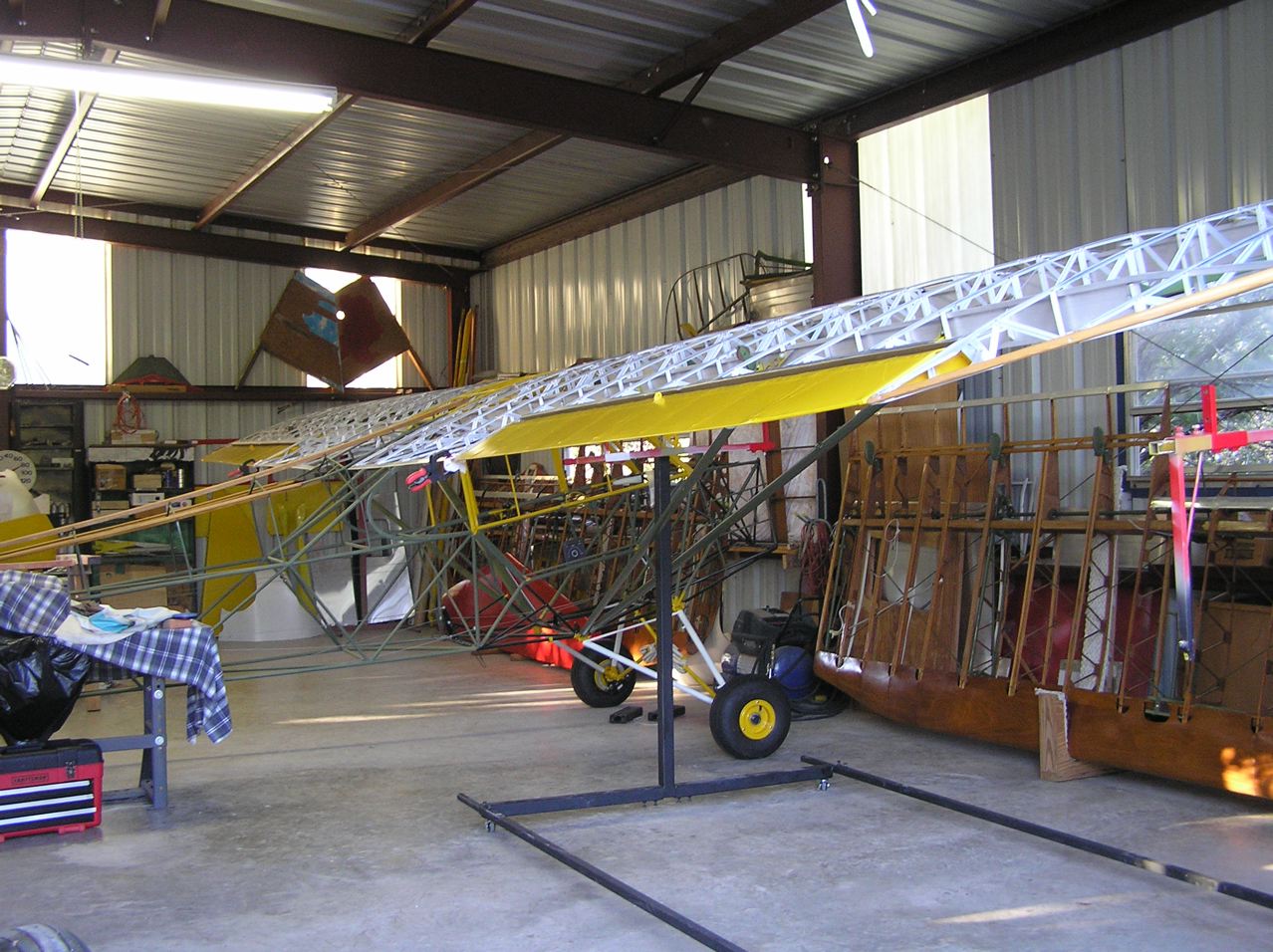

I made these a while back. I just used the top pivot from some wing stands I had and made some bases that would extend long enough to raise the wings to reach where they need to be and welded some tubing that 10' extensions would slide over to connect them to make them extend long enough. To lock the pieces that slide over I used 5/16 bolts and then bought some rollers from Tractor Supply--when you just use the ends for stands to work on wing then turn the tubing which has the rollers upside down. You do need 2 people to lift them onto the stands but you can lower and tilt them and place the arms behind the spars to keep them in place while you tilt it back which makes it pretty easy. All you have to do is roll it in position,raise it where it needs to be,tilt it to match the fittings and install the bolts. After you have the wing secured and the struts in place then slide the verticals down and lift them off to clear the struts so you can roll it out of the way. It turned out to be a lot better than several people trying to hold the wings in position. I haven't used it on a Taylorcraft yet but I have installed and taken wings off on a Fairchild 24 and Cub by myself and it should work. You can take the connect parts off and use it for wing stands for working on wings and it comes apart easy to store the pieces out of the way. The next thing I need to do --when I am ready to install some wings that have the fabric is make some bases with padding but that should be pretty easy. Sorry I have it apart for now and these are the only pictures I have but if anyone wants I take some better ones when I final assemble the Cub or Fairchild- with the bases for installing the wings with fabric.
BuellLast edited by Buell Powell; 08-05-2010, 04:11.Buell Powell TF#476

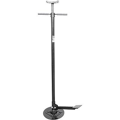

This is what I used. Bought at a local tool store for $89.00. It has a screw adjusting height and also has a foot pedal for adjusting when you need to raise a little to make it fit. I attached a padded 2x4 to the top for wing support.Attached FilesTom Peters
1943 L2-B N616TP
