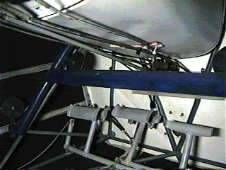

      I flew short pilots in the left seat for several years with these pedal extensions. Each new pedal face has pieces of threaded rod welded on the back and then attached to the original pedal with a saddle clamp. It worked very well and always stayed in place.
      If I can still find where I have the pedal extensions maybe I can shoot a better photo; however, I posted this solution a few years ago so it may be in the archive. I found these to be safe and effective.
