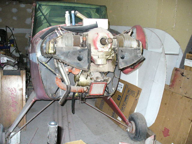

    Hello tribe, I have a buyer for the project plane I was selling coming down from Quebec in a couple weeks to pick it up, sold through ebay, and he's put a large deposit down via Paypal.
    Is the US form 2120-0042 Aircraft Bill of Sale sufficient along with copies of the ebay listing and sale info, or do I need to provide him some kind of Canadian government form(s) as well?
    Anyone got any experience out there doing this?
    The plane I'm selling him is currently US reg'd, but non-flying, so it will be going back on a trailer.
    Tks.
