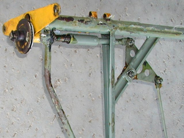

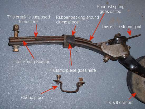

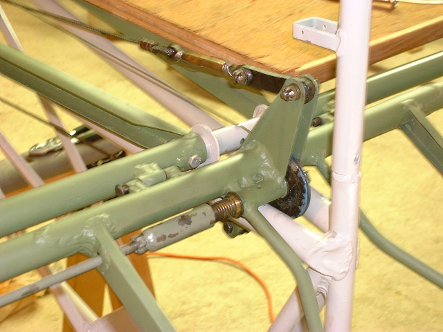

            Here are some photos I have collected over the years that may help some owners understand what to look for, or why it needs looking at on an annual. These are all from a BC12D.
